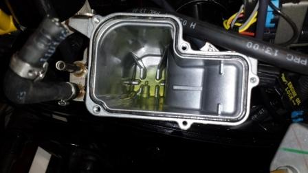

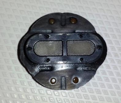

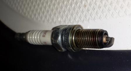

Last evening I took off the [vapor separator tank] to make sure [it] had no dirt in the tank and pump filter. It was not an easy task. All was very clean. Now have to get new clamps and try to hook up a pressure gauge on the pump outlet to see if I have 35-PSI. Spark plugs showed clean burn and no wear. Float did not show a leak and low fuel seems to flow unrestricted into the [vapor separator tank].

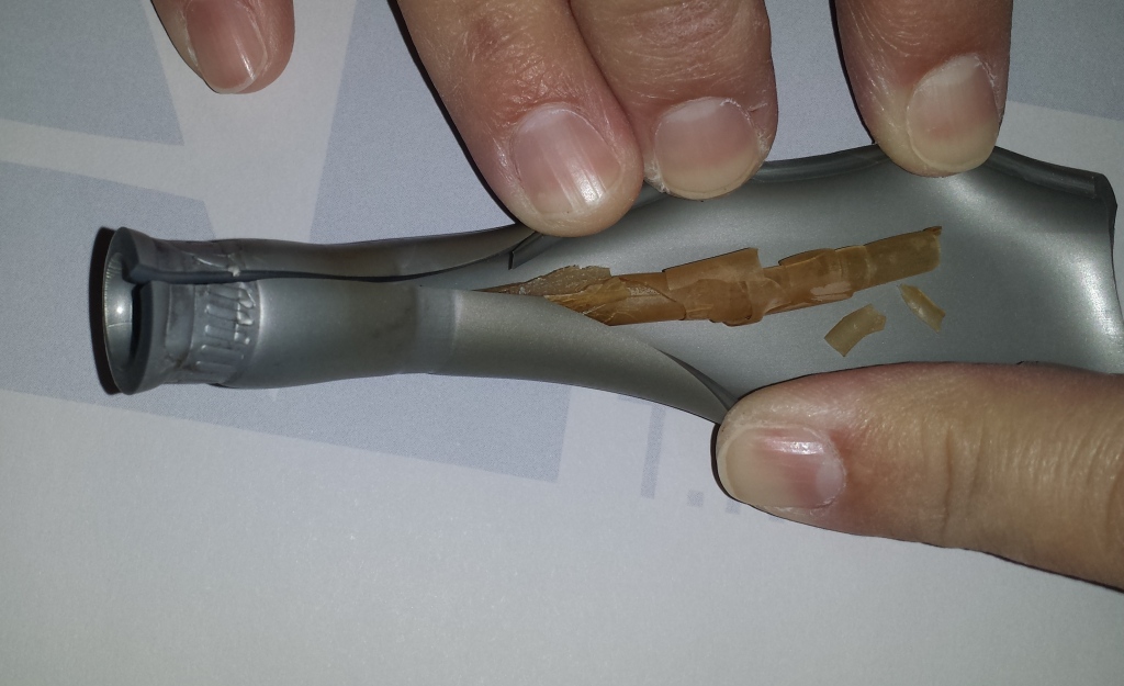

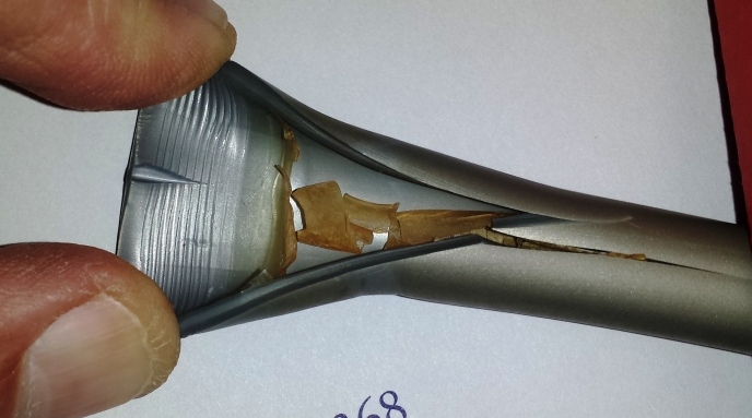

The service shop also replaced the gray Mercury-brand fuel hose with red writing. The previous owner already had replaced the fuel line from the tanks to the fuel primer bulb, but not the fuel line from primer bulb to the engine. He also must have used gasoline [containing ethanol], as the fuel line was completely deteriorated. We cut open the gray Mercury-brand fuel line to see the damage (pictured below). I was lucky that no debris got as far as my fuel filters, but still [this deteriorated fuel line] was bad. I'm glad they replaced it. I should not have assumed that the previous owner would always have used non-ethanol fuel (or at least ValvTect-treated gasoline). I can't blame him; the Mercury Owners Manual says the engine is good with running fuel that contains as much as ten-percent ethanol.

- ethanol and fuel lines.jpg (109.22 KiB) Viewed 32710 times
- Red Merc.Whaler Fuel lin degration1.jpg (210.96 KiB) Viewed 32710 times

That gray fuel hose with a somewhat metallic finish sold under the Mercury or Quicksilver brands is notorious for failure of the inner liner of the hose. As you suspected, it seems that exposure to gasoline fuel containing ethanol is the cause of the deterioration of that gray, metallic-finish Mercury-brand fuel hose. It has been frequently recommended in prior comments from many participants that any of that gray, metallic-finish Mercury-branded fuel hose be removed from boat fuel systems if there is any chance of having been exposed to gasoline-ethanol blended fuel.
By removing that gray fuel line you no doubt have avoided future problems.
Your photographs are good evidence of the problem with that gray fuel hose and the deterioration of the inner hose liner from ethanol-gasoline blended fuels. Thanks for taking the pictures and posting them.
