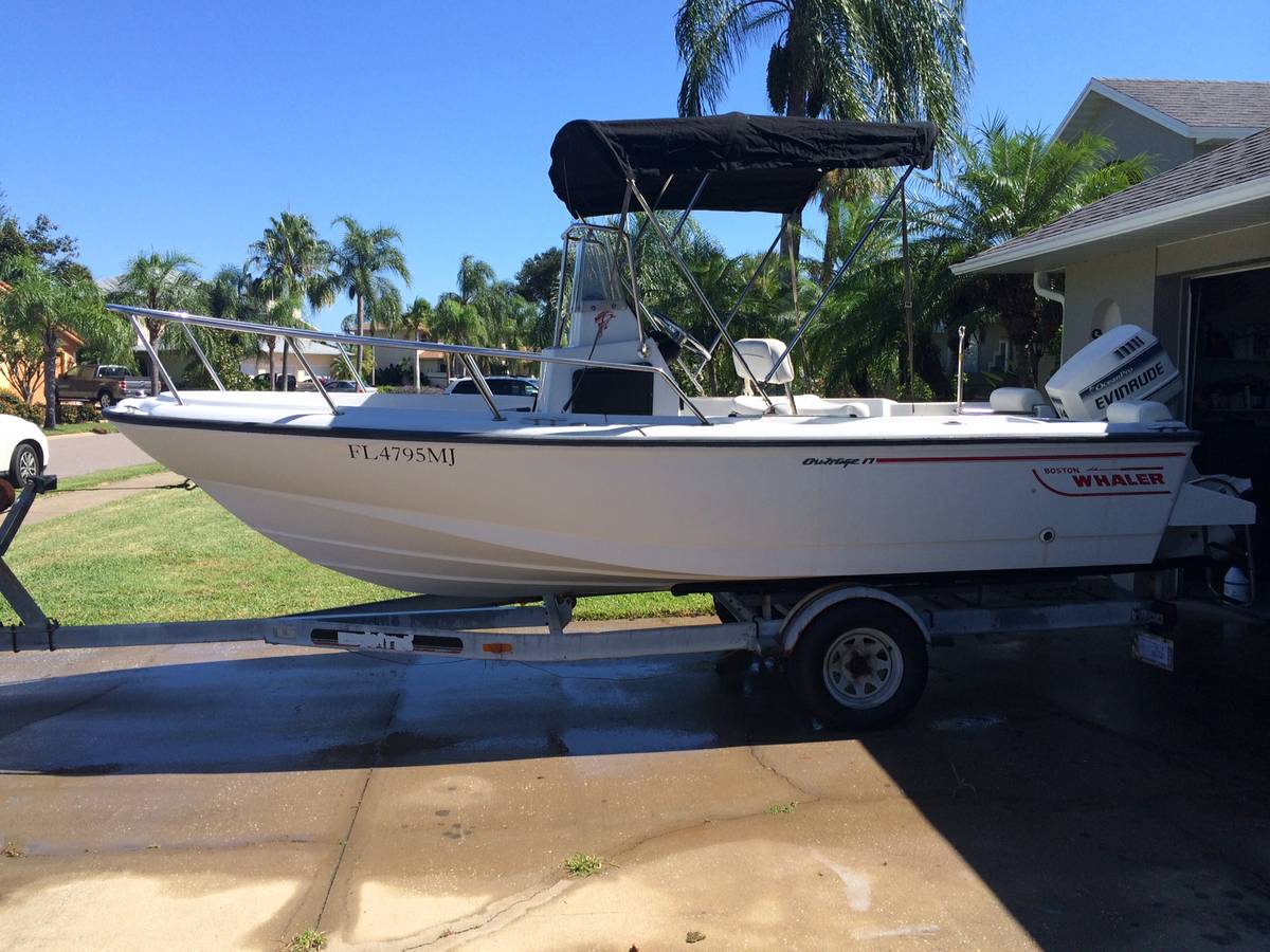

Where is the fuel vent located on a 1997 Outrage 17?
I have seen a schematic of a 1998 Outrage 17 with it located on the port side of boat. [Does my 1997 OUTRAGE 17 boat fuel system] have a vent?
Whaler port side.jpg (140.73 KiB) Viewed 7100 times
As my picture shows, you will see none there.

1998 17 OUTRAGE, fuel tank vent on port side

The tank vent on my 1997 Outrage is port side a few inches below the fuel filler cap.

Port side, below the fill port.
