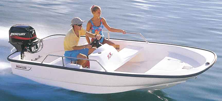

If Boston Whaler offered a Bimini top as an option of the 2000 SPORT 13, look at their method of mounting the frame rails.
2000 Boston Whaler SPORT 13
As seen above, it looks like it will be impossible to attach the Bimini top frame base hinges to the gunwales and not have interference with the side railings. The most likely solution is to use a Bimini top frame base hinge that will mount to the inwales. Below is a typical hinge, called a side mount deck hinge for a Bimini top. You can find these at many suppliers.
Side mount Bimini top frame hinge
The side-mount deck hinge may also be a problem, as it looks like there will be interference with the controls on the Starboard side. You may find that your dislike for the appearance of the rail-mounted frame base hinges will have to be overcome in order to have a workable solution.
Another solution may be found in mounting the Bimini top frame iso that the long leg of the top frame attaches to the gunwales ahead of the side railings, and when the top is folded down it stows to the bow. This is actually the normal method of stowing a Bimini on a Boston Whaler small boat due to the general area available as a result of the square bows.

I think putting both of your solutions together might be the best option for me, i.e., using a side mount bimini top frame hinge and mounting it just forward of the starboard controls; and attaching the long leg of the top frame there with top stowing to the bow.
