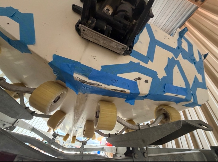

Q3: if just two bunks are sufficient for a 1972 NAUSET 16, can an existing floppy-roller trailer be converted to a two-bunk trailer by removal of the floppy rollers and installing two large-cross-section (4 x 6) dimensional lumber planks on the existing flat brackets? (Here I assume I can loosen the bolt below the flat plate and get the angle to follow the shape of the hull, as seen in Figure 1 below.)
Fig. 1. A floppy-roller trailer. Please ignore the Frankenstein damage to the hull.

I recently purchased a 1972 NAUSET 16 that came on an E-Z-LOADER trailer with [floppy] rollers. I would like to convert this trailer to a bunk trailer. I suspect one of the rollers is actually [the cause of] a puncture in the hull that needs repair.
I have read that Boston Whaler recommends a keel-roller set-up with bunks for stability, but then they moved away from that and more or less now recommend anything but [floppy] rollers.

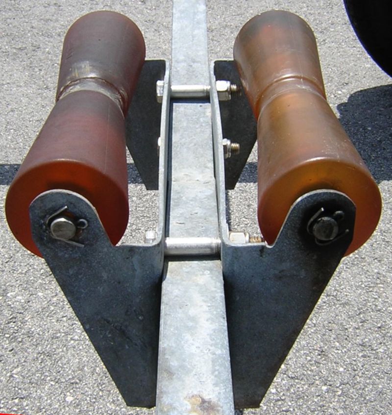

Fig. 2. Paired keel rollers installed on trailer. In this view the brackets are mounted as low as possible to the crossmember.
While using paired keel rollers for a 16-footer might be excessive, mounting two keel roller brackets back-to-back will actually simplify the installation.
Note above in Figure 2 that in some situations the lower mounting bolts may need to pass through the trailer crossmember. This occurs when a higher roller position is desired. In that instance the holes for those bolts must be located on the exact centerline of the vertical face of the crossmember in order to minimize loss of strength in the crossmember. Be sure to use a galvanizing spray-on compound to restore rust protection for the steel at the drilled hole, before installing the brackets.

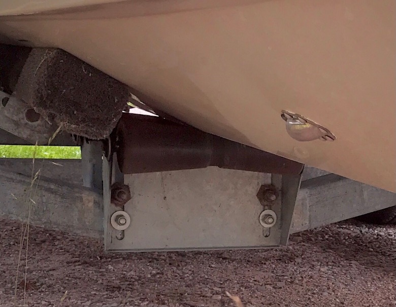

Fig. 3. A keel roller mounted at a raised height above a trailer crossmember by drilling a hole in the crossmember for locating the lower mounting bolt.
As seen in Figure 3 above, the mounting height of a keel roller can be raised higher if the lower mounting bolt position is changed to a hole in the trailer crossmember. The hole in the crossmember should be drilled exactly on the center of the vertical face of the crossmember to minimize any strength loss due to the hole.
Roller mounted closer to the bow may benefit from having a higher mounting position.
Also note this trailer crossmember is bent to form a lower center section. Using a one-piece keel-roller mounting bracket allows for a simple and sturdy mount of the bracket to the curved crossmember.
