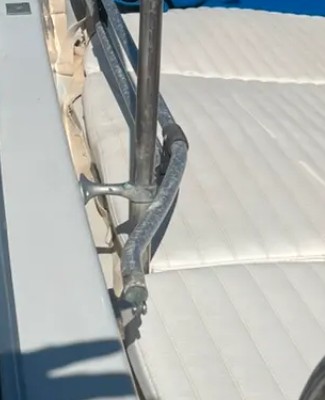

Q1: are the frames for supporting a Wm. J Mills & Co. Flying Top for a MONTAUK 17 made from aluminum or from stainless steel?
Q2: will the frame supports for a MONTAUK 17 Flying Top made by Wm. J Mills & Co. have straight tubes or S-curved tubes (as seen in Figure 1)?
Fig. 1. A frame for supporting a Bimini Top on a MONTAUK 17.
S shape.jpg (22.23 KiB) Viewed 2043 times

Gargantuga wrote:Q1: are the frames for holding a Flying Top for a MONTAUK 17 made by Wm. J Mills & Co. made from aluminum or from stainless steel?
The frames used on Mills canvas are generally ALWAYS made with stainless steel tubing in my experience.
Gargantuga wrote:Q2: will the frame supports for a MONTAUK 17 made by Wm. J Mills & Co. have straight tubes or S-curved tubes (as seen in Figure 1)?
I would be very surprised if the frames had an S-curve. I do not recall seeing that approach used.

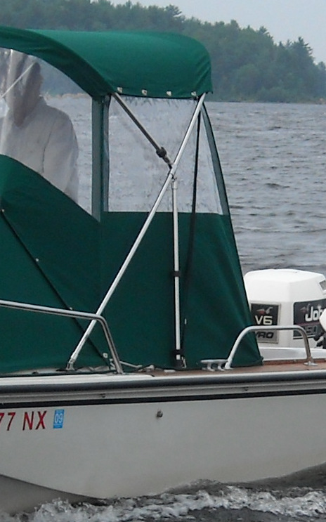

An older thread shows a Mills Flying Top on a MONTAUK 17:
https://continuouswave.com/forum/viewtopic.php?t=3294
The design appears to allow the Flying Top to be stowed by folding the frame forward and lowering it into the foredeck.
In the photographs shown in that thread, I am surprised that the straps running aft are at such a long angle. Typically the aft straps on a Flying Top on a small boat will run almost vertically downward from the frame to the gunwales. In this manner they do not become obstructions in the aft cockpit while engaged in angling.
Below Figure 1 illustrates the usual method for supporting a Flying Top on a smaller boat, in this case on an OUTRAGE 18.
Fig. 1. A Mills Flying Top on the OUTRAGE 18 CICADA. From a July 2008 trip
to the North Channel of Lake Huron and Georgian Bay.
Rest in Peace our dear friend Paul Mott.
Note the crafty design of the frame, fixed supports, and straps. There is a fixed tube support that holds the frame erect, which allows the top to be folded and stored inside a boot on the frame. Also very unique is the orientation of the aft straps. They pull down and slightly forward. This removes the strap from being an obstruction in the cockpit aft of the reversible pilot seat.
For highway towing, the fixed vertical support tube can be removed from its base, and the whole frame tilted and lowered forward, into the forward cockpit. The hinge fittings typically use a removable spring-loaded pin, so they can be unhinged for folding the frame forward.
Also, do not worry about the size of the Flying Top. It gives excellent sun shade for people standing directly under it, and also protects against rain.
