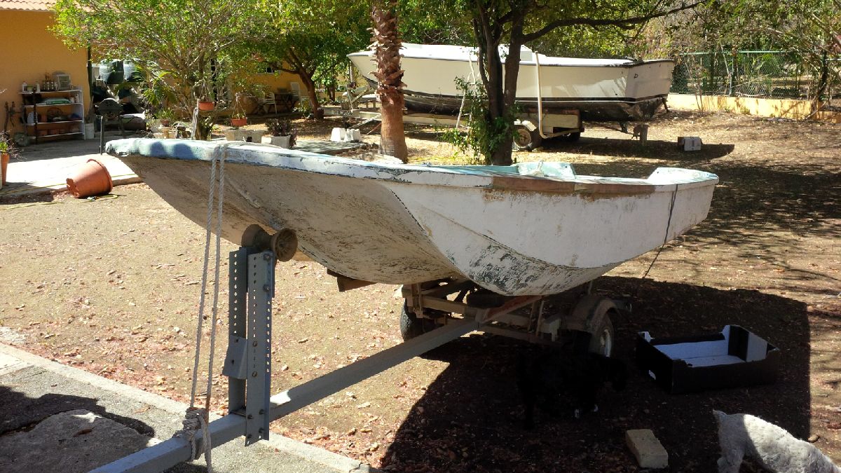

So my dad and I bought a boat
Albert Jr.
- Posts: 53
- Joined: Wed Oct 28, 2015 4:26 pm

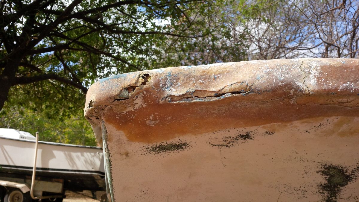

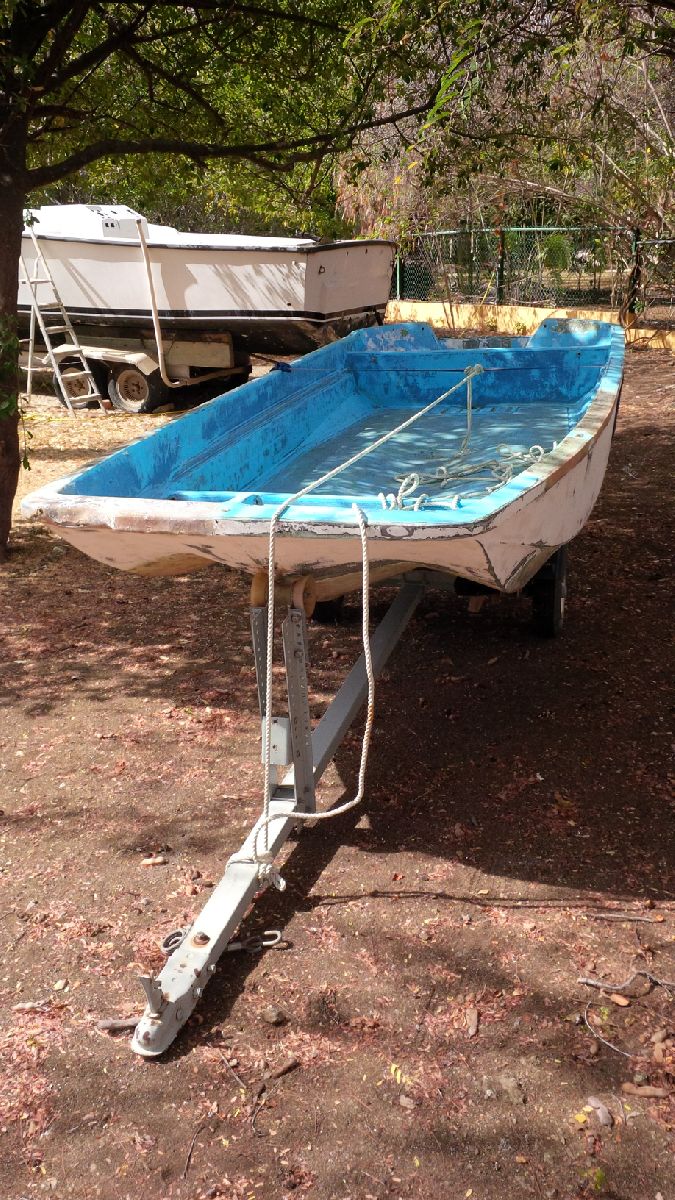

This all started when a customer came in with a 40 hp Tohatsu. We finally gave in and decided to buy it. After a while another customer of ours gave us a lead for a Boston Whaler 13 and we bought it also after some negotiating. The boat is from 1970 and is in decent shape (foam is solid). We've sandblasted it and we hope to have it ready for paint by the end of this month.
- The day we got her
- IMG_20160616_145748.jpg (228.56 KiB) Viewed 38793 times

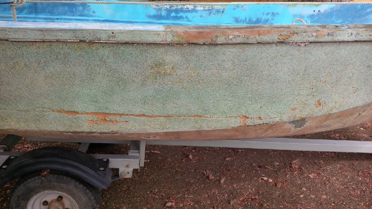

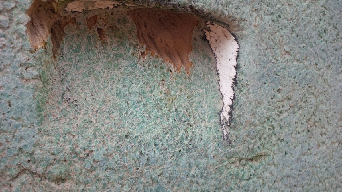

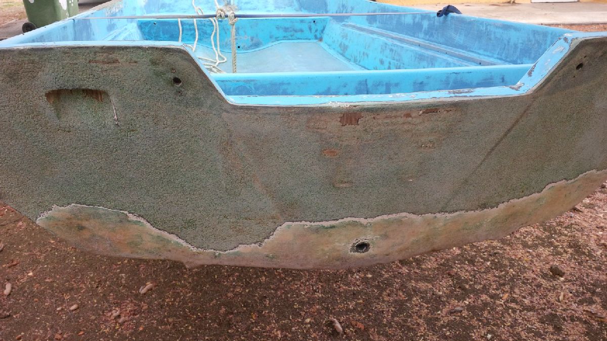

The day we got her back from sandblasting, we could see a bit better how much work the hull needed. It's going to be a job but I've seen worse.
- IMG_20160623_153234.jpg (207.67 KiB) Viewed 38789 times
- IMG_20160623_153224.jpg (183.03 KiB) Viewed 38789 times
- IMG_20160623_153217.jpg (255.81 KiB) Viewed 38789 times

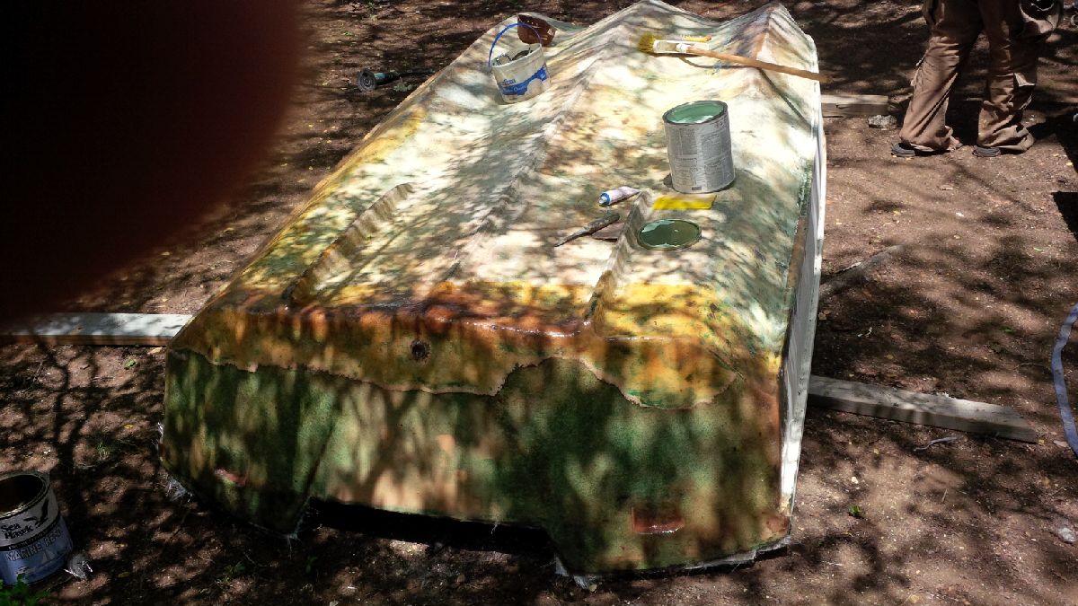

Re: So my dad and I bought a boat

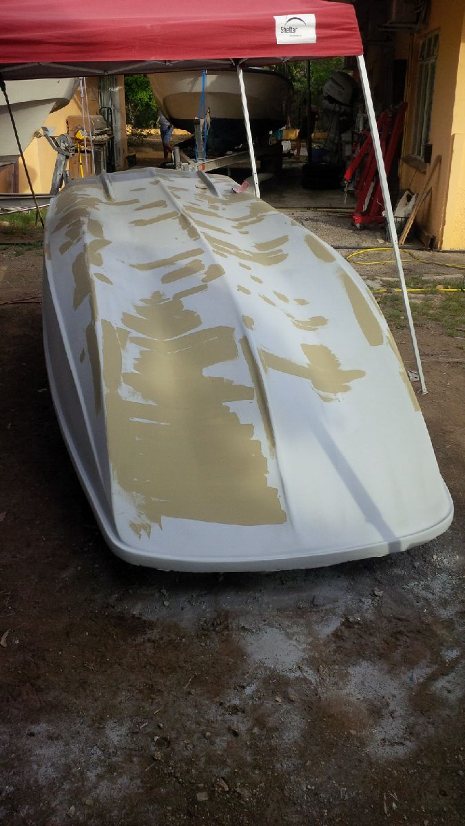

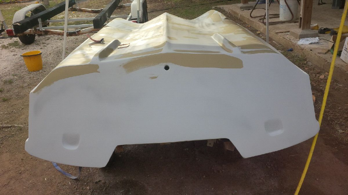

After a 25-day delay I've managed to start on the boat. I was at least a helping hand in it.
After first adding a polyester filler to all the holes that were left after sandblasting, we've applied 1.5-ounce fiberglass mat at the transom and side of the boat.
- IMG_20160725_114828.jpg (184.57 KiB) Viewed 38559 times
- IMG_20160725_114847.jpg (202.67 KiB) Viewed 38559 times

After glassing we've started adding a marine body filler called Power Grip. It's softer than usual fillers which makes it easier to grind. We will add one or two more layers before painting.
- IMG_20160725_120751.jpg (133.78 KiB) Viewed 38558 times
- IMG_20160725_120757.jpg (132.83 KiB) Viewed 38558 times

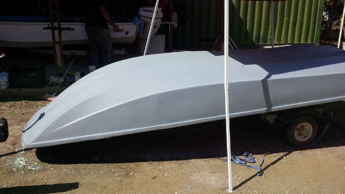

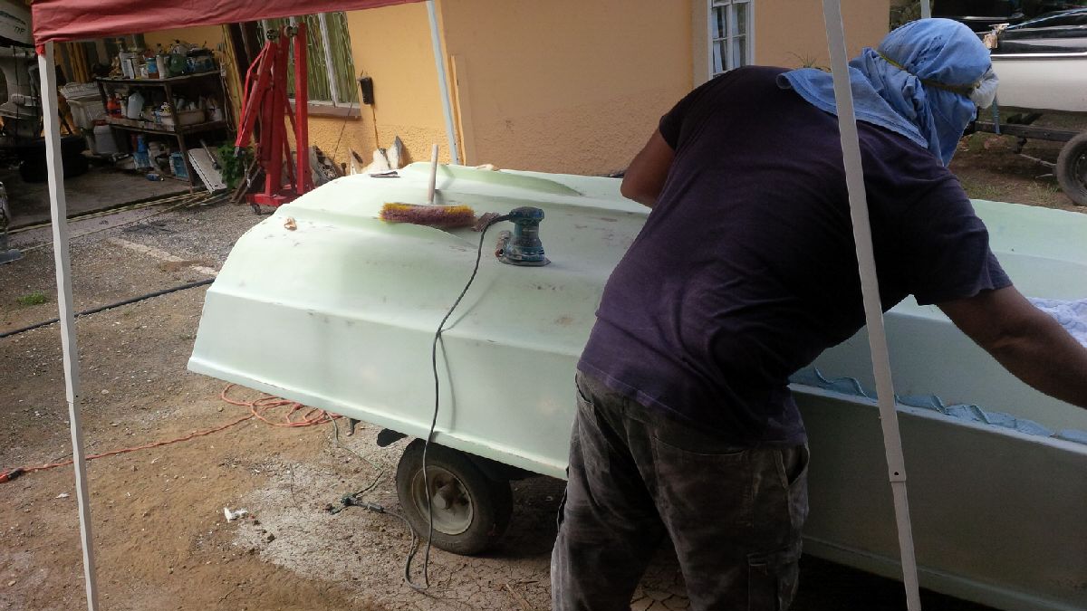

We finished off the fairing starting with p60 grit paper, then p140 grit paper, and then ending with p220 grit paper. The fairing has been going well, so far. Only problem we've seen is that the body filler formed some notches. We wanted to fix this by using Total Boat primer, which the paint company said can fix notches.
- IMG_20160804_100404.jpg (137.22 KiB) Viewed 38454 times
- IMG_20160804_100401.jpg (81.41 KiB) Viewed 38454 times

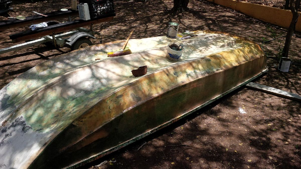

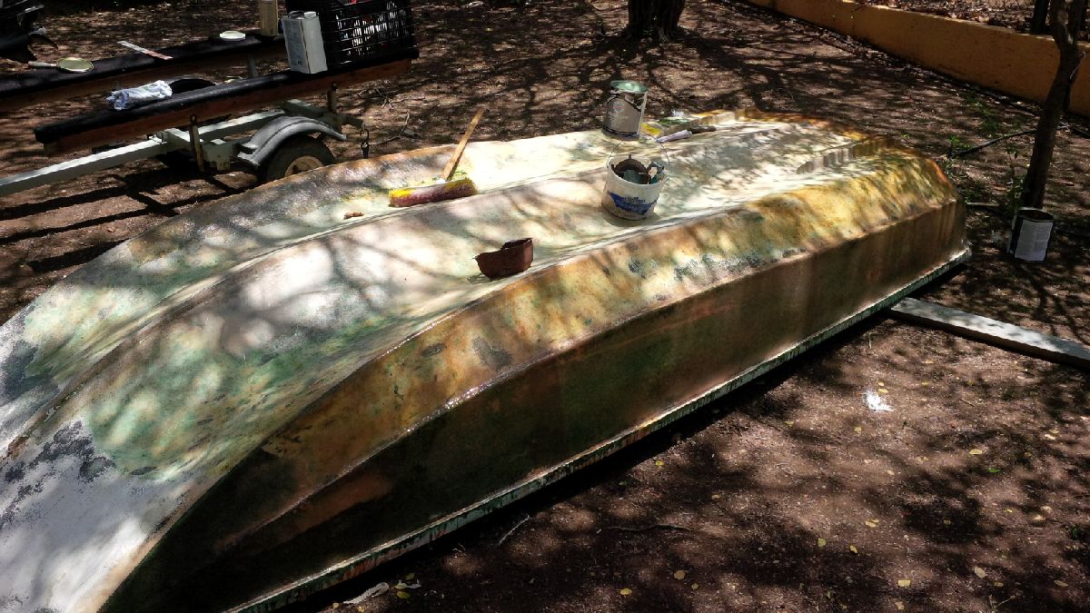

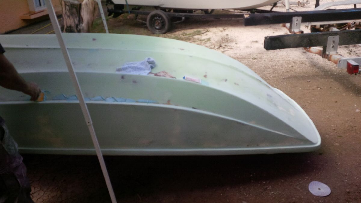

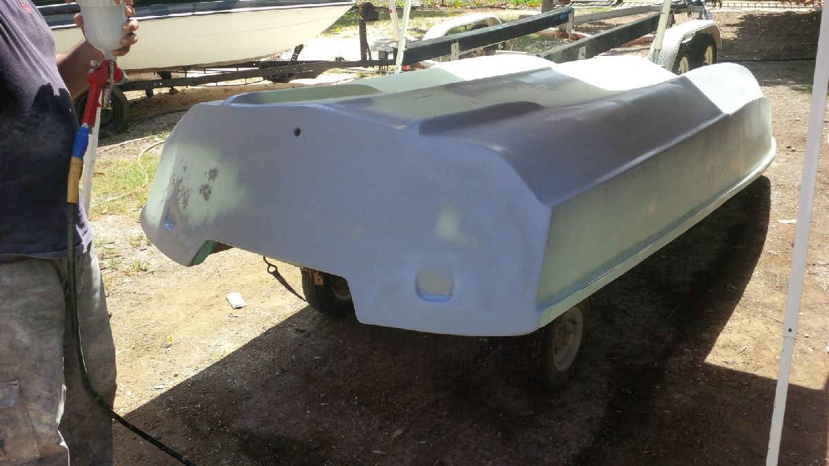

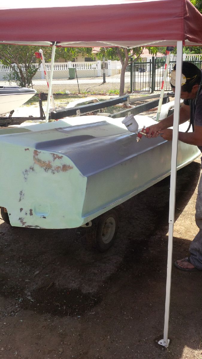

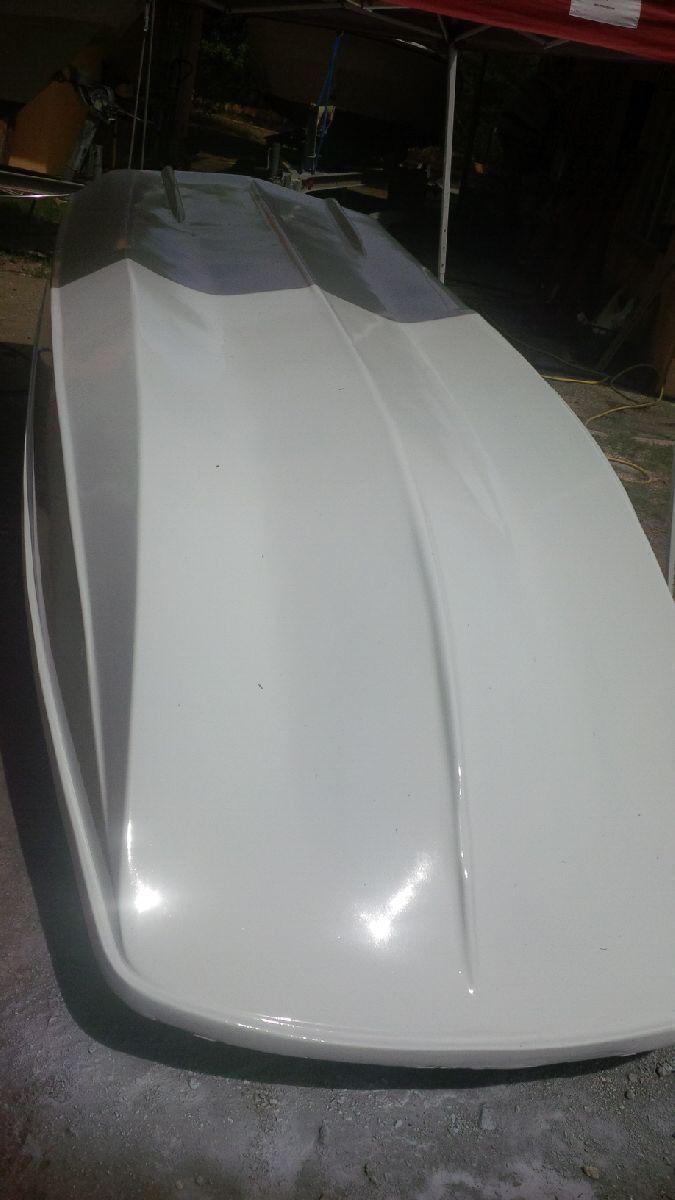

Being a brush-on primer and quite thick, we decided to use a thinner to make it possible to spray on. This made for some small holes.
- IMG_20160804_143521.jpg (112.63 KiB) Viewed 38452 times
- IMG_20160804_143506.jpg (138.69 KiB) Viewed 38452 times
- IMG_20160804_144042.jpg (135.69 KiB) Viewed 38452 times

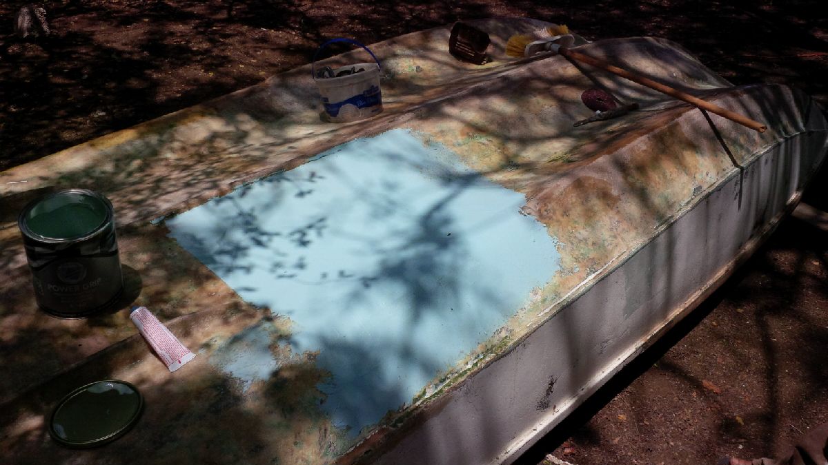

To counter the small holes that resulted from using a thinned primer and spraying it on, we tried rolling on the primer. It helped fill the holes. We sanded the primer and added a light primer.
- IMG_20160804_151232.jpg (115.7 KiB) Viewed 38452 times

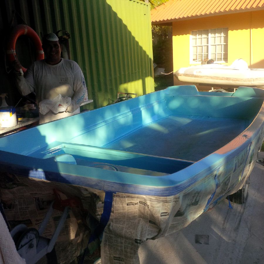

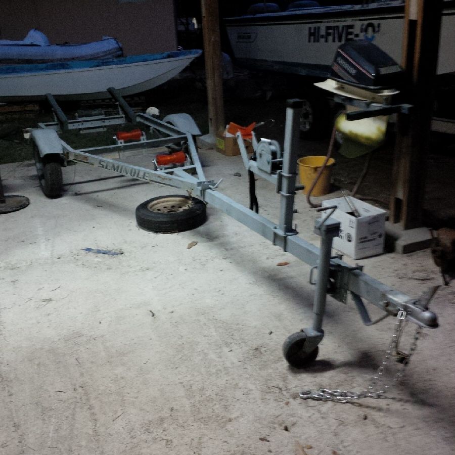

Thankyou everyone,
I haven't post much lately since I've been awfully busy with work.
We did get a new trailer which we restored. Still have some minor adjustments to do.
Boat has also been painted inside, engine has been added finally and now we're prepping for minor details.
Enjoy :)
Enjoy :)
- IMG_20161017_183050.jpg (122.65 KiB) Viewed 37733 times

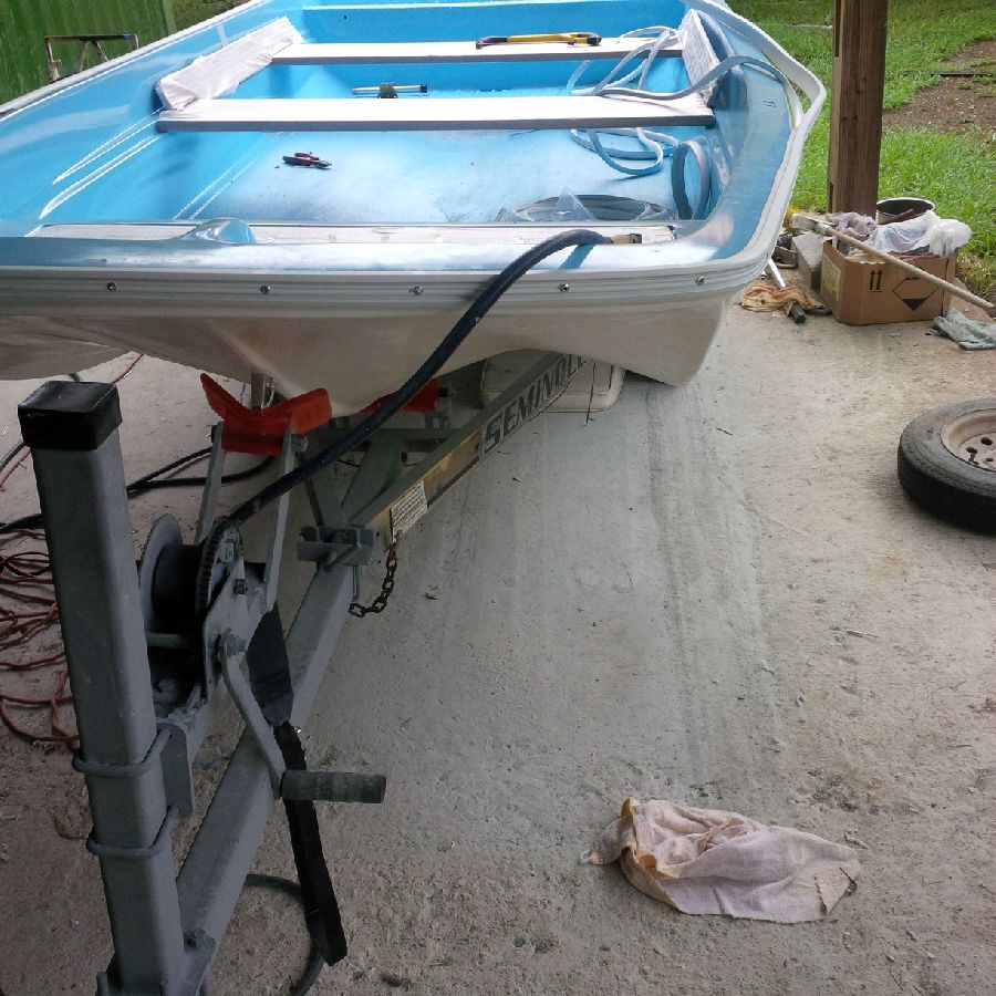

Boat on trailer
- IMG_20161017_185451.jpg (95.98 KiB) Viewed 37733 times

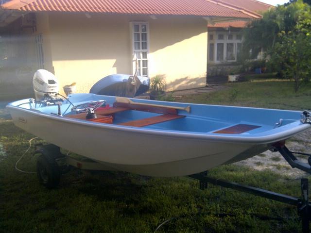

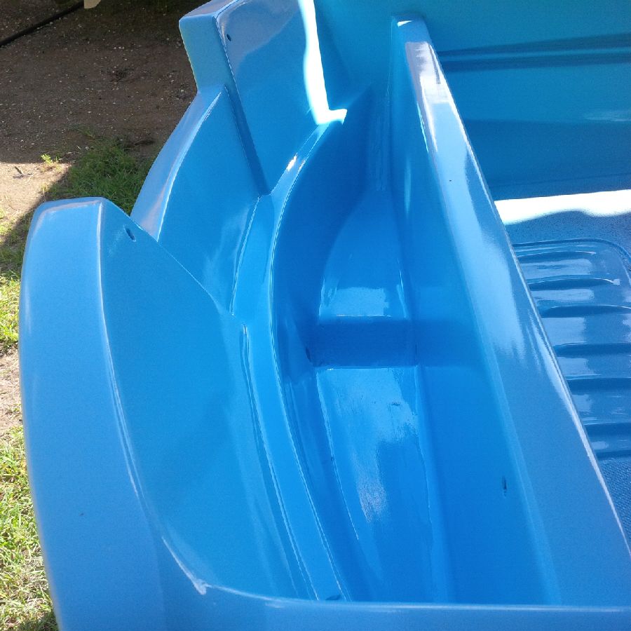

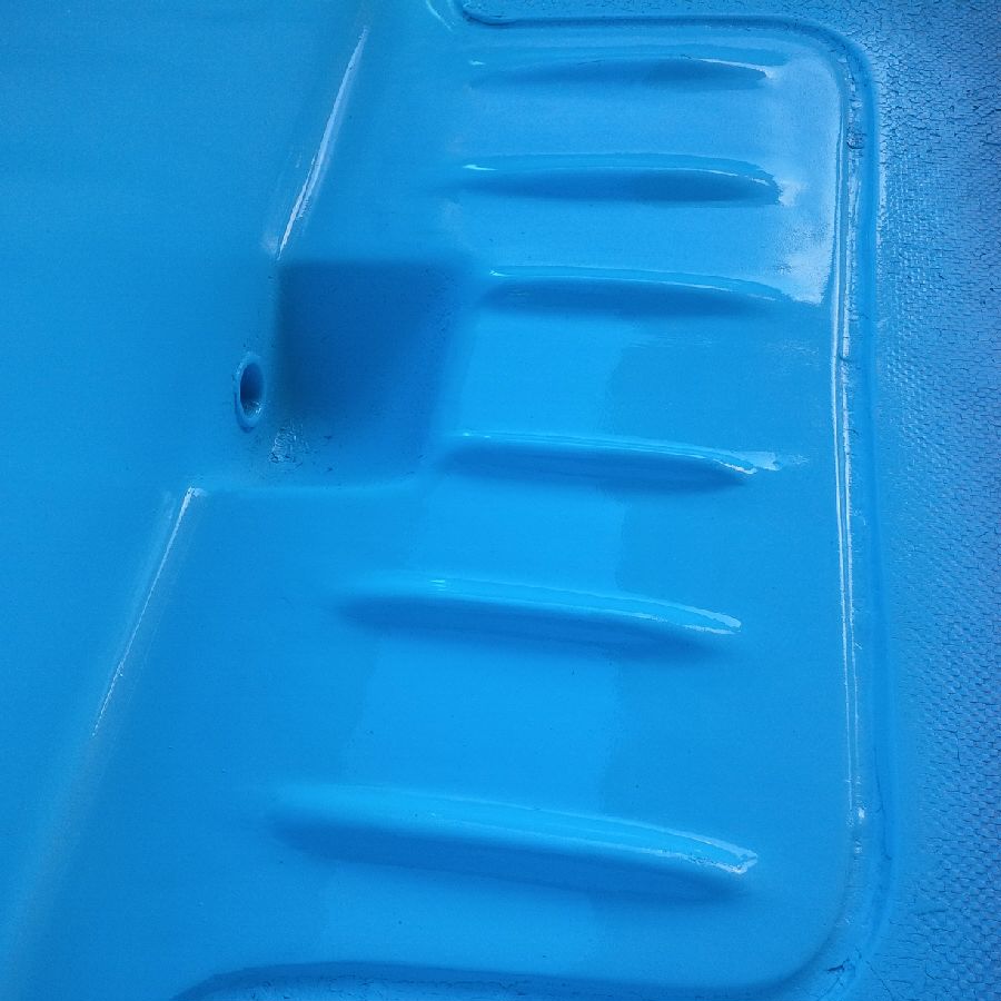

Since the buyer wanted a lighter colour,
compared to the first Whaler 13 we sold him (my first Whaler 13)
We decided to use a more baby blue colour.
It came out decent and adding the anti-slip went well too.
Pics will follow.
Pics will follow.
- IMG_20161022_171159.jpg (126.64 KiB) Viewed 37733 times
- IMG_20161022_171212.jpg (114.09 KiB) Viewed 37733 times

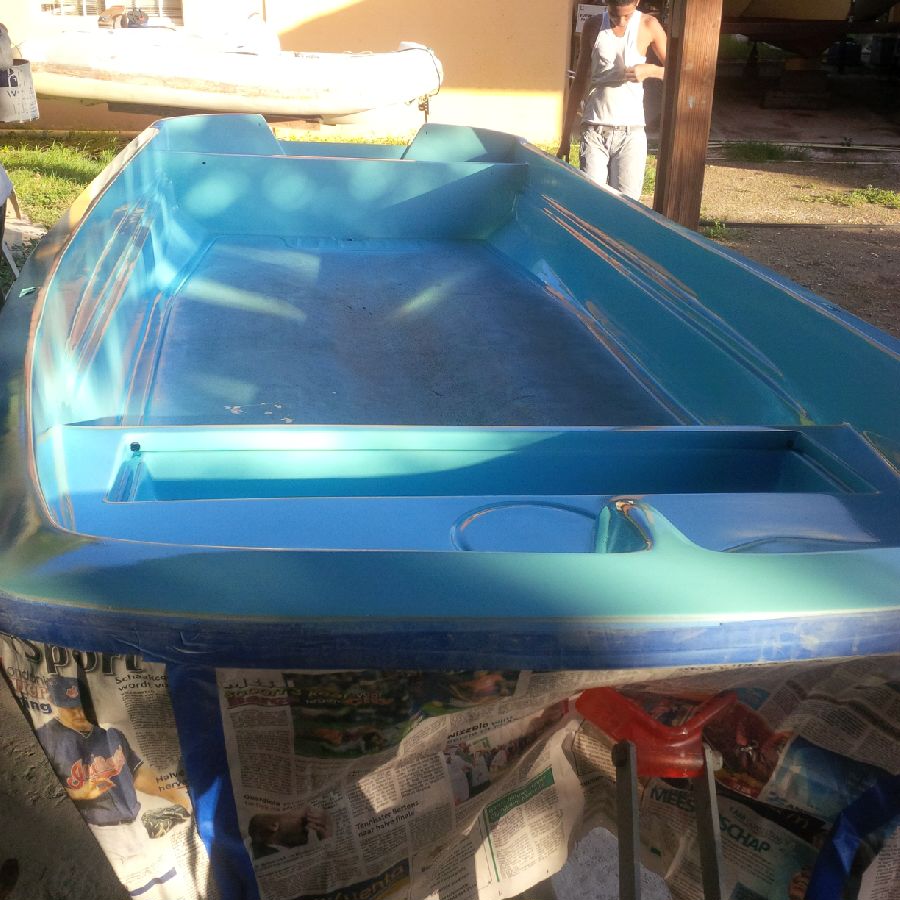

Continued;
Interior paint has been added. Since we couldn't get the original paint,
we decided to mix white with blue. The paint looks good but just a little bit of green
will bring you closer to the original colour.

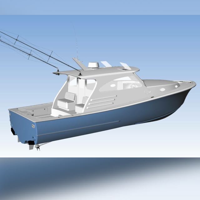

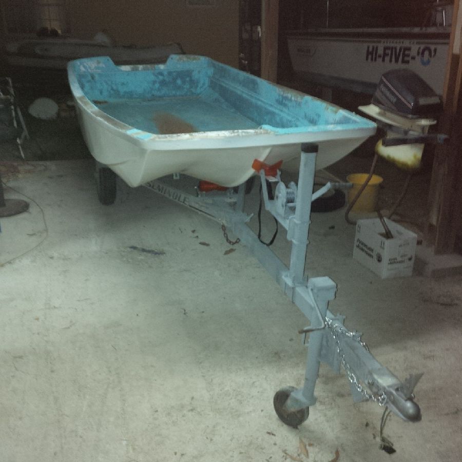

As promised, here's also a picture of the 40 foot lobster yacht I'm helping to build.
I'll post more pictures of the real boat as we get along.
- IMG-20160901-174904.jpg (27.29 KiB) Viewed 37481 times

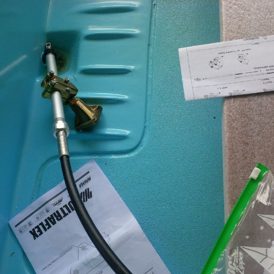

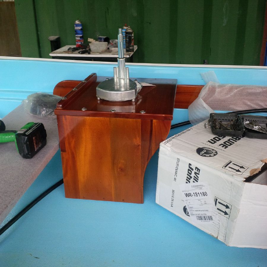

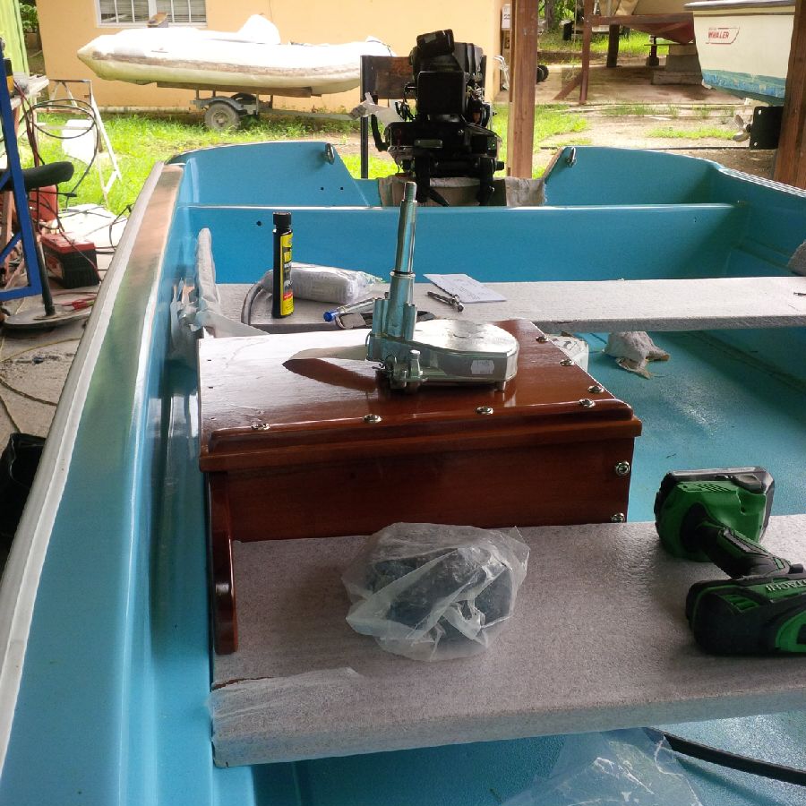

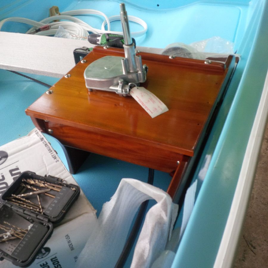

Here we have some more picture of the rigging.
The steering system we used is a bit of an older tech than
what most other boats have but we decided to use it instead because
of its simplicity and its space saving benefits.
- IMG_20161119_120243.jpg (100.08 KiB) Viewed 37478 times
- IMG_20161119_120239.jpg (151.22 KiB) Viewed 37478 times
- IMG_20161119_120228 (1).jpg (162.6 KiB) Viewed 37478 times

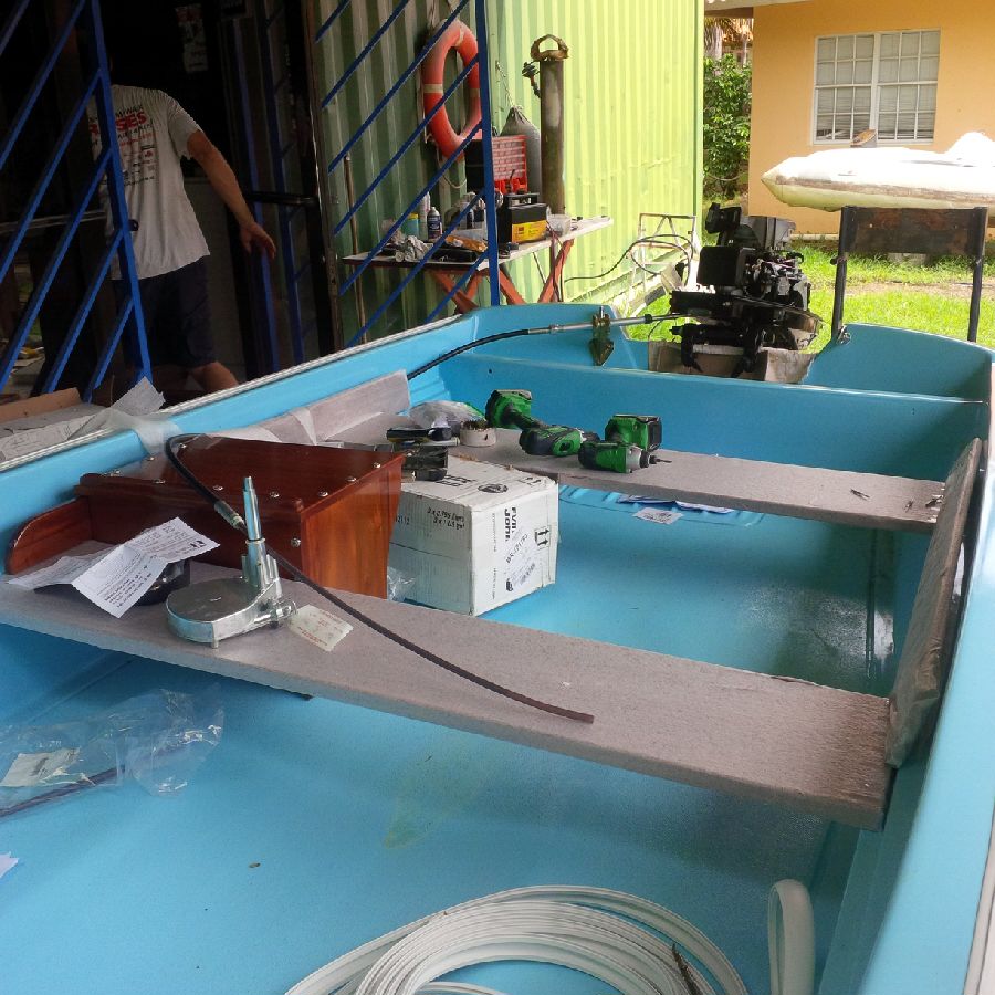

More pictures
- IMG_20161119_124121.jpg (143.12 KiB) Viewed 37478 times
- IMG_20161119_120309.jpg (109.92 KiB) Viewed 37478 times
- IMG_20161119_120252.jpg (149.11 KiB) Viewed 37478 times

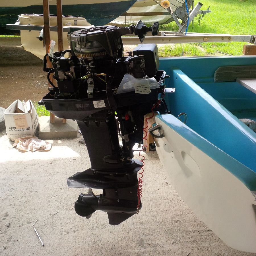

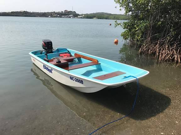

Well guys we've done it, we've finished the boat.
Got to say that this build was one of trail and error but after much reworking, after much sweating, and after much whatever came out of our mouths, we've finally finished the boat.
The Tohatsu 40 is performing better than ever. I honestly have never ridden a better balanced boat than this one.
A goodbye is yet to come (hopefully not soon)
For now, enjoy the last picture of the build.
Look long enough and you'll appreciate every detail that went in to here.
- bw13.jpg (36.51 KiB) Viewed 36020 times
