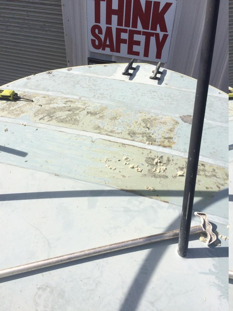

After much delay the tank cover is finally repaired/improved. After days of cutting, sanding and grinding I turned over the thin fiberglass top to the boatyard to finish.
They used three sections of a glass/balsa sandwiched laminate and glassed it to the thin original decking.
My impressions are that it looks perfect, is much lighter, and much stiffer than the original. (I have not seen the bill yet)...
Hats off to the SF Boatworks for quality workmanship. Next step is to cover my new tank.

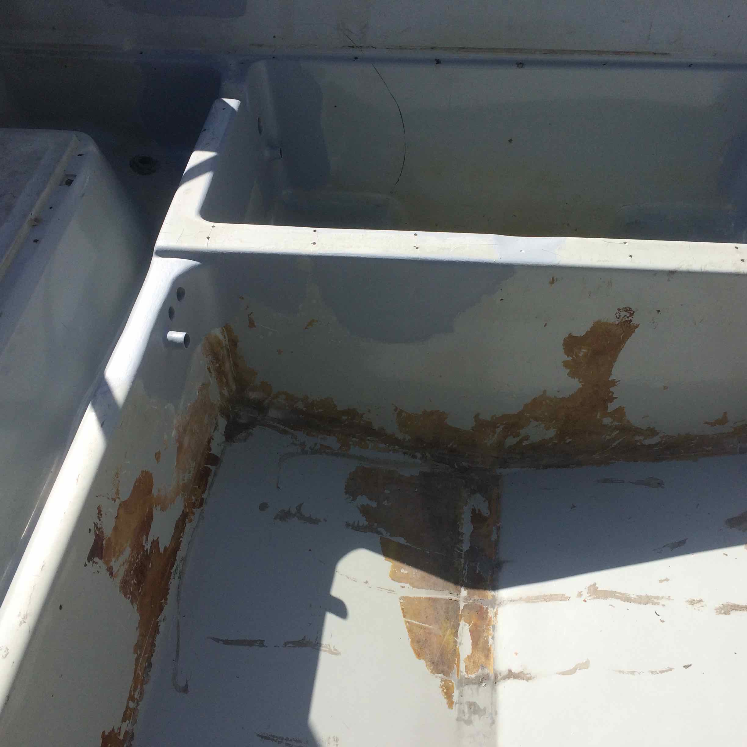

Here are some other miscellaneous repairs:
For some reason CPD liked exposing foam on this rigging job. Maybe a deadline for shipping her to Alaska.
In any case two big holes for the fuel lines (using bent copper tubing), they ran in and then back out of the bait well. In addition, lots of holes for the tow bar mounting brackets (I did not get the actual bar).
Baitwell 1
Baitwell 1a
They also used white PVC pipe to line the big wire tunnel into the cabin (jagged sawzall cut, silicone calked). For that we installed a pre-made fiberglass tube and glassed it in (i'll add the pictures of that repair later)
