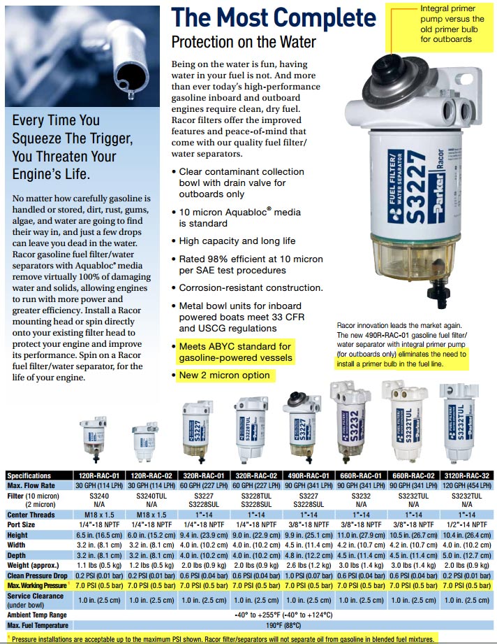

Postby jimh » Tue Sep 06, 2016 2:54 pm
Here is a slightly fuzzy graphic with loads of good information on RACOR filters:
RACOR Filters USCG Approved
From this information is appears that if you want a filter media with a rating of 2-micron you have to move up to the 320-series or larger filters.
For more information about the newer 2-micron filter media retrofit filters, see
https://www.parker.com/literature/Racor ... -_7738.pdf
RACOR says:
These filters are specifically designed to retrofit existing Racor filters installed on outboard or inboard vessels, main propulsion or power generation engines.
The new S3220SUL and S3228SUL 2-micron filters are offered as retrofits to Racor clear or metal bowl filter assemblies. Recent changes to gasoline fuel blends have resulted in many boaters requesting a more efficient, high performance media for contaminant and water removal. Racor’s 2-micron Aquabloc® media has been used successfully in demanding diesel engine fuel injection system applications. Gasoline users can expect the same high performance and efficiency.
One effect of ethanol blended fuel is fuel tank and fuel system component “cleansing” resulting in more contaminates in the fuel stream. Racor filters trap particles in their Aquabloc® media which also repels the damaging water into the drainable collection bowl
I don't know if you can buy a pre-packaged set with the 2-micro filters. For example, you can get a good deal on a RACOR 490-series from DEFENDER.COM at
http://www.defender.com/product3.jsp?pa ... id=1940998
Then you could buy the retrofit S3228SUL 2-micron filter for about $20:
http://www.boatersland.com/racs3228sul. ... ArN48P8HAQ
