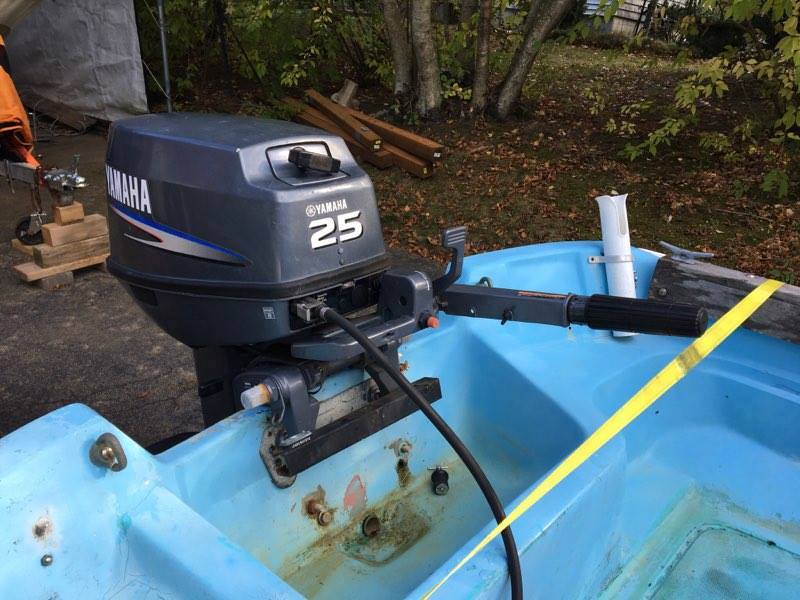

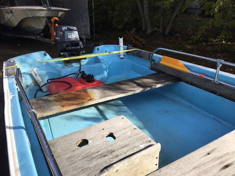

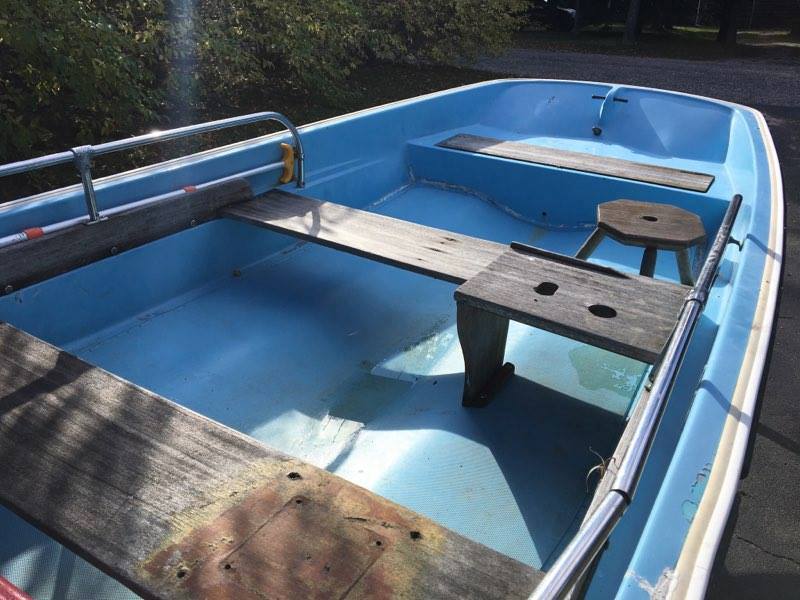

Hi! I am trying to figure out what is the model year of my Boston Whaler boat. I was told 1964, but I am thinking it is not. I can't find a hull number, and do know--pre-1972--not every boat had one. Does anyone have an idea on year?

Because of the engine well. See [the REFERENCE section at http://continuouswave.com/whaler/reference/13/ regarding] 1971 engine splash well change.
History...In 1971...the motor well changed to a wrap around style; previously a straight bulkhead had separated the transom from the cockpit...In 1972, the transom height was raised to 20 inches from 15 inches, probably to keep pace with the use of higher horsepower motors...

ALL Boston Whaler boats have had hull numbers. Please see the FAQ. Read about stencil numbers. You should look for the stencil number. It may be under that reinforcement bracket where the engine is mounted.
About all that is clear in your images of the boat is the transom is still the cut-down transom for a 15-inch-shaft engine. This just identifies the boat as a pre-1972 model. But the sink-style splash well means it is a 1971 or newer. The intersection of these two is 1971.
Please show us the bow of the boat. The presence or absence of a smirk bow will also help identify the model year.

I believe it is a 1972 model year. That is the only year the 13 had the combination of the blue interior, 15" transom cut out, sink-style stern splash well, 3 piece rub rail with black insert and smirked hull.
