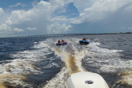

A few of us CW members have installed the Turboswing. I installed one on my 170 Montauk and it has worked out very well. I can easily tow large tubes, multiple tubes--plus I tow two skiers very often.
