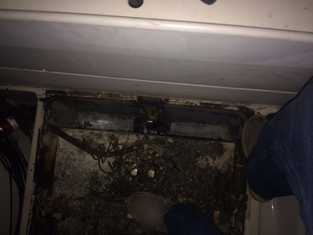

Just checked the fill and vent line on the gunwale. Both are from 2007. I removed the small deck plate for fill and vent. [Hoses were] same age. No gasoline smell in rigging area.

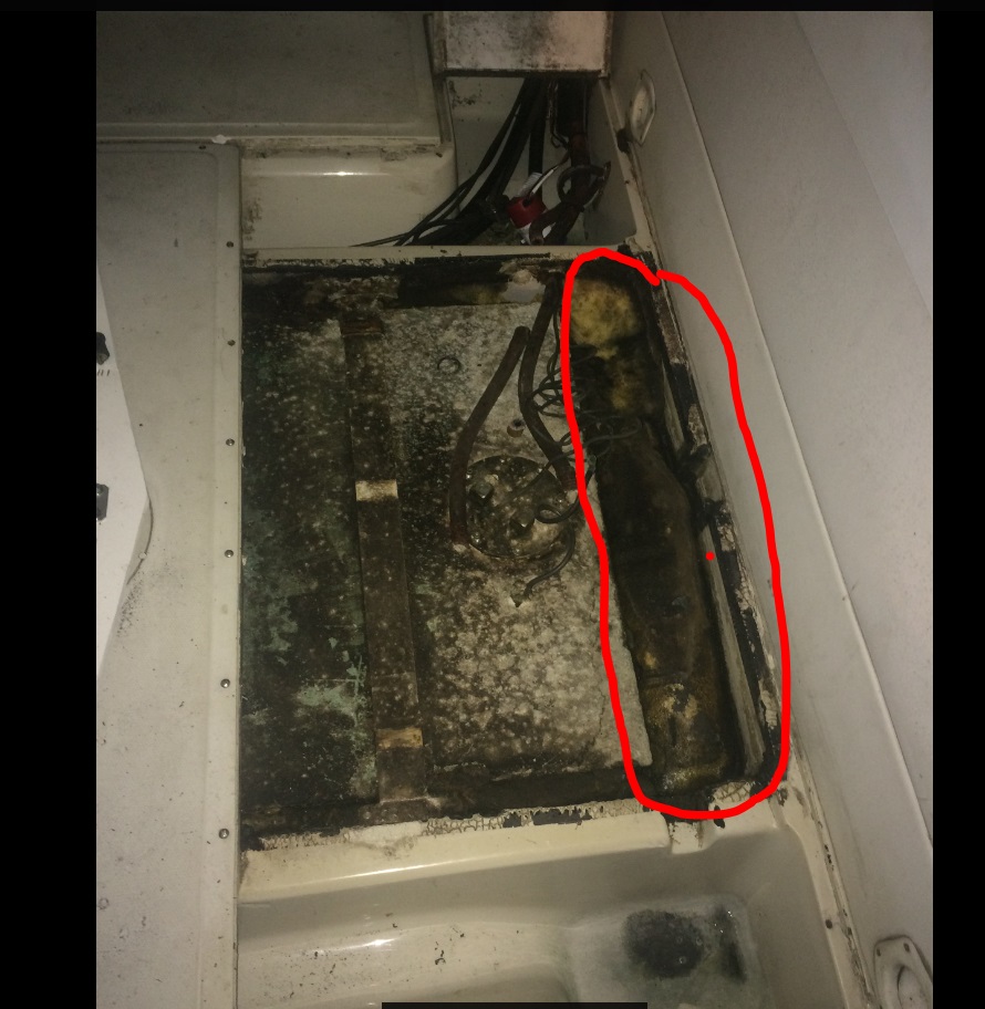

If the hoses are newer and the tank gage gasket isn't leaking, then you probably have a pinhole in the bottom of the tank.
When I had my tank replaced, the outside of the tank was in pristine condition, no corrosion at all. There was a tiny pinhole in the bottom rear center of the tank near the fuel pickup , not even visible if not for a small wet spot on the bottom of the tank. The only telltale the tank was leaking was a slight gas odor in the cabin when the tank was full.

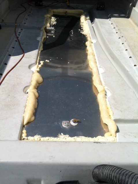

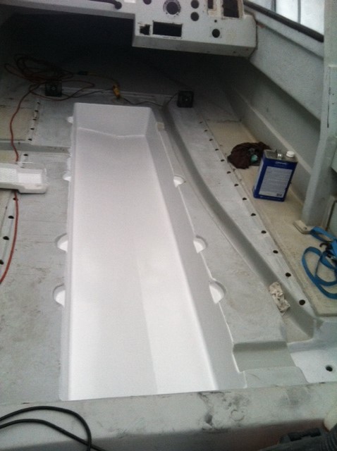

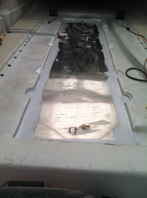

If you have to replace the fuel tank here is an example of what I think is good to do.
I painted the fuel tank cavity.
I foamed in the fuel tank
I removed excess foam and sealed with a polyurethane sealant; expansion and contraction due to temperature will cause air bubbles in the sealant so be aware of that.
Time will tell if this is a good solution to having exposed foam where water can soak in.

quickenberger wrote:...I removed excess foam and sealed with a polyurethane sealant...Time will tell if this is a good solution to having exposed foam where water can soak in.
Thanks for the description and images of your modification and repair to the fuel tank cavity and installation of a new tank. Please keep us posted on the outcome of sealing the tank foam top layer. That does sound like a reasonable approach, as long as there were no water already in the foam.

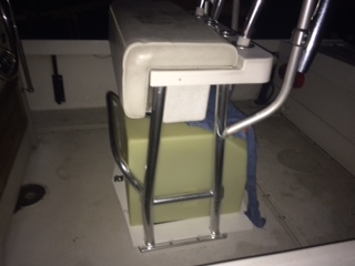

Temp tank installed. Need to run the fuel lines. 35 gallon moeller tank.
- IMG_2012.JPG (32.87 KiB) Viewed 53720 times

Pulled the rear plate. Tank is bad. I am thinking of digging the foam out in the rear and putting a bilge pump down there. The foam is wet at the rear of the tank. Should I put a bilge pump down there? Tank is completely empty of fuel.
- Capture1.jpg (191.92 KiB) Viewed 53673 times
