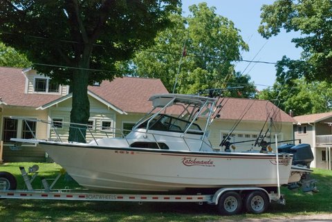

The OUTRAGE 21 is the first trailer boat I have had with a bow pulpit. The bow puplit has added some difficulty to launch and recovery. The boat is a 1999 21 Outrage, and the trailer is a1999 Load-Rite bunk. My ramp access is a bit steep, and tides can be a problem. I am looking for ideas and suggestions.
On the first launch, I left the winch cable attached and used the winch to release the boat into the water. That turned out to be a little on the dangerous side. Had I not been prepared for the load on the winch it could have hurt. Other then a bit of a surprise, the launch wasn't too bad.
At the second launch I used a line from the bow cleat to the winch post with about four feet of slack (and no winch connected). That wasn't so smooth. It was hard to tell but I think the pulpit hung up on the V-block a little. Once it self released, the boat slid into the water, rather hard it seemed.
Best I can tell, with the boat near horizontal and floating, the trailer was on an angle so the bow was only resting on the front roller, the boat came off the front roller hard onto the 2nd roller, knocking it partially off the frame and dropping the hull onto the trailer crossmember. That resulted into a chip on the hull centerline. Easy enough repair below the water line, but I need to do something.
I am going to start by moving the winch bracket down. The location of the winch seems too high for this boat.
To readers have any ideas [to improve launching on] steep ramps? Maybe centering bunks or a differnet bow rest.
Or, perhaps a power winch with both power in and out feed?
The anchor was not in the bracket during the launch.

After giving it a lot of thought, I don't think just adding a bow stop is going to make a difference. Unless, I add it like Jeff did in the 2nd post, with a second post for the winch.
With the boat on the trailer on a steep ramp, the highest bow support is going to be the support the boat rotates against as it hits the water.
So for now, something that is no cost to do; I fixed the roller that was knocked off the frame crossmember, moved the bow V-block bracket up on the winch platform, moved the winch platform down, moved the post rearward and cut about 5 1/2" off the top of the post.
I will most likely buy an electric winch with power in and out, that way I can control how fast the boat comes off the trailer.

Got to try my trailer changes last night. Also tried a different ramp that was not as steep. But, due to the tide I still had a problem. Even after cutting the post down and lowering the hardware, the pulpit hung up on the post. Had some jet skiers that just recovered their skis offer to help some. That was a plus because my wife was afraid to do anything with the truck while I tried getting the pulpit free.
So the result was [silly expression deleted] repair to do on the hull, the center roller again shifted and this morning I ordered the Continental bow rest.
The electric winch worked as expected and I'm happy with that. The winch pulls the boat up a lot easier then I was able to with the old manual winch. Although when using the power extend, I started out with too much slack, which is where I think one of the the problems was last night.

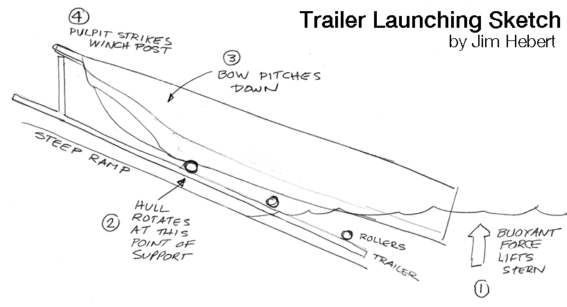

The problem with launching this particular boat occurs without correlation to using bunks or rollers.
The problem occurs due to the following circumstances:
--as the boat begins to unload from the trailer on a downward sloping ramp, the stern of the boat become buoyant
--with the stern buoyant, some part of the keel in the forward half of the boat is resting on some roller or some part of the hull is resting on a bunk
--the upward buoyant force at the stern begins to rotate the hull, pitching the bow down, as the hull rotates around that point of contact with a roller or bunk
--if there is no roller or bunk or other stop to prevent this downward movement of the bow, the bow will be rotating downward until it become buoyant or it hits some obstruction on the trailer
--if the hull has a projecting bow pulpit and the trailer has a tall winch stand, the pulpit is forced downward and hangs on the winch stand post.
This is a common situation for boats with bow pulpits when trying to unload from a trailer on a ramp with a steep downward slope.
The remedy for this was described earlier: the trailer must have an additional cross member or other support added to prevent the forward part of the boat near the bow from being pushed down by the tendency of the hull to rotate and pitch down the bow.
ALSO: the situation may be helped if the most forward keel roller on the trailer were changed to a double keel roller. This will give more support to the bow during loading and unloading. You can see an example of how to mount double keel rollers to a trailer frame cross member in the photo below. Although the boat pictured does not have a large bow pulpit, it does have an overhanging anchor that could easily foul on the winch stand.
Note the dual keel rollers mounted to the cross members. Also note the forward keel roller
at an elevated height to provide support to the bow stem. This elevated roller prevents the
bow from pitching down during unloading, and it helps lift the bow during loading.
It looks like PORTHOLE has decided to employ a carpeted V-shaped bow rest to provide support to the bow stem and keel and to prevent it from being pushed downward. It appears that the carpeted V-shaped bow rest can be attached to the tongue extrusion, so no additional cross member will have to be added.

Postby jimh » Tue Jun 28, 2016 9:37 am
Here is a sketch illustrating the problem:
--(1) as the boat is immersed in the water, the stern gains buoyancy, lifting it off the trailer
--(2) the hull remains in contact with the trailer supports, but only at the forward end
--(3) the result is the hull rotates, pushing the bow downward
--(4) if there is no support to resist this movement, the bow comes down and the pulpit strikes the winch post.
This problem can be overcome by two approaches:
--don't back the trailer as deeply into the water; this reduces the buoyant force at the stern; with a bunk support trailer the hull may not want to slide off yet; experiment to find the optimum amount of immersion.
--add a roller or support close to the bow stem to keep if from dropping; an extra roller or support close to the bow will keep the bow from rotating downward.

Nice sketch, looks to be a cross between a Montauk and Accutrack hull
My forward roller is more forward then your sketch would indicate.
What is happening in my situation is as the stern floats off and the boat rotates as in your sketch, my pulpit is hanging up on the winch post (which I have cut down almost 6"). Not a hard hang, just enough to stop the launch. Unloading the pulpit then results in a 'rapid launch'. With the bow clear of the front roller it is coming down hard on the center roller. That roller only had two bolts for mounting. With insufficient friction holding the roller plate it moves down (or pops off the bolt head as it did last year). The hull then strikes the frame.

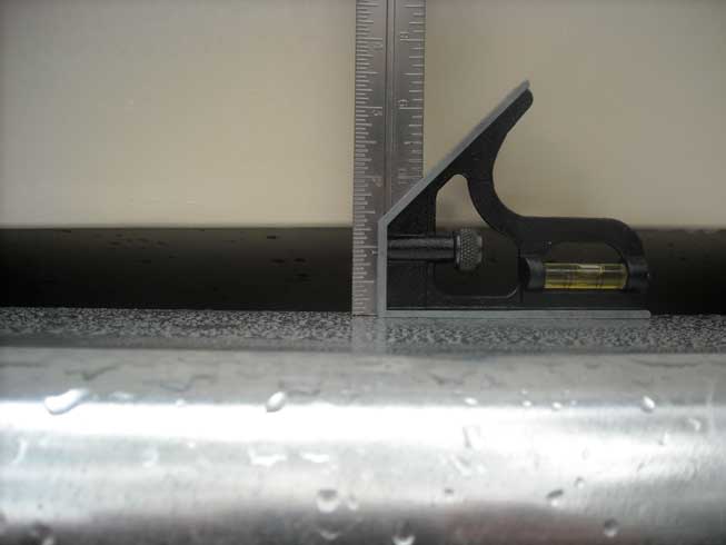

I added a second roller to the center and forward cross members, using existing u-bolts on the front rollers (with added u-bolt plates) and 4 - 1/2" bolts and plates on the center roller. Since the bolts are now over and under the crossmember there is no way for the roller plate to slide. If the hull comes down hard, the roller should bear the brunt of the impact now.
I added a bow stop and moved the winch post as far forward as I could, and raised the winch motor up. Previously the pull was a bit downward.
Center roller
Forward roller
Before and after, bow stop and winch post move

Your new set-up with tandem keel rollers looks much better than the original trailer rigging. You have made a big improvement. I like this view:
Another HINT: if you need to raise the keel rollers higher on a cross member than can be reached with the retaining bolts going over and under the cross member, drill a hole in the cross member for the lower bolts. Drill the hole in the cross member exactly on the vertical center of the cross member material. A hole drilled there causes the least weakening of the structure of the crossmember. When you have a hole in the vertical center of the cross member you can then raise the keel roller bracket a considerable height above the cross member.
Also: on your trailer the front crossmember is smaller than the others; you could move it so it rests on the top of the trailer frame instead of hanging below the frame. That might put the keel roller bracket in a good location.
Re: Trailer Set up for 21 Outrage with bow pulpit on steep ramp
Postby jimh » Thu Jun 30, 2016 2:08 pm
Also: I really recommend finding the optimum amount of immersion for the stern. On my trailer I have two tall guide posts at the very aft end of the trailer. They are marked with some tape to indicate the preferred amount of immersion of the boat into the water when launching. At a ramp, I back in until those waterline marks are just at the waterline. Then I stop, get out of the truck, and move to the trailer winch to release the boat. The usual outcome is the boat wants to slide off the trailer bunks, and it lets itself off the trailer rather politely. If I immerse the trailer too deeply, I get a lot of downward pressure at the bow, and the boat may actually be harder to push off the trailer because some of the hull is being pressed onto the bunks.
When loading, I back in less; leaving my marks an inch or two above the water line. In this way when the boat comes onto the trailer is is not floating at the stern, rocking between the bunks. It tends to stay right on center. As I crank the boat onto the trailer, I may stop, go back to the truck, and back in another foot or so. This makes the cranking easier, but the stern is still not afloat.
My trailer set-up has three keel rollers: a tall single roller at the bow, and tandem keel rollers on the most forward main cross member. I will have to take some newer pictures of the trailer. All the ones I have are about five years old and don't show the latest improvements.

Another consideration for the set-up of a trailer with a Boston Whaler boat is the clearance between the trailer fender and the hull chines. The lower the hull can be set onto the trailer the better in all aspects. Lower boat height on the trailer leads to:
--lower center of gravity of the boat and trailer, which improves stability on the highway when towing;
--faster buoyancy of the hull as the trailer is immersed, which makes launching and loading easier if the ramp water depth is limited; and,
--easier entry into the boat cockpit when the boat is on the trailer.
The standard boat trailer has a maximum width of 102-inches or less, due to a need to comply with maximum width for highway travel without needing an over-wide permit. The trailer fenders typically project inboard at least six inches. This gives a maximum width at the fenders of not more than 90-inches or perhaps less. The result is most Boston Whaler boats of 18-feet length or more will have a beam that is wider than the space between the trailer fenders. The outcome these physical limits means the chine-line of the hull will have to sit atop the fenders.
The closer the hull chine-line can sit to the top of the fenders, the better the outcome (for the reasons mentioned above). A few years ago I re-worked my trailer set-up to lower the boat's position on the trailer by about 1.5-inch. This modification was done while the trailer was getting new fenders installed. The outcome was very good. The clearance of the chine line to the fender top is now about 1.25-inches, as illustrated in the image below:
The hull chine-line clears the trailer fender by 1.25-inches.
I have seen other Boston Whaler trailer set-ups with even less clearance. Don McIntyre's OUTRAGE 21 and trailer have the least clearance I have seen; only about 0.5-inch (or less) separates the hull chine line from the trailer's fender on that rig.
