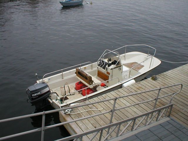

Here is my old setup:
sitting ready.jpg (55.36 KiB) Viewed 7401 times

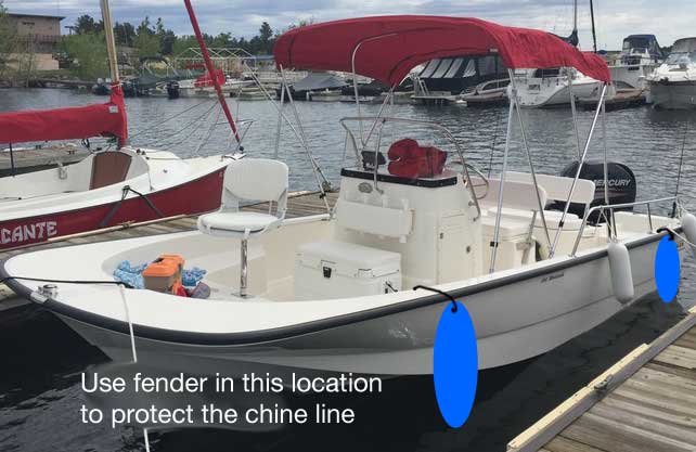

On any Boston Whaler hull you need a good fender forward to protect the chine line. At the bow, install two dedicated smaller cleats on the inwales. Find a location with some backing material. Use another fender at the stern, about a foot forward from the transom.
Re: Where to attach fender with no bow rails?
Postby jimh » Wed Jun 14, 2017 2:28 pm
Your tie-up to the dock (as shown below) was terrible. The boat would have been damaged as the chine line near the bow abraded on the dock. You used very good judgement in not leaving the boat unattended like that.
