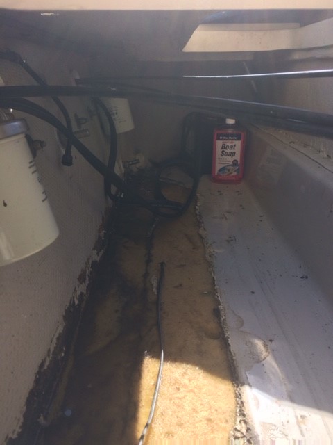

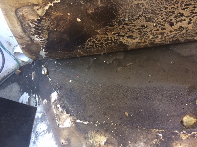

From the look of the foam that is under the cover of my unused internal splashwell, I suspect water has been living in there for decades. Well I guess LHG was right. Larry always said to get rid of that stupid cover and dig out the wet foam out.
I will use this as a bit of an experiment. I am going to let the surface of the foam dry out (very hot here this week) and after the surface is fully dry I am going to drill a core through the foam and how far the moisture traveled. I will be good test of never disturbed c.1980 foam.

I have a Boston Whaler 22-foot hull with a Whaler Drive. The hull has the unusually deep engine splash well that was used on the 22-footers until c.1990. There is no sign of water intrusion into the foam-filled splash well. I suspect that the tendency for water to accumulate in the foam that has filled the deep splashwell is related to the integrity of the seal and the amount of water that has been splashing into the area. Accordingly, for many years I have been ignoring the advice offered by LHG to disturb the cover and seal and to remove the foam.
A further argument against removing the foam: there is no through-hull drain for the now-exposed splash well, and water WILL accumulate in the open and deep well. This will require installation of some sort of pump to lift water out of the well and push it overboard. Typically such a pump will never remove all the water in the well, so there will be a tendency to always have some water in the exposed splash well.
Based on the pictures you show, it looks like there has been some mildew or other discoloration in the region of the splash well. I think it is fairly typical for some foam to cure and then age with a dark brown color. I see that same coloration in the foam that surrounds the fuel tank on my boat.

I too agree that the real problem here is the sealing of the StarBoard cap. If water never got under the cover it would be dry right now.
I think the flaw here is that the factory did not seal the cover well. The floor scuppers do drain into this zone the factory should have treated this area as critical to protect. The caulking is minimal at best. Also they put the sealant over the foam is a few spots (vs the well edge).
My real interest now it to see if foam is soggy all the way to the bottom of the well or just surface moisture.

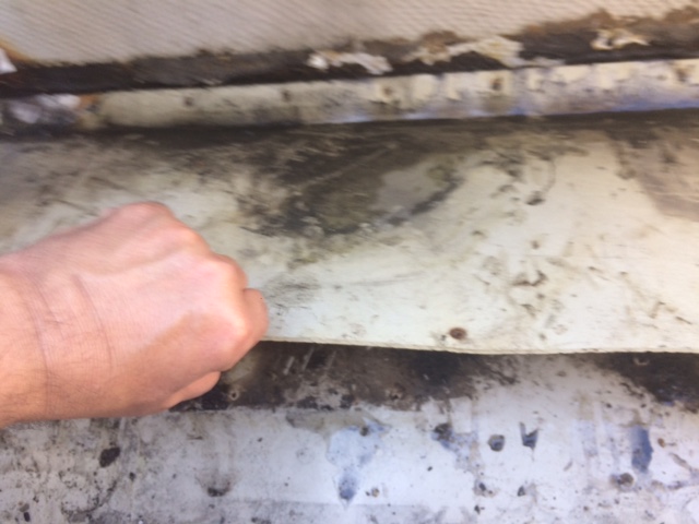

[The foam-filled deep splashwell on the 25-foot hull with Whaler Drive] cleaned up easily with a scrub brush and the foam is now that nice yellowish color.
My current thinking is to just glass over the well after I confirm the foam is not soaked through. The original starboard cap is scalloped on the front and really can't be reused (no way to bed it down). Clearly the bad sealing in the factory let water flow under the starboard and over the foam. There was a coating of black "organic" sludge on all the foam's surface.
By glassing-in the splash well, I can be sure that no water will enter, and [the boat will] keep the [amount] of flotation the original design intended. As Jim points out, just washing down the deck would flood the old well (if I removed the foam) since the scuppers just flow into that enclosed area and I would have to pump it out after each outing.

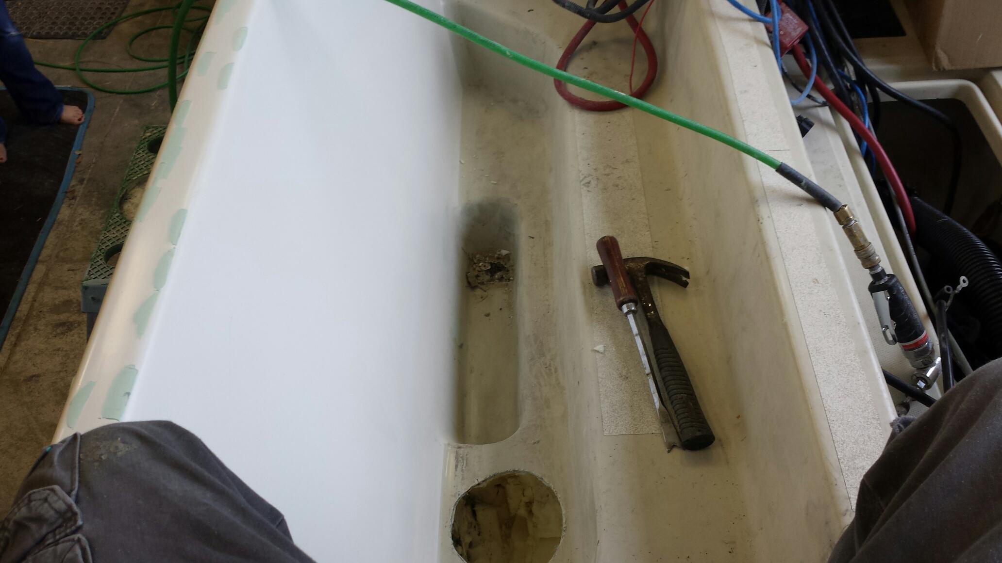

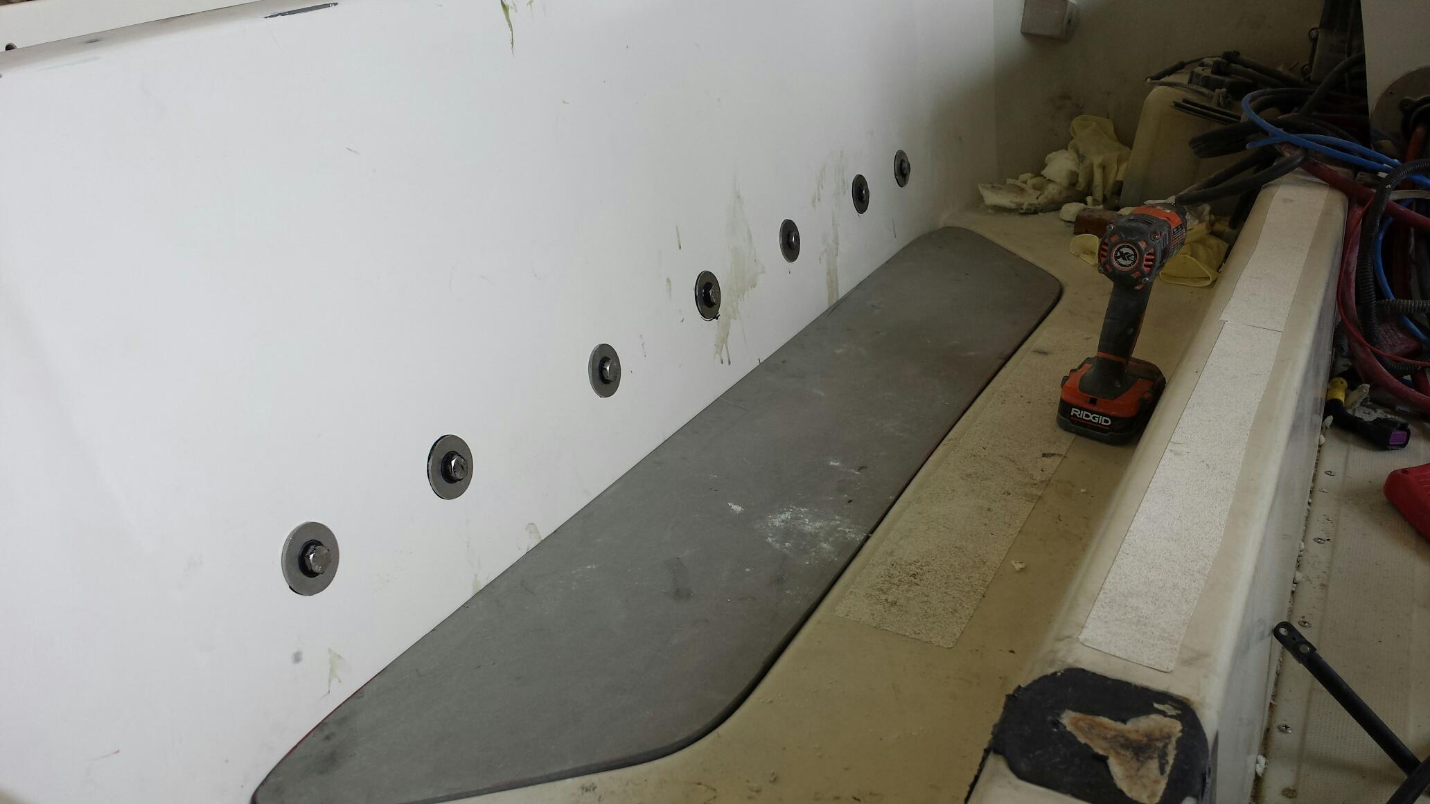

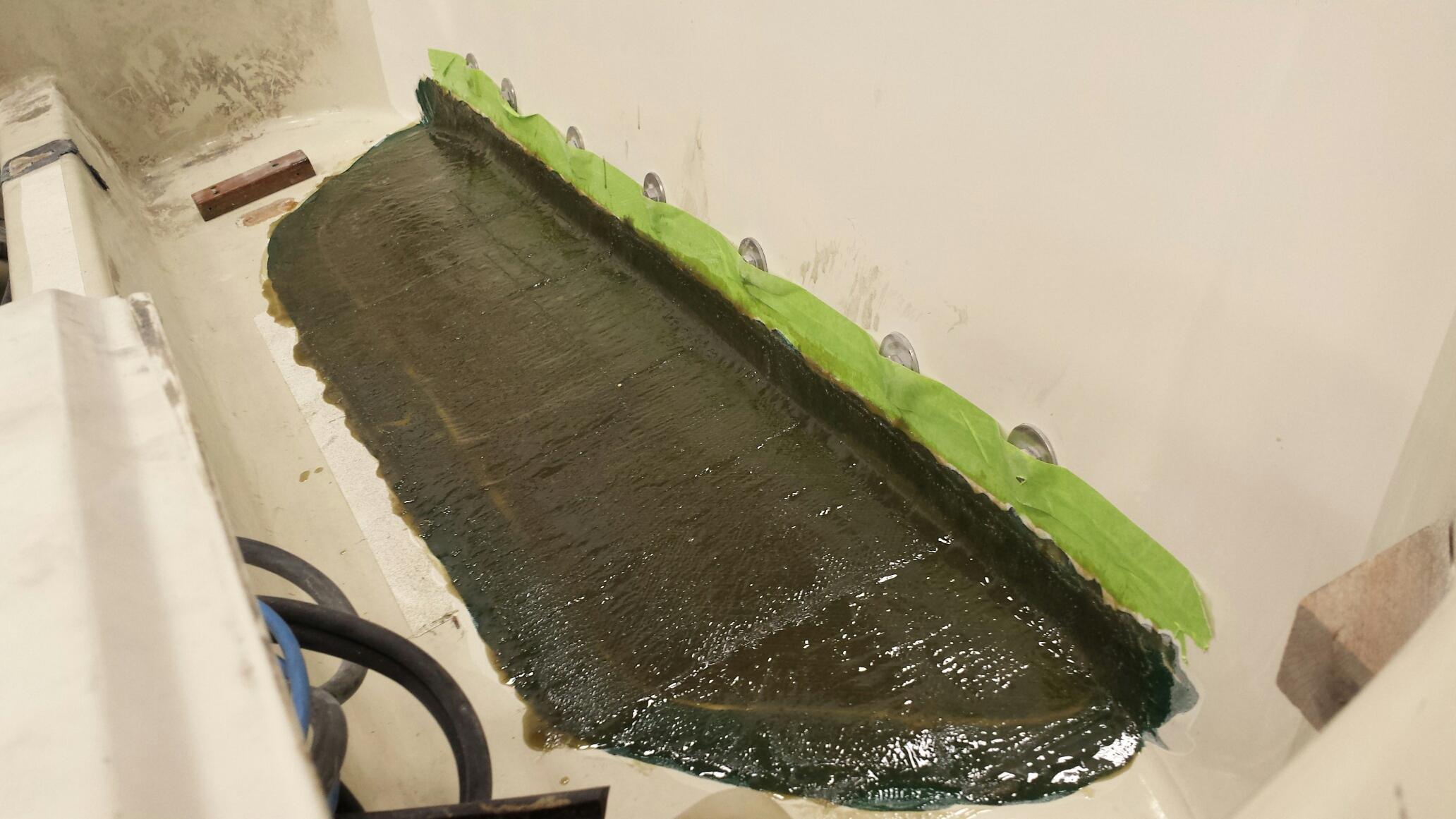

Here are pictures of [my OUTRAGE 25 with added Hermco engine bracket] before and after [the original engine splashwell was] glassed over.
Existing splashwell with new transom built up: http://continuouswave.com/forum/download/file.php?id=1076
Fitting Coosa board to the area: http://continuouswave.com/forum/download/file.php?id=1077
Glassed over but not yet finished: http://continuouswave.com/forum/download/file.php?id=1078
We walk through there all the time, so it was very useful getting the deck flat. And [the unused splashwell ] now sealed just like the rest of the boat, so no more water intrusion.

Russell--how thick was the Coosa Board you installed?
russellbailey
- Posts: 99
- Joined: Tue Nov 03, 2015 11:03 am
Re: Unused Splash Well on Whaler Drive Boats
[The COOSA board thickness was] about 3/4-inch.
