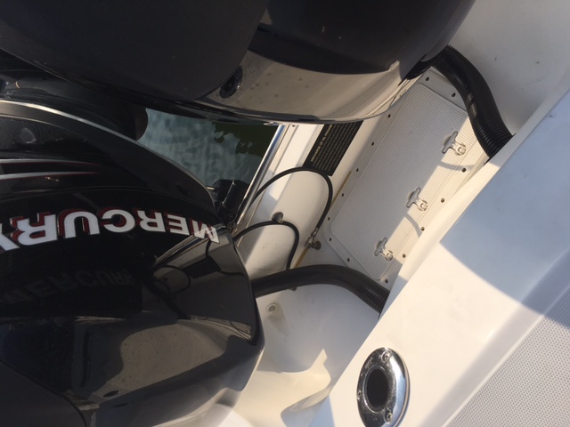

This hose nut assembly [which can be seen in the image linked below] was loose and some oil leaked. I'm assuming either steering fluid or hydraulic for the steering ram. It looked like hydraulic. I don't know how much leaked out. How can I check fluid level and add if I have too?
I went on Whaler web site, I couldn't find corresponding dwgs,
Thanks for the feedback.
[To view the image with better orientation use the link below:
http://continuouswave.com/forum/download/file.php?mode=view&id=2415

Usually a Boston Whaler boat is delivered with an owner's manual which will include the owner's manuals for any major accessory items, such as the hydraulic steering helm pump. As others have noted, the hydraulic fluid level is normally checked at the helm pump, which is typically the highest point in the hydraulic system.
The drawings available on the Boston Whaler owner's resources website usually are not reproductions of the owner's manuals for accessory products, but instead show the assembly details of the boat. Advice on maintenance of the hydraulic steering system should be found in the OEM manufacturer's owner's manual, not in the Boston Whaler boat owner's manual.
ASIDE: when taking photographic images with your smartphone camera, don't hold the camera with an orientation for a portrait aspect ratio or with an inverted portrait aspect ratio if you anticipate using the image as an in-line image in HTML. There really is no way to correct the image orientation using in-line HTML, and your image will appear, as it does here, with the wrong aspect ratio, making viewing the image difficult and disorienting.
