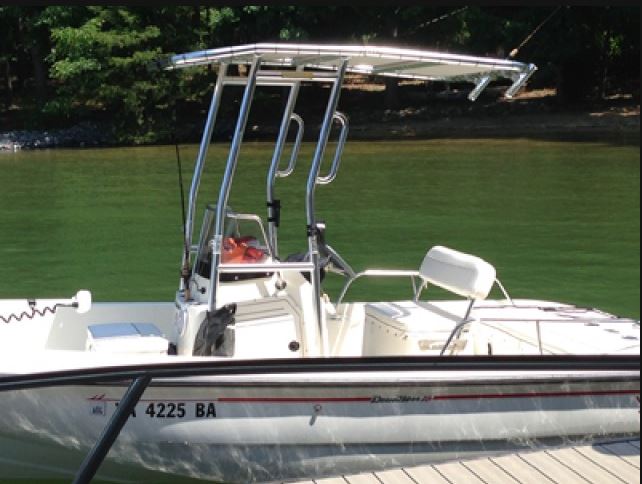

The some T-Tops fit very close to the console. I believe that most of the weight will be directly over the console area so much closer to the bow, possibly adding a small benefit of some additional weight forward:

In the photos it certainly appears that much/most of the weight is at the console but I wonder what factor, if any, the leverage exerted by the cantilever toward the stern may be involved?

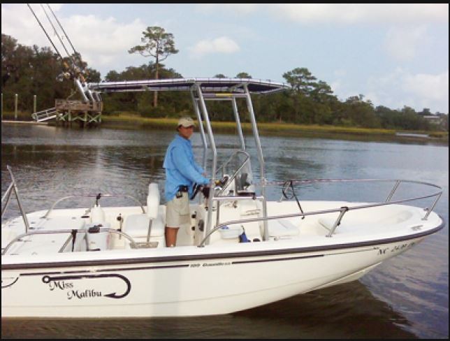

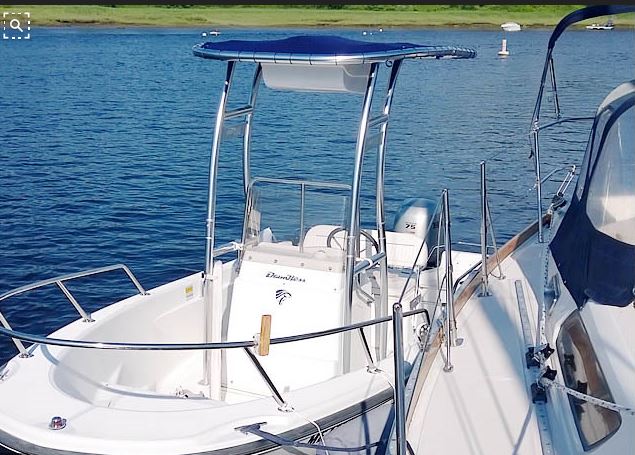

Besides a custom made T-Top two of the most popular after-market brands are:
Fishmaster: https://fishmaster.com
Stryker: http://www.strykerttops.com
In general after-market T-Tops are not that heavy as stated in the FAQ section on Fishmaster's site "T-top with fabric weighs right at 75 lbs with 4 rod holders attached". Both the manufactures have installation videos:

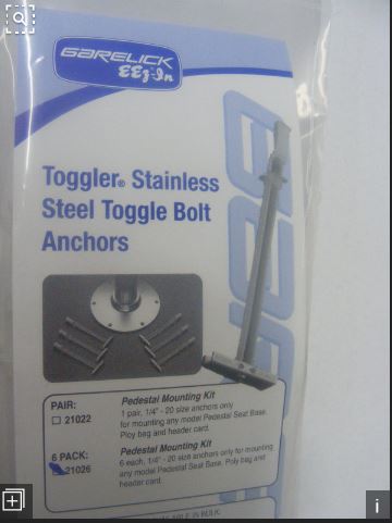

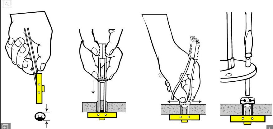

I have helped a friend install an after-market T-Top and as Jim notes there are not any backing plates in the deck that Boston Whaler would install for a factory installed T-Top. When I helped with the install we went a little different route than both of the above video's. Instead of just screwing the base plates to the deck we used marine 316 stainless steel toggle anchors, slightly tricky with a foam core, that we completely bedded them in 3M5200. About 5 years later the T-Top remains rock solid. Both manufactures listed above use cross stand-offs that attach the T-Top to the center console. This strengthens the mounting and controls lateral movement.

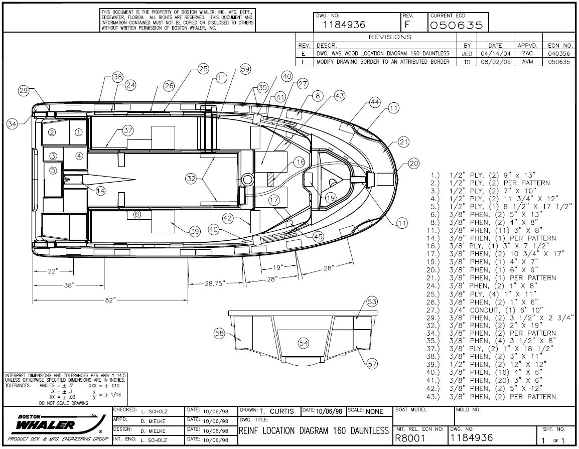

Just to verify, there are under-deck reinforcement panels (#42, 5"x12"x3/8") that might be suitable for the forward legs of a T-top, but no suitable deck reinforcement for the aft legs. They would have to attach to the console or use the toggle-bolt approach mentioned above.

GOLDEN'--you have provided very interesting information. The embedded reinforcements shown at callout-42 are well position to hold the front legs of a T-top. When the boat is making forward way, the wind forces will be attempting to lift the T-top front legs off the deck, and at the same time tending to compress the back legs of the T-top onto the deck. Having strong attachments for the front legs is most important. The rear legs can probably be fastened to the deck with less strength, as they mostly bear compression, not tension--unless, of course, you start making 20-MPH sternway.

I like the toggle bolt idea. Any more detail on how you managed their install with the foam core?
