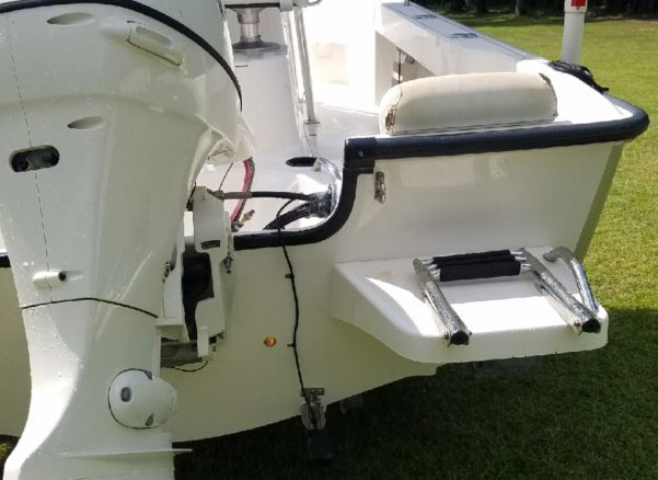

On my [2004 190 Nantucket boat's] starboard side there are two below-the-waterline through-hull fittings right below the swim platform. Both of them were broken where the threads begin, and were pulled inside by the hose that shrank over last 13 years.
You wont recognize this problem since part of the through hull that flush against the transom is still in place and looks just fine. This is an absolutely catastrophic failure for any sinkable boat since water is sipping freely inside the hull by the crack. I experienced this same failure on my 2007 210 OUTRAGE. Why Boston Whaler is not installing bronze or stainless steel through hulls instead of these $5-parts is beyond my understanding,
I understand that cutting cost is part of running a business but there should be no compromise in anything below water.
I replaced [the damaged fittings] with $70 bronze ones--no chance of breaking again.
Be aware of this problem.
The best way to check is to pull the hose as close to the through hull inside as possible. If it moves together with flange it is broken since there is nothing to hold it in place anymore.
Another thing that drives me crazy is black plastic $1-cup holders [ on a boat that costs] $75,000. I Just replaced four with stainless ones for $15.
Not holding in place is another story.
Two circles with electric tape around the edge-rubber mallet and its good for life of the boat.
To fix all the time same problem that are so easy to get it right the first time frustrates me.

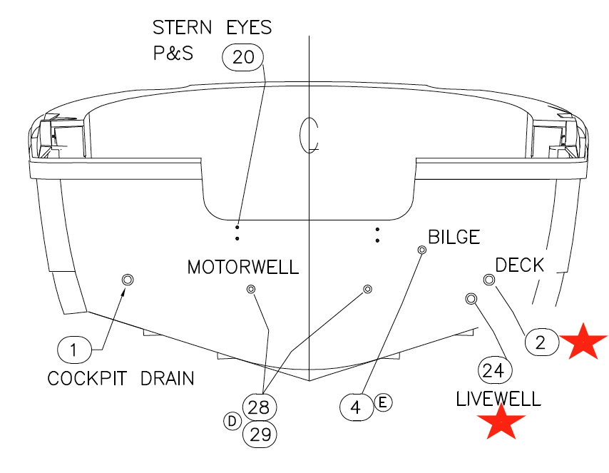

I have two bad thru-hull fittings on our 2004 Nantucket 190 under the swim platform. Best I can tell they are Boston Whaler part numbers 0996538 and 0996546. I would like to find original parts. I have absolutely no luck. I have to look at after-market I guess. Not sure where to start.
Kind of weird that the boat uses a 1-11/32-inch and 1-1/2-inch instead of two 1-1/2-fittings..
Ideas would be appreciated. Thank you.

Postby jimh » Tue Oct 10, 2017 2:57 pm
The through-hull fittings are most certainly consumer-off-the-shelf fittings. If you can identify the manufacturer then you can very likely buy them directly from the manufacturer or one of his dealer-distributors.
To buy them as a part from Boston Whaler just contact Twin Cities Marine in Wisconsin and talk to Sue the parts sales person. This should get you the OEM part, albeit perhaps at a higher price than if you bought it as a generic part from a big vendor like Defender.com.

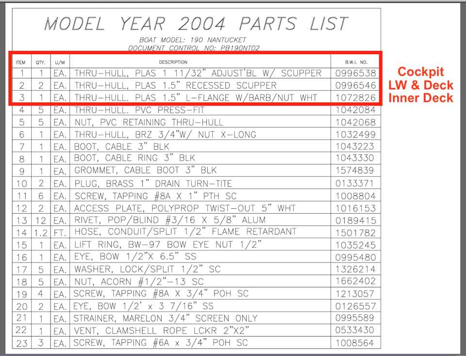

I found the Boston Whaler new numbers for the two bad thru-hull fittings. All fittings were good except the Livewell and the starboard deck fitting. Interestingly they are the only two with [threaded retainer] nuts. All others are press fit.
1772845 [Updated part number]
The fittings are $18 or so each.

Invision -are you planning installing same crappy parts again?
Those two [through-hull fittings] that you indicated are the same ones that were broken on mine.
The hose that shrinks pulls them inward causing a break--it will happen again .
Finding 1.5-inch thru-hull that has extra long thread to pass the sandwiched transom is not easy at all. I had no luck in West Marine [or at] a Mercury dealer that carries many boat parts as well.
I replaced [the original fittings] with Perko 377-B08-PLB Bronze 1.5 inch thru-hull scupper that I found online. [The PERKO part is] not cheap, but I don't want to worry about this again.

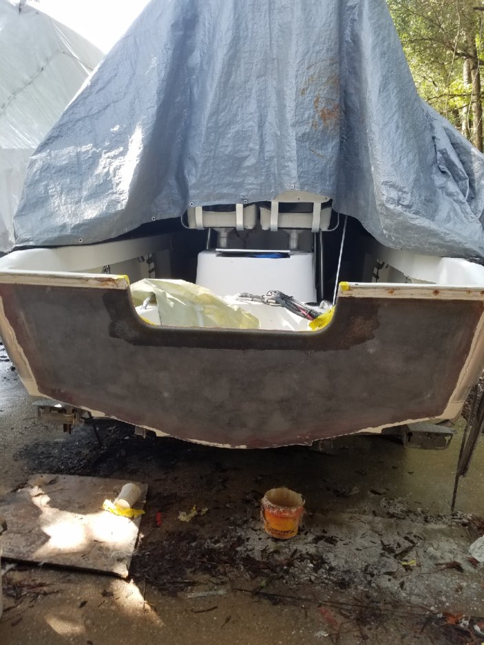

Well I took out most of the thru hulls and guess what I found?
Rotten wood around the starboard side motor well thru hull! It goes about an inch and a half around the hole.
All others seem fine. The transom seems very strong.
I am bummed out and kinda mad but it is what it is.

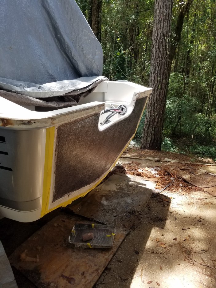

I have to have a complete transom rebuild [on a c.2003 Boston Whaler 190 NANTUCKET]. This will be done at a substantial cost.
I had two boat fiberglass experts look at [the wet and rot in the embedded plywood in the 190 NANTUCKET transom], and they both said the same thing: you could quick-fix it as Chuck suggested, but they believe the rotten wood is more widespread than thought. Complete rebuild is the only way to be sure.
The strange thing is it started around a motor well thru-hull, an area that is not submerged and gets minimal water pass-through compared to other thru-hull fittings.
The person doing [the repair work on the 190 NANTUCKET transom] is highly recommended. Later, I found out he is the one who does warranty work for the area Boston Whaler dealership. He was very critical of Boston Whaler and other high-end boat manufacturers for the way they save manufacturing costs these days. He says he gets calls on brand-new boats all the time.
One thing everybody I talked to said: they never heard of this on this hull. I guess I get the “tallest midget” award.
I love Boston Whalers —and this is my third one—but I have to say I’m disappointed and soon to be a bit poorer.
If your Whaler has plastic thru hull fittings, I s strongly suggest to get them checked immediately, especially if [the hull] warranty [has ended].
I’ll let y’all know how it goes.

I would not replace the entire transom wood. There are a couple of reasons I would go with Chuck Bennett's recommendation. It is easy and relatively inexpensive to do AND that through hull fitting is above the waterline. It only gets wet when the boat is in use, being washed or in wet weather. The fitting is easy to seal after the repair.
After my own few experiences with fiberglass shops I've learned they are in business to make money. They are inclined by nature to exaggerate the need for the most expensive approach. In a way, that's a justified approach because it's less likely to result in any dissatisfaction. And, of course, it puts more money in their pockets.
I doubt that Mr Bennett would recommend a course of action that would lead to further dissatisfaction from a Boston Whaler owner. His goal is happy owners.
I was sorry to read about your problem and hope for a quick, inexpensive, reliable solution. I will be checking the through hulls on our 190 Montauk. The transom arrangement is very similar to yours.

Butch--How I wish I could go with Chuck's recommendation, but the experts who looked at [my boat] are friends with no monetary interest. We found rotten wood under the engine mounts by use of a flexible plastic "drain weasel."
If [the damage were] in the lower corner of the transom I would go with the quick fix, but when the engine area is compromised only way to be sure [of a proper repair] is the route I'm going.
That said, the fiberglass is so thick in the transom it probably would hold, but over time it could break down. I'll never know why Whaler went with plywood over composite non-rot product.

GoldenDaze wrote:This thread scared the hell out of me, so I went and inspected all the through-hulls on my 2003 160 Dauntless. The large cockpit drains were fine and the bilge pump outlet seems fine
The large cockpit drains were definitely NOT fine. Both of the L-flange fittings at the back of the cockpit were loose, and one was cracked. One of the transom through-hulls (with the flapper valve) was cracked and leaking water into the bilge. The other actually was fine, as was the bilge pump fitting. So, more parts on the way.

The modification is nearing completion. Here is a pic of the wood in the transom.
Nantucket owners: your transom looks like this. The dark wood had the consistency of raw fish. The rest was okay. The engine was mounted where the rot was.

Postby Masbama » Sat Sep 01, 2018 2:43 pm
Here is the composite, no rot board
Masbama
Posts: 374
Location: Mobile, Al
Re: Through-hull Fitting Repairs c.2004 NANTUCKET
Postby Masbama » Sat Sep 01, 2018 2:47 pm
The fiberglass work in progress.
Had Boston Whaler used composite board, then this would not have happened.
