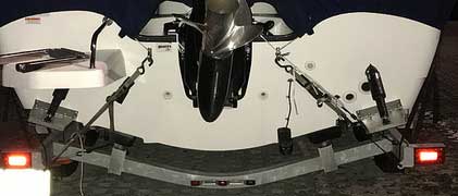

I installed my Lenco Trim Tabs a few months ago and I'm very glad I finally did. I went with the 12x9 instead of the 9x9.
Notice I did not have to go over the transom on my port side, I simply went in a bit closer to the motor. As you can see, my dive ladder is on my port side, vs on the starboard for your model.

I like that installation. Being toward the outside it seems you have better adjustments. If only it was not drilling holes which I hate. May consider having it done at the service shop. Can anyone talk to how much effort is involved in a DIY?

'IVAN--thanks for the nice photos and advice from your installation. I noted the extreme outboard mounting location. The farther out from the keel the tabs are located, the better their effect on changing lateral trim. However, I wonder if having the tabs more inboard would make them more effective with the fore-and-aft trim.

Thanks Jim, the fore-and-aft trim works quite well, I'm definitely able to trim the bow down into the waves on a choppy day and the ride improvement is noticeable. What is really nice is the lateral adjustments, they are very responsive. Another benefit to having them wide is that they are well out of the way of the trailer bunks, so I really don't need to worry about retracting them when I load the boat on the trailer. Overall I think the size of tab and placement was ideal for my needs.

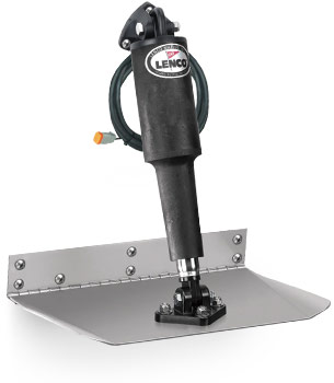

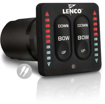

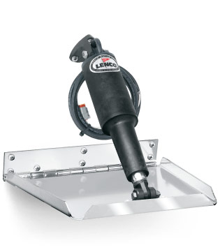

Having some trouble finding OEM trim tabs #1782251. Probably will have to order Lenco 9" x 9". Lenco has two types: standard or performance. Performance trim tabs have rounded sides. I believe that the OEM trim tab did not [have rounded sides]. I read rounded-side trim tabs are better [than non-performance trim tabs without rounded sides].
I plan to use a Lenco Switch model 15171-001. Any thoughts?
Thank You--M

For example, refer to the image below:
View of trim tabs on boat at night
From this image you can deduce that the trim tab is longer than it is wide. This tab is described (above in the article where it was posted) as being
12 x 9.
Based on the image, the tab is 9-inches wide and 12-inches long.
