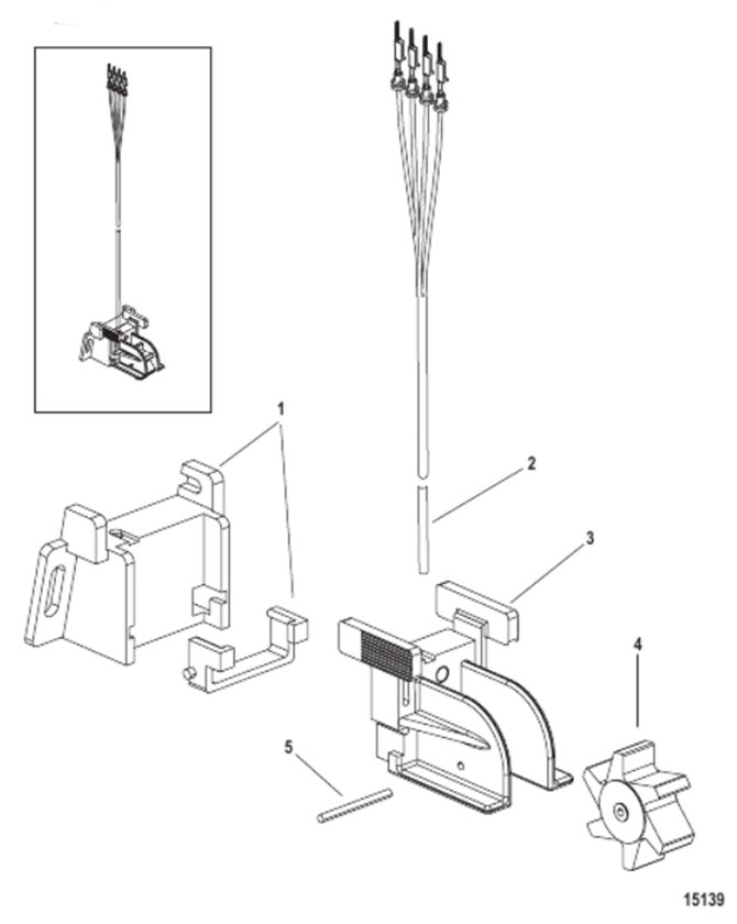

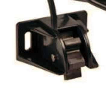

A paddlewheel speed transducer will look like this:

Mine looks like the one under the strap. It has 2 pieces, the mount and the paddle wheel sensor, but no paddle wheel in the sensor. Parts 4 & 5 are missing.
