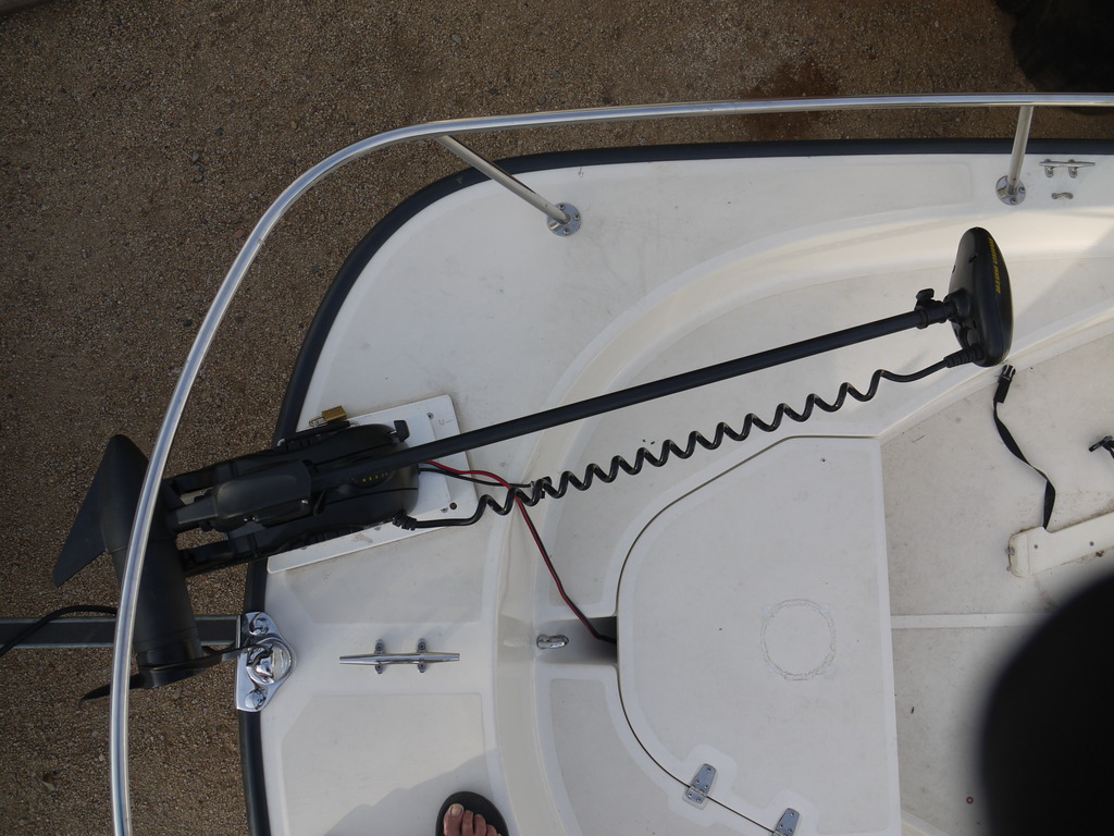

Yikes--that photo-hosting website has turned into a mass of pop-up ads and videos. Here is an image from there that shows the installation mentioned above. I think this might be helpful:

I'm not sure that the manufacturer has a video. This is Dave deploy rather than anything automatic. The motor is slid forward through the mounting, and then swiveled into a vertical position. It misses the railing by an inch or so. There are some compromises. You can't raise the trolling motor to a shallower depth because it would hit the railing. If the boat is only used by a couple of adults for fishing, the railing could be removed. I hope to have some short people (grandkids) in the boat soon, so I'll be keeping the railings. Dave

Thanks for the information and the photo; photobucket is almost unusable.
