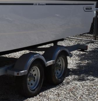

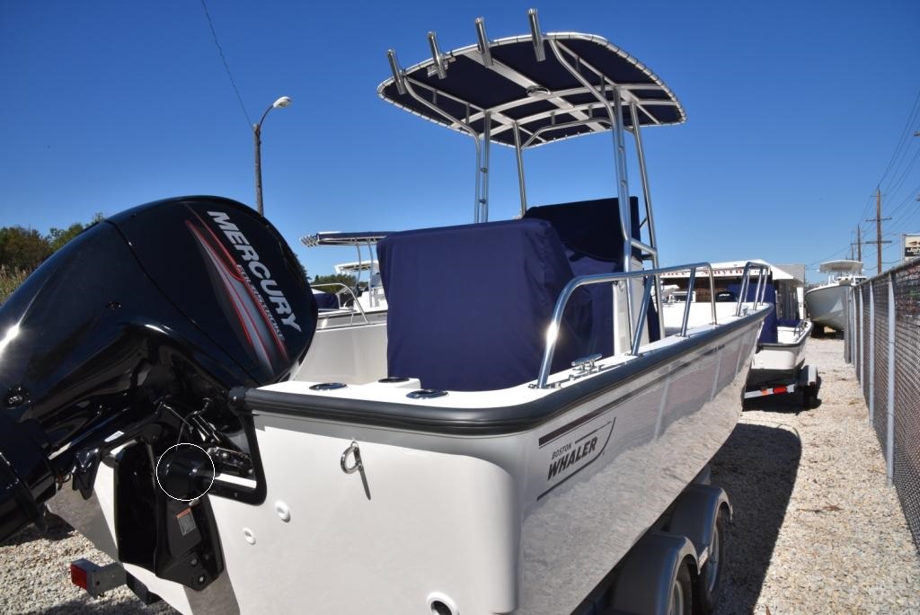

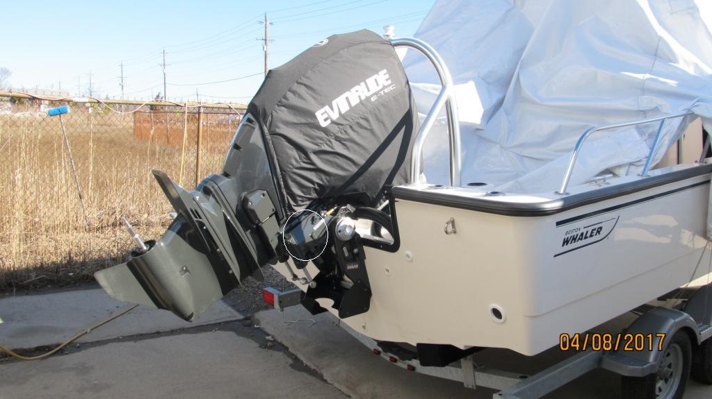

I have a 2016 210 Montauk that I upgraded the engine from the stock Mercury FourStoke 150hp (455lbs) motor to an Evinrude G2 200HO (537lbs). I did not get a chance to tow this boat in its stock configuration. When towing the boat home from the selling dealer to my marina last spring, a 70 mile trip, the trailer would start to drastically sway when I started to go over 50mph. I didn't have time to address this concern last year and the boat on trailer are currently shrink-wrapped and stored at the marina for the winter.
In the upcoming two months I am going to be towing the boat from NJ to FL and need to address this concern. The trailer is the original BW Karavan tandem axle trailer and the tow vehicle is a 2015 Ford Expedition (factory equipped to towing 9,200lbs). My addition of all the components and fuel puts my total weight at ~5,400-lbs.
Where should I start from an adjustment perspective on the trailer?
Should I purchase a trailer tongue weight scale, about $140, and start by moving the axles back by 2-inches and then test it?
As you can see in the pictures the axles are already rather far back on the trailer. I have read that tongue weight will increase an average of 10 to 15-lbs. per inch of moving the axle back.
Any advise on what you think my first adjustment should be and the best way to get my combo correct would be appreciated.

Assuming the sway is because of light tongue weight, The boat needs to move forward on the trailer or the axles need to go rear ward. Or put a few cases of beer in the bow of the boat.
In the picture the transom looks like it is over hanging the bunks rear ward. I would move the boat ahead so the transom is in line with the rear cross member of the trailer. Unless your boat is weird bunk fit should not change. If that didn't fix the sway then the axles and or beer thing.

Although not completely clear, in the small image of the boat and trailer it appears that the boat transom is just aligned with the end of the trailer bunks. If that is true, then the boat position on the trailer looks correct with regard to the bunk position at the transom.

Thank you Jim for all the information and insight. You are correct the stern of the boat is perfectly even with the end of the bunks. I do think the cause of the sway is that the E-TEC is positioned a bit farther aft than the original Mercury outboard. Weighing about 100-lbs heavier (the E-Tec power head also holds about 2.5 gallons of XD100 oil), plus the fact the E-TEC has a farther set-back and pivot point (almost like a 5 inch jack-plate) is probably causing more of a cantilever effect. As you can see in the pictures below, the centers of gravity of the powerhead are different, the Mercury powerhead is positioned more towards the interior of the boat compared to the E-TEC, changing the center of gravity. I have no-doubt that the standard factory set-up towed correctly.

With my E-Tec's setback this must have compounded the fishtailing.
