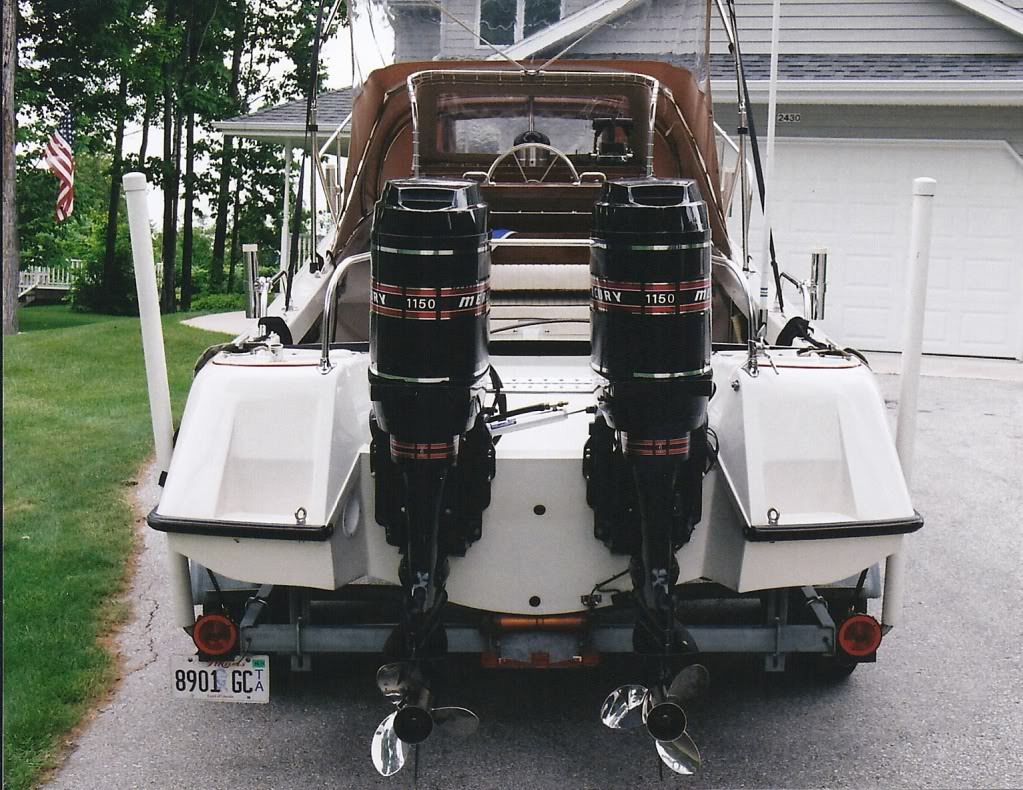

Larry (LHG) has eyes on the back of his incredible Outrage 21. Given the authenticity of his boats, this is the factory location of the eyes.
Photo from his collection:

That’s a beauty all right. My boat has a slightly different configuration at the swim step. But I guess I could do similar on one side and attach to the kicker bracket on the other. Thanks!

I don't see any evidence that the method for installing towing eyes on an OUTRAGE 21 as used by Larry Goltz is particularly authentic. To me it seems inappropriate. The load on the eyes when used as TOWING eyes is going to be at 90-degrees to their mounting. That is always a BAD DESIGN. The eyes would be subject to a force at 90-degrees, a turning moment. Boston Whaler is not known for providing bad designs in their boat. On the other hand, perhaps this was the best solution for that hull. I don't have any evidence that this is particularly NOT an authentic installation, but it does not seem particularly well-conceived, to me.
A second problem is that Larry Goltz has never towed anything with his OUTRAGE 21. He does not participate in watersports like water skiing or anything similar. In fact, in years of boating with Larry, he never wore swim trunks or even got into the water, never mentioned anything about towing a skier, never showed any interest in water skiing. If you are seeking advice for an installation on an older OUTRAGE 21 involving towing or water sports, Larry is the last person I would use as a source of information.
