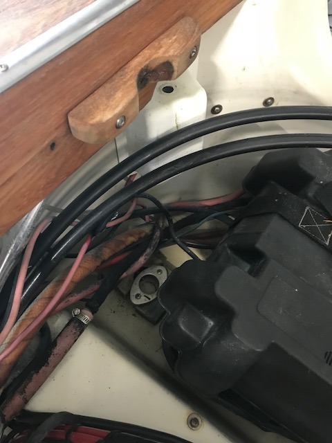

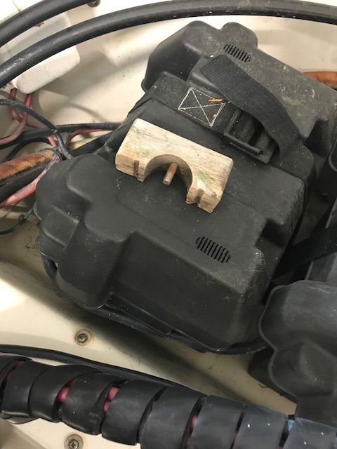

Thanks. I took [three] picture. I think I see the pin you are talking about. It is in the wood that was fastened to the floor which looks like it broke.
Is the wood at the bottom supposed to be on the gunwale?
Is the metal bracket on the floor in the wrong location?

Figure 1: a teak block fastened to the wooden inwale, but the metal ring assembly is missing. This would be the upper mounting bracket. Below the upper bracket is a lower socket in a teak wood base. That looks normal.
Above shows some awful rigging. I see fuel hoses with in-line splices, with battery cables entwined around them. That is a good way to set fire to the boat.
Figure 2: a teak block that has fractured and shows only a portion of the original wood assembly, laying on a battery box. The other missing portion is not seen in the image.

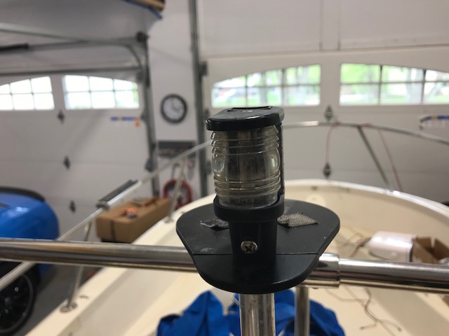

Figure 3: a MASTHEAD lamp apparently mounted at the center console. There is a shade below the lamp to prevent the light from hitting the helmsman. It looks like the lamp is oriented backwards. A MASTHEAD LIGHT is supposed to show forward, not aft.

I have both portions of the wood on the floor. The other piece must not have been visible. Is there another pin I'm missing for the top bracket?
I can flip the console light.

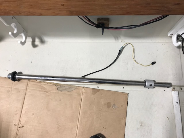

Where is a picture of the pole for the lamp that mounts in the stern? Show the bottom of the pole. Show where the electrical cable exits.
