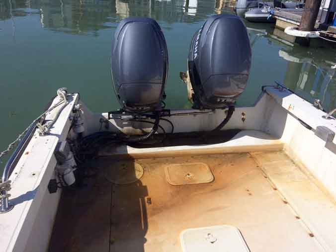

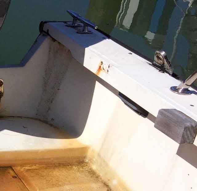

Hi there. I’m trying to trace wood backing plates for clear positions on my Boston Whaler boat refit [on a hull initially identified as a 1994 Outrage 22 but later possibly identified as a 1994 21 Outrage but having an appearance that does not match the Boston Whaler documentation].
The cleats were previously mounted on deck, and I have noticed that a lot of Boston Whaler boats have them mounted on the [inwhale] under the gunwale.
[Seeks] any information on [the location of cleats and the location of wood backing plates].
I have researched the usual websites, and all the drawings of my boat [have] been removed.
Regards

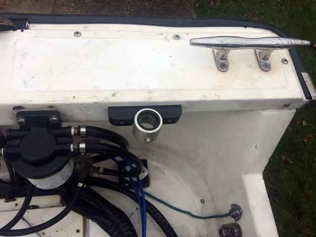

Here is a photo from the catalog showing the stern of the Outrage 21. I see the cleats on the top of the cap. If there is no wood, you should add aluminum backing plates. They should be through bolted.

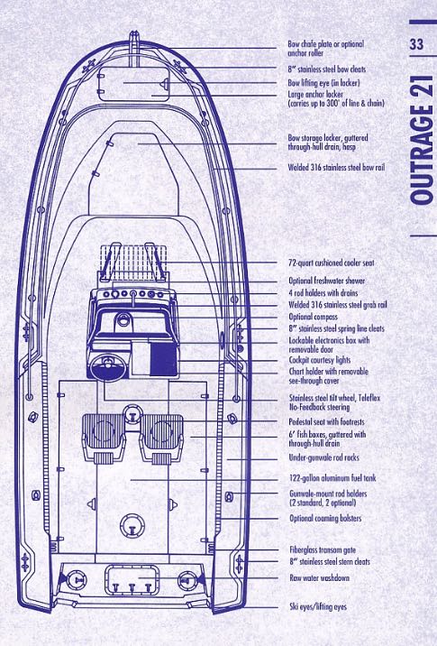

Here is the top view showing all the cleat locations

Yes it probably is a Outrage 21, however the gunwales look different to mine.
I have done a tap test. There seems to be structure around the bulkhead just forward of the transom.

Postby Willie B » Thu Jul 12, 2018 12:34 pm
Fig. 1.
Fig. 2.

Ok thanks. So can the cleats be mounted on the side wall?

In the images above a lifting eye seems to appear on the hull, forward from the stern cleat and just aft of the rail base. A lifting eye would be appropriate on a military-use hull.

Also the deck layout is different to the plans of the Outrage 21 deck plan above.

The lifting eye looks like rather fancy stainless steel, appropriate for a yacht.

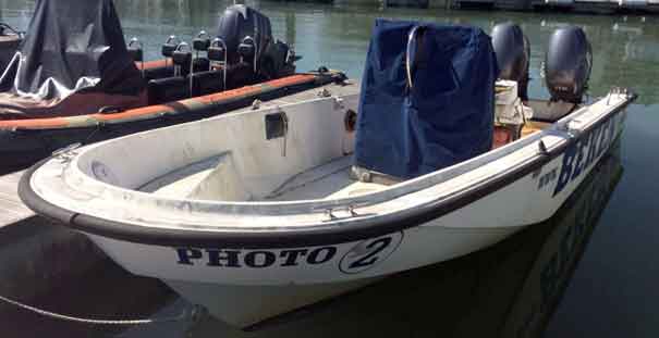

Show us a wider view of the hull to aid identification.
Re: Wood Location Diagram and Cleat Location

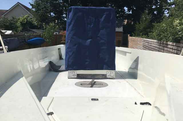

Postby Phil T » Fri Jul 13, 2018 1:38 pm
Fig. 3.
Fig. 4
Fig. 5

Postby Willie B » Sun Jul 15, 2018 10:26 am
Any feedback on upwall cleat positions?

That boat looks more like a classic Outrage V-20 hull, and not a 22-foot hull.
