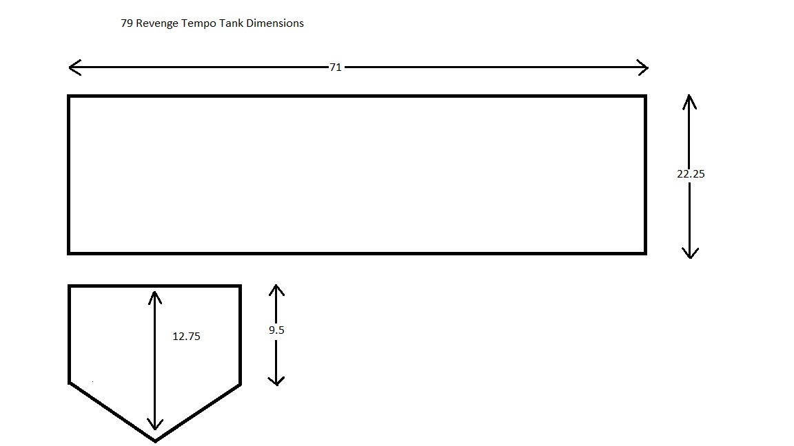

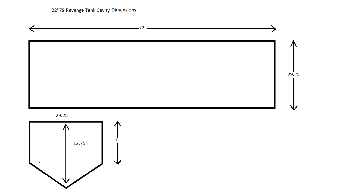

I restored my plastic tank on my 1979 revenge just a few months ago, and did write down the dimensions of both the tank and compartment.
Tempo Tank dimensions.png (9.44 KiB) Viewed 30673 times
22 Revenge cavity dimensions.png (8.61 KiB) Viewed 30673 times
If you would like to see what the cavity looks like, and a few of the modifications I made to the fuel tank cavity, please visit my shutterfly page.

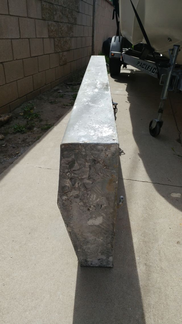

[Describing the shape of the fuel tank] is not that simple. I have just done the tank on my 1983 Outrage [no length or model designation is given; perhaps this author has an older V20 model--jimh]. The tank and locker are a complex shape. There is not a lot of room for error.
The shop that built my replacement tank resulted in a tank that is about 1/2 -inch skinnier, about 3/4-inch shorter, and about 1/2-inch taller. Yep--after I installed it , foamed it, and sealed it, I found out it was a bit too tall.
There is not a much extra space in there. The tank could have been reworked, if I had not installed it. I ended up modifying the [decl] and the access hatch at the fuel inlet area. The cross-section of the tank is not symmetrical. See below; you might want to recheck your dimensions.

Fig. 1. View of fuel tank showing asymmetrical shape.

IF you look at this pic, https://garys22revenge.shutterfly.com/pictures/132 and this one of the plastic tank https://garys22revenge.shutterfly.com/pictures/123(70 gallons, originally installed in 1979), the tank cavity is indeed symmetrical.
The dimensions on the drawing are nominal. For example the bottom of the tank cavity is rounded, it does not come to a point, and the sides are not quite vertical, angling out. So while the bottom of the tank cavity is 72 inches long, the top of the tank cavity is actually closer to 74.
Looking at your tank, it is clearly not symmetrical.

The tank was originally made by Tempo, since bought by Moeller. If you look at my website https://garys22revenge.shutterfly.com/ you can see lots of pics of the tank and cavity. The tank is not available, and has not been manufactured for decades. I did foam mine in.

The asymmetrical fuel tank seen above in Figure 1 may be from an OUTRAGE V20. The fuel tank cavity on the OUTRAGE V20 is indeed asymmetrical. In the REFERENCE article on the OUTRAGE V20 an illustration shows the asymmetry very clearly. Here is the illustration from that article:
Fig. 2. Older OUTRAGE V20 with fuel tank cavity in view showing asymmetrical nature of the tank cavity; originally from the OUTRAGE V20 REFERENCE article. This cavity shape corresponds to the tank shape see above in Figure 1. However, there is no basis to assume that all 77-gallon fuel tanks for all Boston Whaler boats will have this shape.
