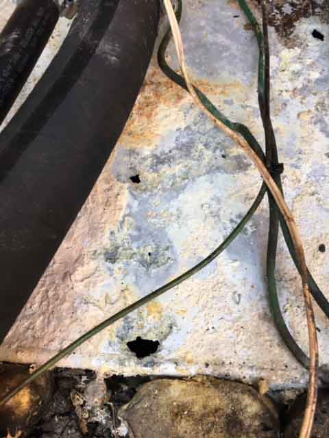

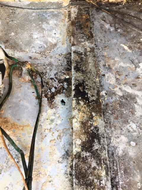

Sadly, I’ve confirm my recently purchased OUTRAGE 22 has a bad fuel tank despite being replace in 2007 with a Florida Marine Tanks (FMT) OEM tank.
Fig. 1
Fig 2.
Now I need to find a replacement tank. FMT quoted $1,300 plus $300 in shipping, and extra for epoxy coating--seems rather expensive. Researching plastic alternatives, no luck yet. Most others on this board haven’t had success either.
