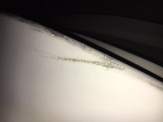

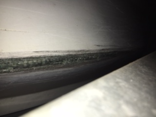

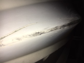

These are the best photos I could take considering where the boat is stored and the fact it is on the trailer. One interesting observation I am not sure one can see from the photos is the fact the "scuffs" have a faint greenish tint to them. Thanks for your help--Reed

Re: 1984 Montauk 17 Keel Repair
The images shows the same damage as you described. I don't see any evidence that would affect the recommendation I made earlier.
