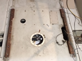

My aluminum is flat. The wood was bolted thru and then the console was sandwiched between to pieces of wood which were screwed together. I have a super console which doesn’t appear to be original since there is a capped rigging tunnel cutout and two rows of screws that were filled. I wonder if the aluminum I have was used to offset the console mount.

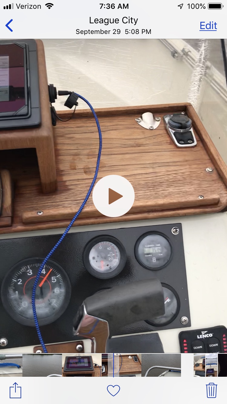

I replaced my aluminum plates this summer with 6061 T6 alloy. I sent the dimensions to a company called Metal Supermarket and I picked them up the next day. I am in Houston but there are other locations across the country. The plates were received cut to size, I just had to bore and countersink for the screws and bolts. The 2 plates were under $20. I also replaced the instrument panel for under $10 as I replaced my fuel tank and it had an electronic sender so a level gauge was required and I reconfigured the panel layout. I also raised the console but used treated 4x4 which I then trimmed in teak to hide. The risers can be replaced without too much difficulty so I used the pressure treated lumber to get the dimensions right and figured if they don't last I'll replace with teak or mahogany. This is a screenshot of my dash.

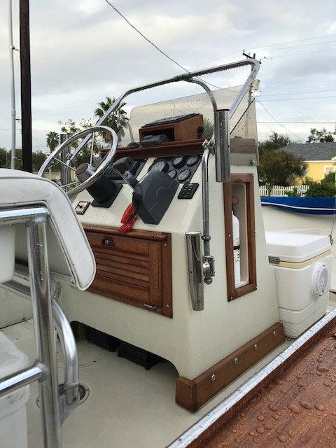

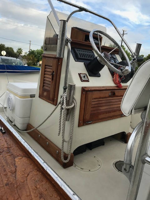

A couple of pics:
- console 2.jpg (130.8 KiB) Viewed 8801 times
- console 1.jpg (96.5 KiB) Viewed 8801 times
