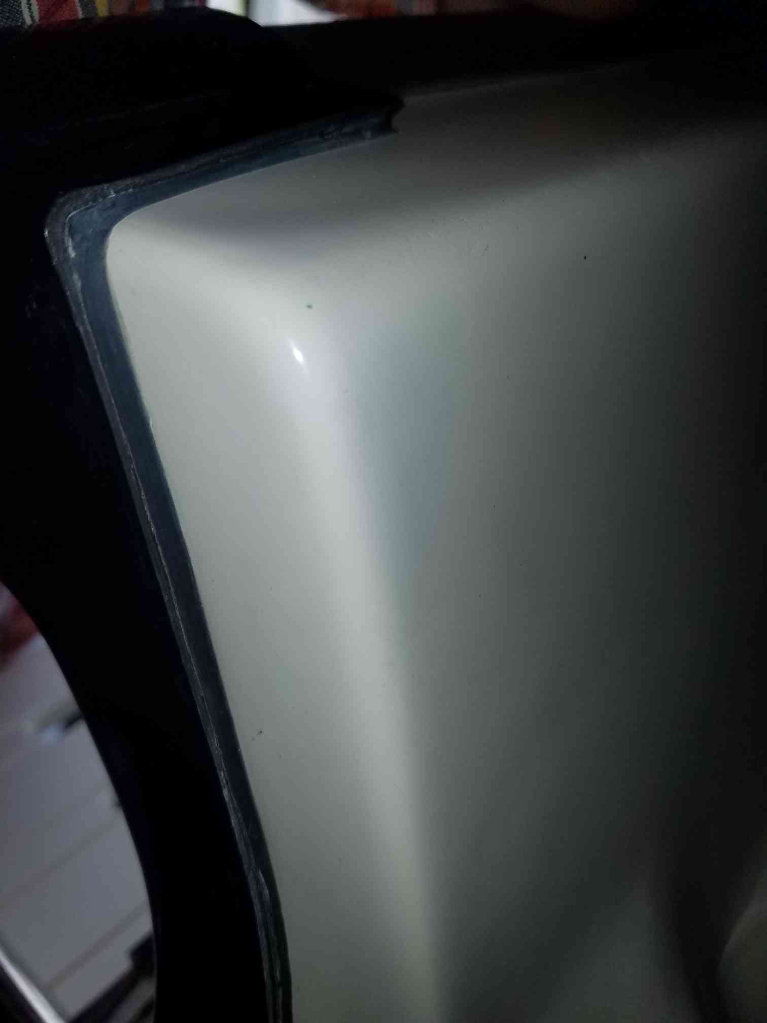

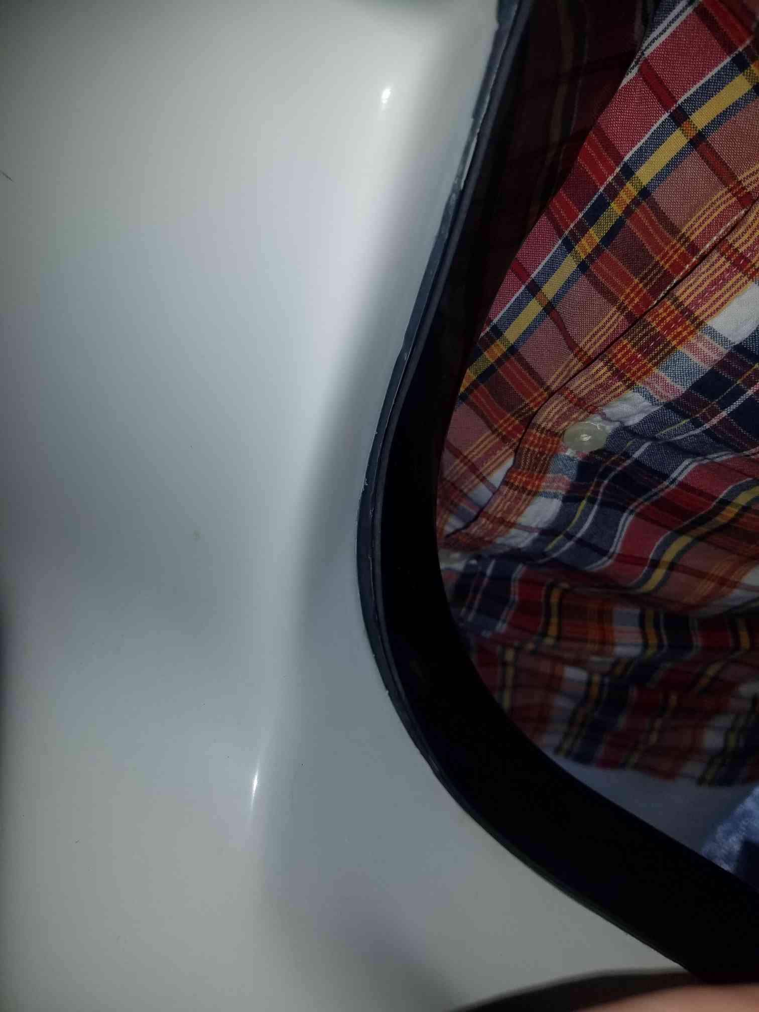

Hi all. [The rub rail on my 2007 170 MONTAUK] looks like the factory put something [a sealant] there.
What sealant would be recommended to repair [the gaps between the hull and the rub rail on a 2007 Boston Whaler 170 MONTAUK]?
Fig. 1. Notice gaps at stern.
Fig. 2. More gaps stern

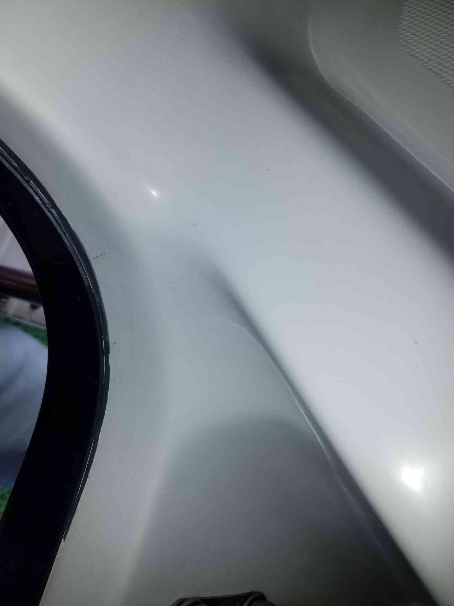

Fig. 3 Rub rail ail looks fine here at stern port side
I found this archived reference article which mentions 3M black sealant, but I want a more specific product recommendation as there are many black sealant options.
http://continuouswave.com/whaler/refere ... liary.html
Thanks.
2007 Montauk 170
Re: 2007 170 MONTAUK: Rub Rail Sealant
Postby jimh » Sun Nov 25, 2018 10:22 am
To discover what sealant brand and type was used by Boston Whaler, I suggest you contact Boston Whaler customer service. I would expect they would be able to tell you the product used when the rub rail was initially applied to the hull.
I suspect that some shrinkage has occurred in the rub rail, and the rub rail has retracted slightly, leaving some of the sealant exposed in the new gap.
I would avoid products noted as adhesive-sealers, like 3M5200 or 3M4200, as they may be too strong and too permanent for this application,

Reply from Whaler:
Boston Whaler uses a black RTV Silicone Sealant from a company called Star Brite Distributing. Their vendor part# for this is 82123. If ordering through a Boston Whaler dealer, the Whaler part# for this is 1039767.
2007 Montauk 170
Postby jimh » Mon Nov 26, 2018 9:53 am
Compare at
http://www.starbrite.com/item/marine-silicone-sealant
This should be an easily-sourced off-the-shelf consumer-grade item.
