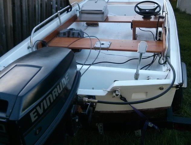

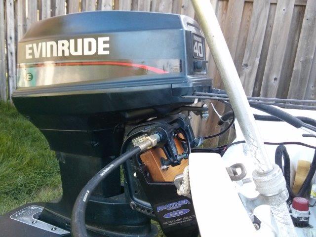

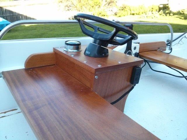

Here are some pictures of the finished project. I ended up finding a new old stock Safe-T rotary steering kit with a 10 foot cable and a steering wheel for $120 on Kijiji. I built a new console for the new steering helm. Since there was some slack with the 10 foot cable, I moved up the console by about 3 inches. I have the 6" setback trim unit so I used the cable through tilt tube method. I also built a new new front seat.

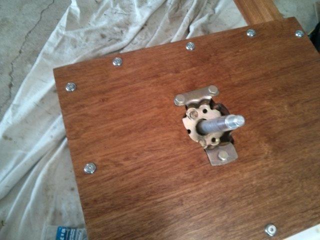

Here is a pic of the steering helm bracket installed.

Nicely done dg. I recently did a similar conversion on my 13

Thanks, there was definitely a learning curve with a few things. Having the old console to use as a template helped a lot and I was able to source mahogany close by. Thanks again everyone for the feedback.

My brother gave me a Boston whaler destroyer steering wheel for my birthday on the weekend. A very nice touch to finish off this project.
