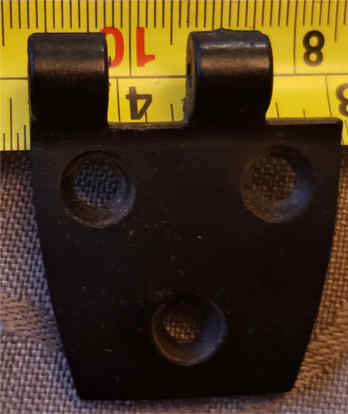

I want to find stainless steel hinges to replace the [black plastic hinges].
There are nine plastic hinges on the Super Sport Limited models, and they do fail as the boat gets older. Three hinges are under each seat bench, and three hinges under the rear seat back.
Fig. 1. One half portion of hinge to be replaced.
[Please do not post links to images that require you to download a 1.2-MB file in order to see the image.--jimh]
Re: 1988 SUPER SPORT LIMITED 15: Black Plastic Hinges
Postby Phil T » Fri Apr 19, 2019 3:14 pm
There is a Perko version that appears to be the right one.
There are two sizes.
https://www.perko.com/catalog/cabinet_hardware/398/hinge/
This is the cheapest price I found. Brace yourself.
https://www.boatersland.com/pko0951dp2chr.html
Postby jimh » Fri Apr 19, 2019 5:41 pm
drewread wrote:I want to find stainless steel hinges to replace the [black plastic hinges].
I was going to say that is a good decision. But with nine hinges and at $66 per hinge, that will be a $600 investment.
Postby dtmackey » Thu Apr 25, 2019 9:01 pm
Look around and you can save a bundle. In the past I've seen them for $5 - $10 per hinge in 316 stainless. Most stainless hardware comes out of China and the markup some companies put on it for the privilege of buying it in their spiffy packaging is insane.
