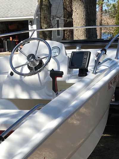

I just installed a Garmin 54cv on my 2018. The size seems perfect. I mounted it next to the console. Do not drill too far and it will not go into the glove box.

Thank you jimh & charig for your suggestions. I think now that the Garmin 54cv mounted to the right of the console is the safest and simplest mounting option. It's also the cheapest since that model has been discontinued but is available for $260. Seeing the photo from charig was very helpful -- I previously installed the same model on my old Whaler and generally liked it a lot, but until seeing your photo, I didn't think it would work as well as it appears to on your 2018 Whaler. So, again, much appreciated.
