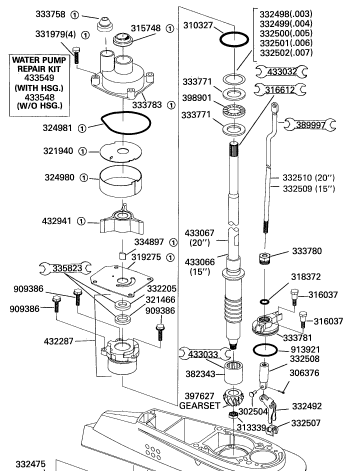

A detailed pictorial drawing of the assembly of the gear case of a 1989 Evinrude 40-HP outboard engine can be found at the wonderful Evinrude web resource at
http://shop2.evinrude.com/
Select the BRAND, the YEAR, the HORSEPOWER, and the MODEL. Then click on the link GEAR CASE. You will see an exploded view assembly diagram of the gear case, including the water pump.
Below in Fig. 1. is a thumbnail view. This drawing may be useful for you to discover the location for installation of different O-rings,
The resources available for support for Johnson and Evinrude products at the website SHOP2.EVINRUDE.COM are extensive, highly detailed, and unmatched.

Re: 1989 Evinrude 40 Water Pump O-ring Locations
Look at the schematic Jim posted. See the two O rings in the shift shaft housing? Do they look like the ones in your kit? I hope they are because it is good practice to change those out when doing the water pump. A couple of years ago I suffered water in my lower unit oil. The prop shaft and drive shaft seals passed the vacuum/pressure tests. But when I moved the shift shaft out came the bubbles. I had to order those seals as they were hard to find. Perhaps because they come in the pump kit and are assumed to be changed with the pump.
