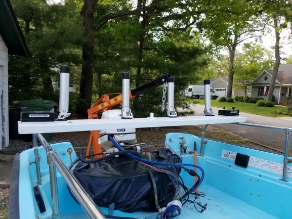

I did just as Jim recommends to accommodate downriggers on my 1966 16. The plank was attached to the side rails with U-bolts.
I limited the length of the plank to the beam of the boat. I found on earlier "prototypes" that if the plank exceeds the beam of the boat it can get hung up on docks. It is a very good thought to make the plank as wide as possible to spread the downriggers as far apart as possible for fishing purposes but it did cause me some problems.
A center rigger would round the spread off nicely- put six foot booms on the riggers and you have yourself a nice spread.
A liked the plank for normal old fishing too- it was nice to have it there for a handhold when doing any sort of fishing. Similar function as a rear rail.

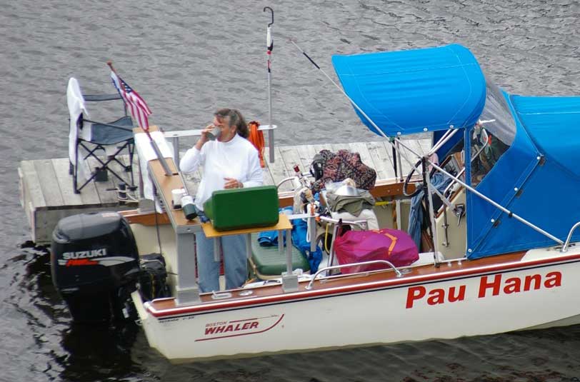

Here is another approach to adding some fishing gear to the aft cockpit of a classic Boston Whaler; perhaps PAU HANA's set-up will give the OP some ideas; if nothing else, it gives the OP a picture.
Fig. 2. Added fittings at aft cockpit of this classic OUTRAGE 20, PAU HANA, create rod holders, working space, mountings for down riggers, and a small table. Seen here in CRUISING mode, not fishing mode. very avid angler Kathy enjoys some morning coffee heated on the camp stove that is mounted on the bait preparation table.

Jim that is a really nice job on PAU HANA. Looks like it was done by a professional or the owner has excellent fabrication skills.
I am in my 50's and constantly bending down to the rail or down to the deck for gear etc. results in a sore lower back at the end of a fishing day. Having things elevated to waist/chest high for access and use makes a big difference for me.
Plus it is just plain fun to make stuff like this.
Rich

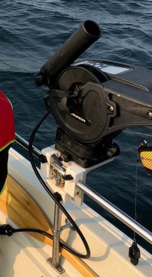

One of the local Boston Whaler dealers has custom brackets fabricated for mounting down riggers on Montauk rails. I'm having similar brackets fabricated for my 21' Guardian, except the base will be an inverted, rubber-lined U-shape so it rests on the gunwales without having to drill holes through the sealed hull.

To clarify, the photos (in Figures 3 and 4) were of mounts custom fabricated for M&P Mercury Sales Ltd in Burnaby, BC. which they offer as part of their down rigger installations for boats they sell and service. I don't think they would sell them separately, but most welding shops could make up similar mounts.

The outrigger assembly was professionally done by the previous owner. When I re-powered with the Suzuki DF-115 in 2004 I had to raise it since the Suzuki tilts up almost horizontal. It has eight vertical rod holders and room for four down riggers, but I can only deal with two.

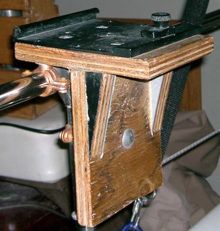

Hoosier
Posts: 150
Re: MONTAUK with Scotty Down Rigger Rail Mounted: Need Pictures, Need Ideas
Postby Hoosier » Mon Jul 08, 2019 6:58 pm
That homemade mount was on our 1986 Montauk, the boat we had before we got the 1978 Outrage V-20. We had one on each side with manual Cannon Easy Troll downriggers. We fish as deep as 60' in Detour Passage at the top of Lake Huron and cranking more than two of them would be too much. Jim is correct, all the hardware came from the local HW store, three pipe clamps, three short carriage bolts, a couple of nuts (including me), and some scrap 3/4" plywood. The wooden braces are important because the downrigger, when deployed, puts a lot of torque on the mount and it'll bend down without the braces.
