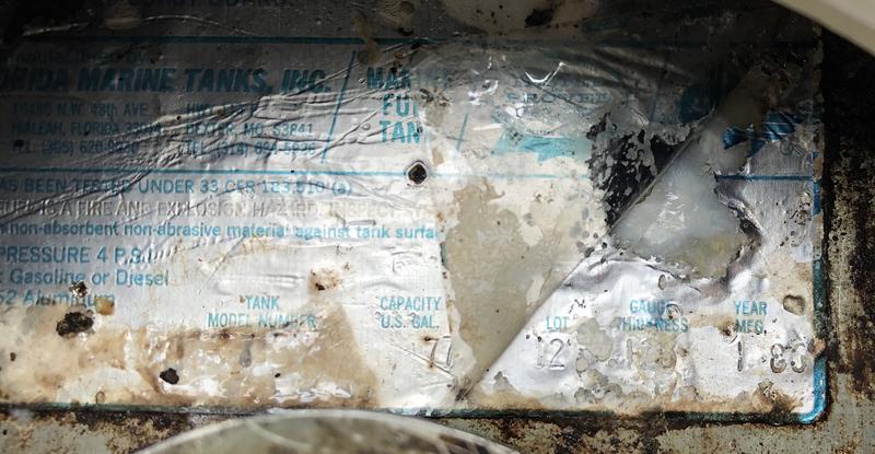

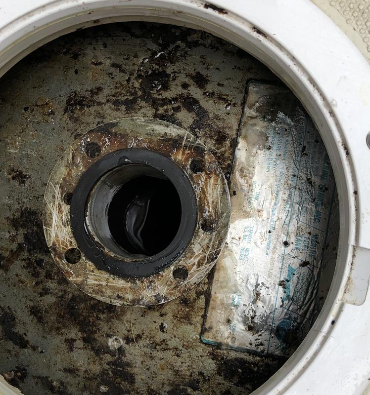

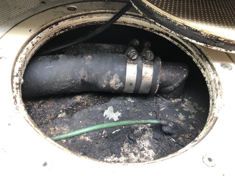

I just took apart all the inspection ports and took some photos. The tank is original (1986)
I removed the fuel gauge assembly and there was a new gasket there from when I installed it in June. I am not sure it was perfectly seated and you can see an outline of how it sat on the underside of the gauge in one of the photos. It definitely wasn't on there perfectly and when I put the gauge assembly back on, I was able to tighten it down more than it previously was. Not sure if water made it in that way or not.
There is a gasket aft where the two pick-up tubes are on the aft side of the tank. I can feel around maybe half of it, but the other half I can't lay eyes on since its not centered at all around the inspection port.
Does anything jump out at anyone with this photos?
Fig. 1. gasket around the two fuel pickups
Fig. 2. fuel gauge assembly removed
Fig. 3. Underside of Fuel gauge assembly
Fig. 4.
Fig. 5. original sticker on tank showing a build date or 1986
Fig. 6.
Fig. 7. Fill and vent hose

ekalb wrote:Does anything jump out...[in these] photos?
Based on the general condition of the tank surface and its attachments, I would infer that the recent ingress of water into the tank area was not the first occurrence of such water ingress. The black coloration may be from mildew. Mildew grows well in fresh water, so the water intrusion was likely from accumulated rain or wash-downs with fresh water.
As a comparison, the top surface of the Florida Marine Tanks 77-gallon fuel tank in my 22-foot hull is a matte light-green paint finish of what I presume is aluminum anti-corrosion primer, and there is almost no sign of black mold or mildew anywhere.
The label in Fig. 5 shows the maximum test pressure as 4-PSI.
What is being illustrated in Fig. 3.?
If captions were added to the illustrations the readers will have a better idea of what is being shown.

I updated the photo descriptions. thanks
