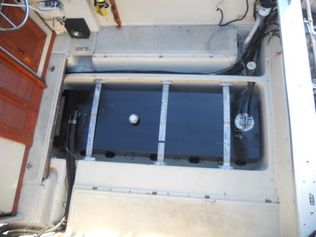

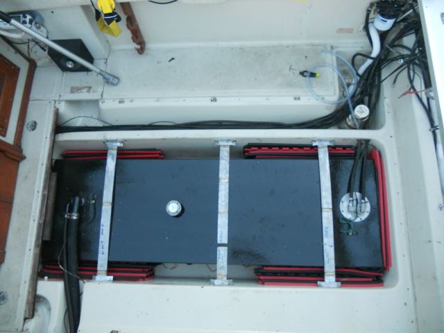

FUEL TANK CAVITY HAS NO FOAM
When I refurbished the REVENGE boat's fuel tank a few years ago I didn't foam it into place. I jammed playroom mats into the side areas around the tank, leaving space for water to run around the tank. Every time it rains it's a simple matter to remove all the standing water. Excess water around the tank washing forwards into the cabin whenever I towed the boat to the ramp has also been eliminated. The flow of water into the cabin sump used to make a mess forward.

I glued a clear hose on the inside of the fuel tank cavity at the aft end starboard wall near where the two fuel lines pass through the wall to the rigging tunnel and sump. I used a 90-degree fitting. I fed the clear hose into the rigging tunnel and sump and leave it curled up in there until needed.

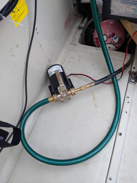

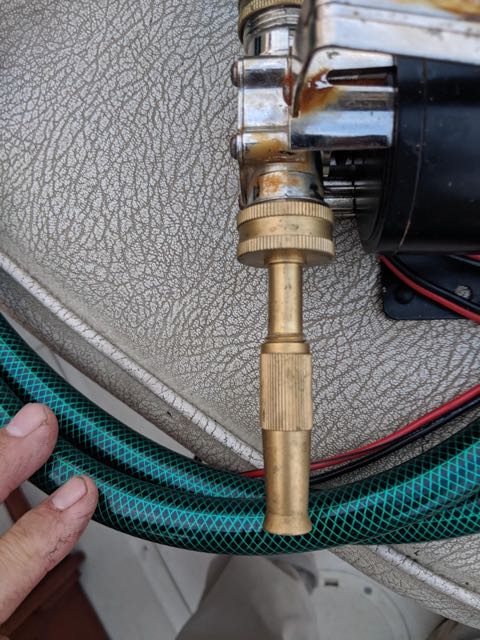

After a heavy rainfall I hook a 12-Volt-operated water pump to the [boat's] battery. I fit the clear plastic plastic hose into a garden hose end that is threaded onto the pump. After attaching to the battery, the pump will drain the entire fuel tank cavity in about 15 minutes.
This pump is from Princess Auto and sells for 70 to 100 canadian. I've had mine for about three years now with no problems.

The pump used was purchased at Princess Auto. I believe you have Harbour Freight down there in the States. It's a simple 12 volt water pump. Costs between $70 to $100-Canadian. As you can now see in the photos, posted with the help of Phil T, all the foam was removed from around the tank. The tank is held in very well by the combination of the straps and the foam Play Room Mats. It's never moved since install. Not pictured is the thin foam/rubber strips the tank originally rested on. The pump is stored in the cabinet under the steering wheel when not being used. Next year I will mount it to a board and fix this board to the starboard wall near the bilge. I will also add a switch and fuse and this will make it more accessible and able to use at any time.
