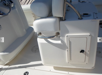

I may have found a "trick" location for the sub. On the helm side of the console, there is a footrest that runs from port to starboard, up off the deck. The underside is angled at about 40-45 degrees and there is between 1.5 and 8 inches of space (less forward) between that shelf and the deck. It's not a very thick piece of fiberglass, but I could re-inforce it on the inside. If I can install the sub there, it would be "invisible", which is nice and would fire down at an angle (haven't considered the reflections) into the area between the console and the leaning post.
Thoughts?

Re: Adding Subwoofer and Amp to Outrage 210
I like the idea—if I understanding correctly—that the loudspeaker will be mounted inside the console into a new and hidden bulkhead, firing downward and aft, and you just make an opening or port in the actual console shell to let the sound waves pass.
Usually a sealed enclosure for a speaker stiffens the speaker cone and surround movement, affecting the natural resonance of the system—to the advantage of moving the resonance lower in frequency where it will be useful and augment the sound output in an advantageous manner. That behavior is why well-designed loudspeakers are built into enclosures.
Certainly a loudspeaker will still produce sound if operated in free air, but putting the speaker in an enclosed cabinet usually improves the sound output in several ways.
That a manufacturer who makes speakers that are sold without any sort of enclosure to be installed in a random manner in boats tells their customers that the speakers will work in that type installation is not surprising, but it does not cancel decades of research and practice in loudspeaker design—or transmute the laws of acoustics.

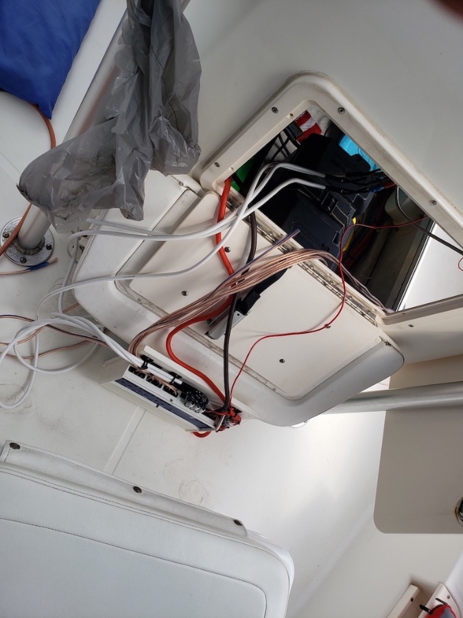

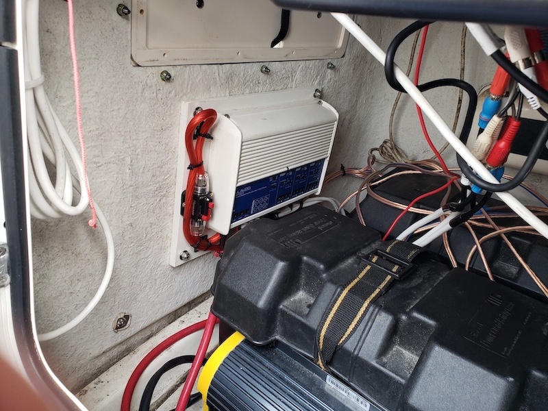

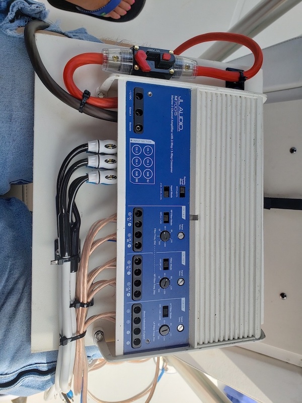

Day one: the project begins.
Today, I cut a PVC board to mount the audio amplifier, circuit breaker and secure all the leads and wiring.
Then I had to figure out where to mount everything, and there were not many choices for location. Originally I was thinking about the starboard side of the console, just above the fire extinguisher. I constructed a template of the mounting board and tried a few other locations, ultimately deciding that inside the console, behind the cooler seemed a better choice.
I removed all the loudspeakers and hooked up the audio amplifier and all the new wiring, including 12-AWG speaker wire to each location. I have not run the rear speaker wires under the deck yet, but wanted to test everything and preliminarily adjust all the settings. I followed the JL Audio guide for adjusting the input gain, but couldn't get high enough voltages on the audio amplifier speaker outputs. A quick call to JL and I was able to download their test tones, which apparently are at the correct signal level.
I hooked up the Kenwood 10-inch subwoofer loudspeaker—leaving it out on the deck—just to be sure it was working. Installation in the rear of the console is for another full day of "enjoyment.”
I've attached a few pictures to show the progress. I still need to clean up inside the console (100 zip ties or so) and re-install the fishing tackle box (above the amplifier).
Hopefully, I'll be able to get the rear loudspeaker wired up properly, clean up the loose wire, and install the subwoofer loudspeaker by this weekend. I'll keep updating the Forum, in case anyone else is considering a similar upgrade.
- Templated and ready to drill
- 20190918_132405_resized.jpg (171.66 KiB) Viewed 26116 times
- Mounted and wired up - ready to test
- 20190918_113002_resized.jpg (182.02 KiB) Viewed 26116 times
- Original planned location for amp
- 20190918_095139_resized.jpg (133.09 KiB) Viewed 26116 times

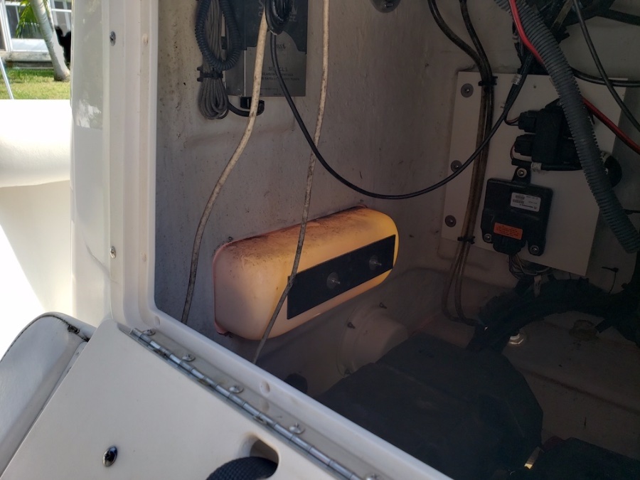

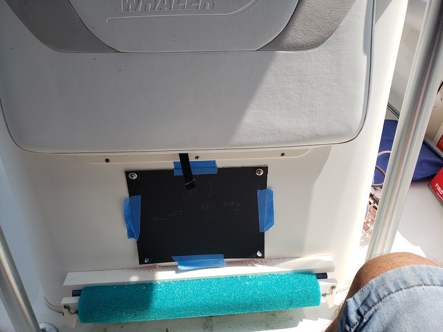

Today's update. Finished running the rear speaker wires and tidying up all the wires under the console.
I hooked up the 10" Kenwood sub again, just to play around. It was left in the open on a helm pad on the deck. I attached hooked it up to channel 5 (mono sub) on the JL and listened for a while. I was able to get very good bass once I pushed down on the sub to keep it rigid in place. So at least at the dock, I know I can get very nice, balanced sound from this combo - if the sub is rigidly mounted (to something).
I then attempted to place the sub in the console, where I had planned to install it. Unfortunately the Kenwood sub is too deep to fit in the location, on the inside of the footrest on my console. The magnet section of the sub is too tall and interferes with too much wiring, etc in that area. If I install a sub in that location, I'll need to find one that is shallower in depth or possible an 8" sub instead.
If I need switch to an 8" sub, I'm not sure I shouldn't just change two of the 6.5's in the back of the boat to 7.7's. Wondering if that would be an acceptable compromise which would allow me to eliminate the sub until I can figure something else out (location or size, etc).
Back to the drawing board for now.....

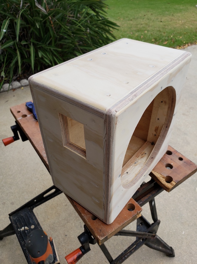

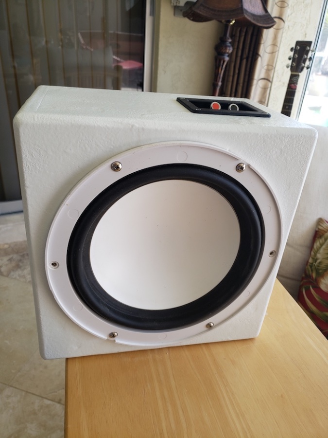

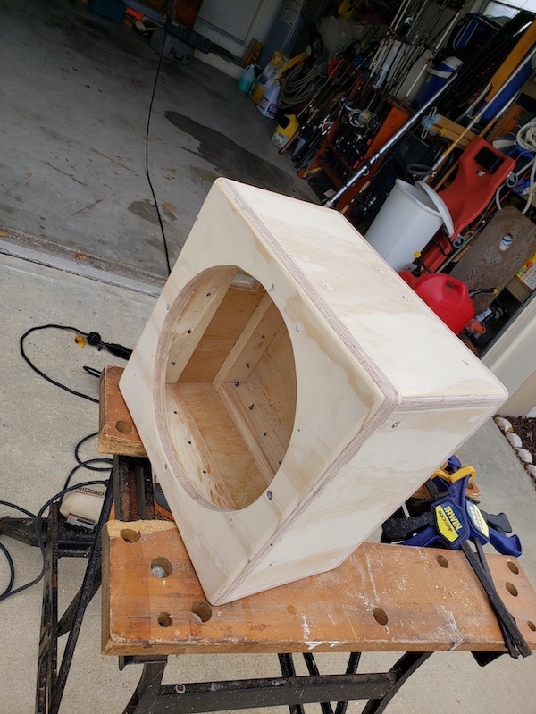

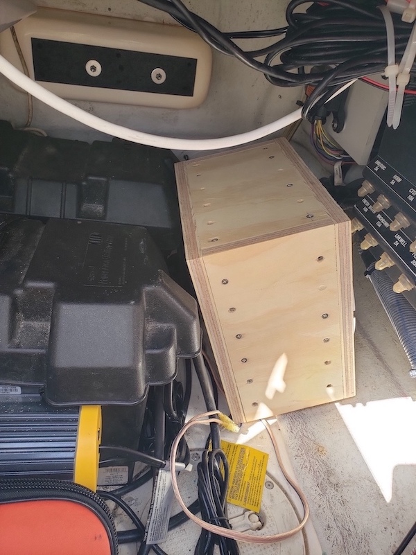

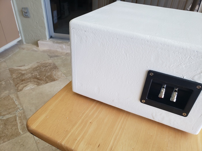

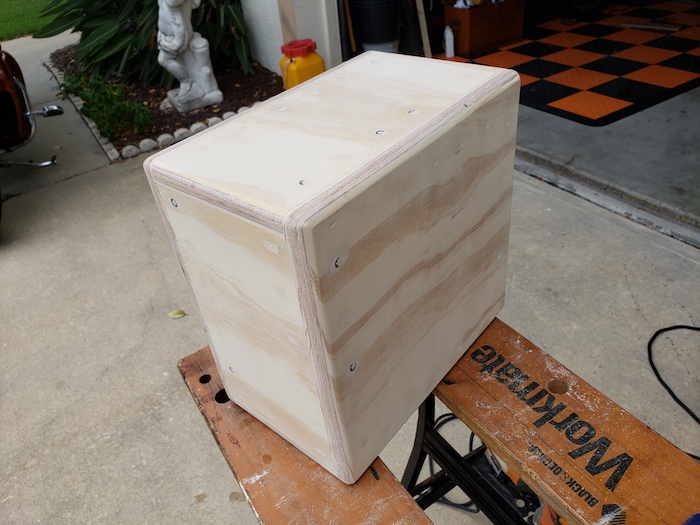

Today, I constructed a box for the Kenwood sub to experiment a bit.
The box was built out of 3/4" plywood. Dimensions were 12 x 12 x 7.5 (external). This did not provide a large volume for air space, but I deliberately made it a small as I could, which would allow the Kenwood to fit. As space is such a premium under the console, I thought this would be a good starting point.
I will take some pics of the box, but it's currently installed in the console. (see attached). The box is is not ported. I will say that the amount of bass from the Kenwood, driven by a 300 watt RMS amplifier channel is beyond my expectation.
I did not cut any holes in the console, bu there is a small horizontal gap where the footrest meets the deck. Space is about 1/4" x 27". The bass DOES find it's way out through here. In contrast to what I hear at the console and rear seats, the bass is much less apparent siting in the front of the boat (no spaces in the console on that side).
I need to tune the amp/sub a bit more as I have the low frequency filter a bit too high which is exaggerating the low/mid bass a bit too much. That (fortunately) is easy with the JL amp.
So I can honestly say that I am very happy with the results so far. I do still need to figure out how to mount the sub box, but I think this will make me happy for a while. Down the road, I might change out the Panasonic 6.5's - but I will say that for 10 year old speakers they really woke up with that new amplifier and I'll run them for a while (or until they blow out).
Jim, my sub is actually a 10", so it does go pretty low. By the way as an audiophile, I never understood a subwoofer's role to produce "sub-sonic" frequencies, although many may do that. In general a "subwoofer" is designed to re-produce "sub-bass" sounds to help off load the main loudspeaker's woofers at a certain cutoff.
Instead of a subwoofer - In the past,I have used tactile transducers for generating "subsonic" vibrations, which are felt - not heard.
Anyway, thanks for the kind words on the box design. I used about 1/2 pound of screws, so I don't think it will be vibrating or coming apart in the next 100 year. I will route the edges, epoxy seal it and then coat it with acrylic paint.
The challenge left is a good way to mount it, considering it will need to be on an slight angle as shown in the picture.

Finally had some time to work on the sub again.
Today, the box was belt sanded, routered with a radius, filled (wood putty) and re-sanded with a palm sander.
Then decided to try "Flex Seal" liquid rubber paint instead of epoxy & painting (my original plan).
Box could have been wood filled a bit more in a few spots, but I"m very happy with how it turned out - especially considering it will be pretty much hidden in the console.
I'm hoping the "rubberized" paint will hold up well and keep the box from absorbing moisture ("as seen on TV, --I laugh aloud--").
Next to decide exactly how I will secure this box to the deck. It will need to be angled back - but I don't want it to rest on the console. I have noticed the console flexes when underway in rough water, so need to prevent contact with the console itself.
