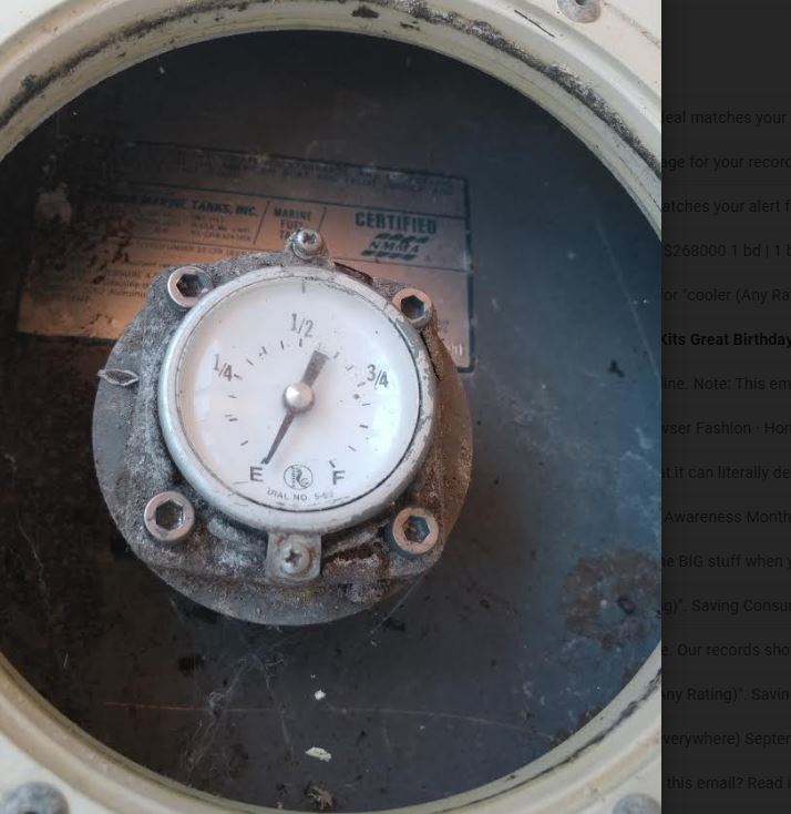

Fig, 1. Fuel tank level gauge.
Hi. I have a 22 Outrage and I noticed the other day, regardless of the fuel level, my fuel tank level gauge was reading Empty. I opened the access port, unscrewed and removed the sending unit and gauge. The tank is the original 77-gallon tank from Florida Marine Tanks.
Recommend a replacement that will work.
Thank you

Be sure the problems is not much simpler before you buy all new gear. The dial pointer is only coupled to the float sender magnetically. I have seen situations where the magnetic link uncoupled and the pointer goes to EMPTY.
Or, the float may no longer be buoyant, and just the float needs to be replaced.
If you need replacement parts, replace with the same float sender and gauge. See
http://continuouswave.com/whaler/refere ... #fuelGauge

Probably your float is no longer buoyant, I put a new float on mine and it works just fine. Mine has the arm attached to dial. Post a pic of yours. If the same its an easy fix if its just the float.
Aloha
25 Outrage 1982
Re: 1989 Outrage 22 Fuel Gauge Replacement
Postby biggiefl » Wed Sep 25, 2019 11:22 am
You can easily check the float when gauge is removed by moving the arm.
