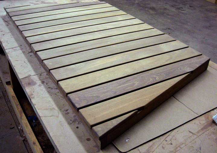

Here is a bow filler platform under construction from teak. This was taken under very bad fluorescent lighting, so the colorimetry is a bit off.
- Nautical Lumber Bow Filler Platform
- bowFillerPlatformUnderConstruction.jpg (46.81 KiB) Viewed 5030 times
