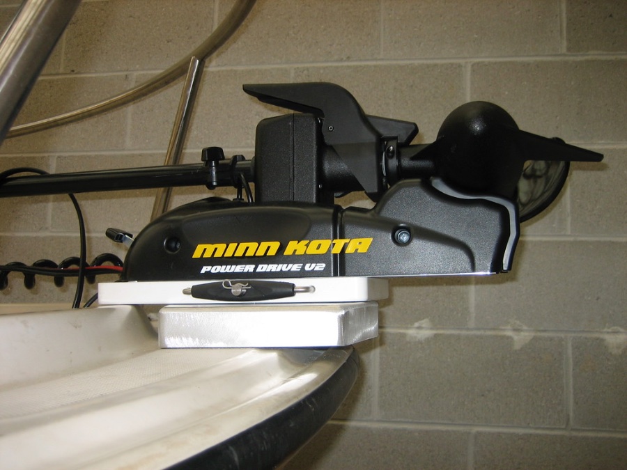

As for mounting. The typical install is use a thick block of laminated plastic board so the motor bracket will sit higher than the lip.
One would install the mount on the top of the bow cap so that you can thru-bolt in the two outside locations and use lags in the inboard locations.
See this thread with photos - http://continuouswave.com/ubb/Forum3/HTML/015489.html

I wonder: could the trolling motor could be tilted and pulled under the bow rail for stowage?
You could mount it straight forward and next to the anchor locker. Between anchor locker and the cleat on the front. When time to pull it in the boat, tilt it up first and then pull it into the boat. This will work unless it is a scissor mount. Next option would be remove the rail completely which is common on that boat. I have the low profile rails on mine and am glad. Low profile rails make fishing from the bow easier.
