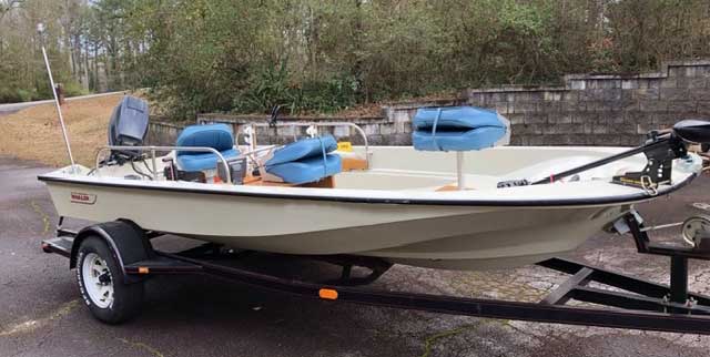

New to the Forum. I recently purchased a 1989 Sport 15 in unbelievable condition. The boat was in the same family for 30 years and kept indoors its entire life. The engine is a 1990 Evinrude 48-HP. A fuel tank was included.
Fig. 1. 1989 SPORT 15 with modifications to seating and bow-mounted trolling motor.
The previous owner modified the interior for fishing by removing the thwart seats and installing a couple of pedestal seats and a trolling motor. The owner had the two original thwart seats in the corner of his garage since 1997, and I got those, too. As all the mahogany is original and matches. I plan on removing all his modifications and returning the boat to its original form.
What is the best way to seal the screw holes in the floor (when the pedestal seats are removed) and in the bow lip (where the trolling motor mount is attached)?
I will appreciate your expertise and suggestions on how to restore.
My family had both 13-foot and 15-foot Whalers when I was growing up, so this boat brings back a lot of great memories. I can’t wait to get it back in original form.
