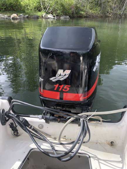

Fig. 2. View of transom and engine rigging.

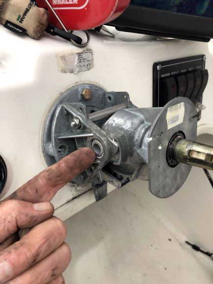

Fig. 3. The forefinger of the left hand points at a helm steering with tilt feature.

I presume that Figure 3 above shows the present helm on the 2003 160 VENTURA boat. That helm seems to project several inches from the dashboard.
On most hydraulic helm steering pumps the mounting is the same as the BAYSTAR; there is a vented filler cap on the top of the pump which needs to be accessible so that hydraulic fluid can be added. TELEFLEX makes an accessory that allows the filler to be extended if the helm pump is mounted so the filler is behind the dashboard bulkhead, but I don't think that will be workable in your situation due to the limited vertical space.
