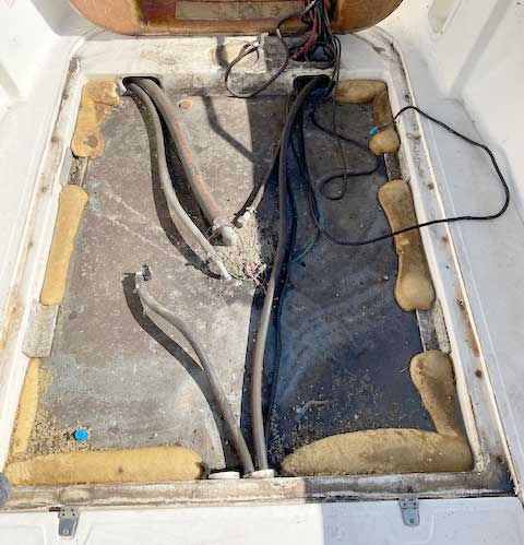

I pulled out the fuel tank and ordered another one from Vince at American Tanks in San Diego. The cost is $840 for the new tank and peace of mind. Also I am installing a new fuel line and filler hose. Thanks for all the advice and info. I do have one last question:

[Moderator's note: the original image was taken with a deep shadow on the right side of the image. I applied exposure compensation in order to make visible the details of the tank installation on the right side of the image--jimh.]

Wow--you work very fast.
Give readers more description of what you found when you inspected the fuel tank.
Was the tank made of aluminum or polyester?
In your image, the fuel hose connection area looks very corroded. Was that the situation?
What are all the fuel hoses for? Usually there are only three hoses: fuel filler, tank vent, fuel withdraw.
Also, the fuel withdraw point is often at the stern end of the tank. In your picture the fuel withdraw hose looks like it is at the same location as the fuel filler hose.

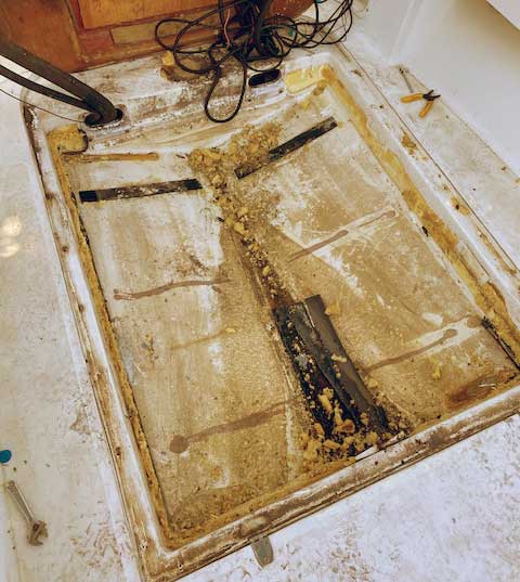

The process of removing the fuel tank from the hull was not too bad. I used flat-blade screwdriver pushed through the foam all around the tank. This took time but was not hard.
The OEM fuel tank depth is onLY 6-inches on the outside edges. The fuel tank has a v-bottom shape that matches the fuel tank cavity molded into the hull.
The fuel hoses that connect to the tank are a filleR hose, vent hose, and fuel withdrawal hose to the engine. The other two hoses that go to the stern of the boat [as seen in Figure 1] are for a sump pump and an on-deck live well.

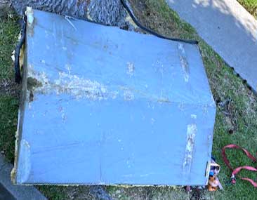

To lift the tank I used a small 1/4-Ton chain lift and a 2 x 6 plank, along with some tie down straps. To free the tank from the hull, I removed the fuel sender plate and used a hook to lift the tank. I put some upward pressure on the tank and inserted a crowbar at the sides of the tank. I wiggled the fuel tank a bit, and it pulled loose.

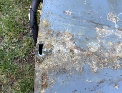

There was a hole in the fuel tank at the lowest point of the tank closest to the stern of the boat. I think the reason the fuel tank corroded was because the plug for the fuel cavity was left in during storage. There was sitting water under the tank after removal. At the primary spot of corrosion only a tap was needed to open a thumb-size hole.
