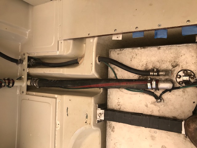

When I installed my replacement fuel tank on my 1980 Revenge 22. I had an elbow made out of aluminum for that bend also for the vent hose. I had them welded in the center of 1/4-inch flat bar to fit the cavity in the floor. That way I could seal the flat bar plate on the deck and prevent water on the deck from getting under the deck to the tank. The outcome was terrific and the elbows work as designed. Fuel fills normally.
You can easily go to any fabricator that welds aluminum and have them make an elbow from aluminum tubing. Use two, quality, stainless hose clamps on each side and you are good.

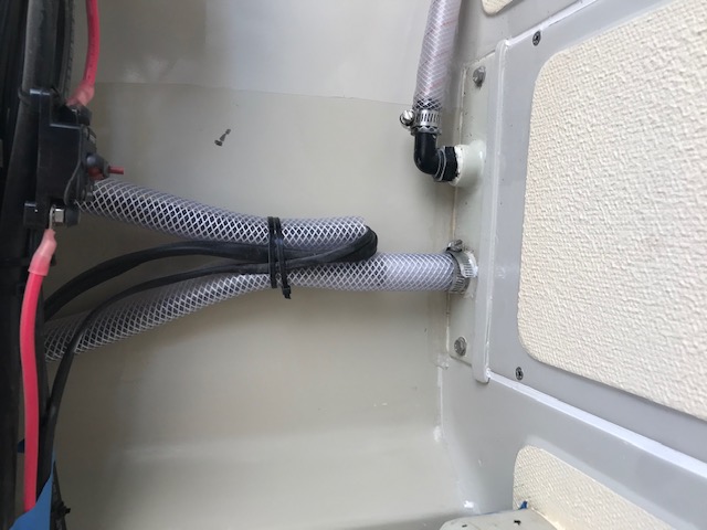

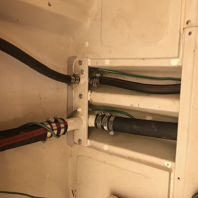

Below in Figures 1, 2, and 3 the fuel filler hose and fuel vent hose manifold that was fabricated are shown mounted in the boat.
The fit [on an OUTRAGE 22} for the vent line may be tight. You should be able to do something similar for the fuel filler hose without the base plate.
In Figure 3 the deck is shown for comparison to the factory appearance.
The hull behind the manifold base plate was strengthened with epoxy so the sealant to have something to grab and also to strengthen the hull. I also strengthened the hull with fiberglass and epoxy for the mounting screws.
Fig. 1. Close up view of manifold fabricated to create 90-degree bend in fuel filler and tank vent hoses.
Whaler Pic Fuel fill Manifold plumbed without cover.jpg (106.23 KiB) Viewed 7950 times
Fig. 2. Overall view of fuel tank filler hose and fuel tank vent house routing.
whaler pic fuel fill tank to top uncovered.jpg (71.8 KiB) Viewed 7945 times
Fig. 3. Deck reinstalled
Whaler painted port side fill pic after install-paint.jpg (46.01 KiB) Viewed 7950 times

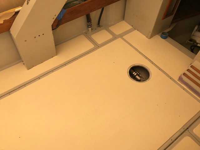

Below is a view of the starboard side as I described above. This is only necessary on Revenge models.
The bilge hose prevents water from getting under the deck and also acts as a vent to the sub floor/tank cavity. The supply hose in the picture originated at the transom, routes through a through-hull tube in the engine splash well into the rear fish box, takes a 90-degree turn there through a tube in the wall into the port side tunnel across the fuel tank up through this manifold and leads to a wash down pump I mounted out of the way behind the cabin support structure aft of the helm.
Whaler Pic Starboard Manifold finished-with wiring-Washdown supply.jpg (66.54 KiB) Viewed 7850 times
