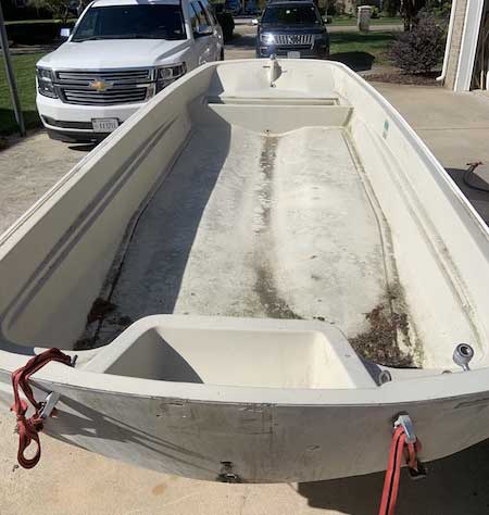

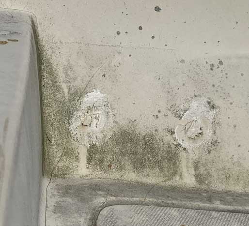

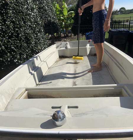

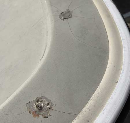

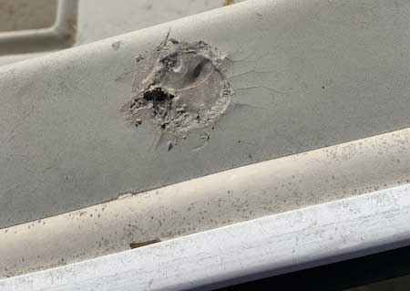

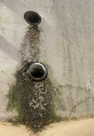

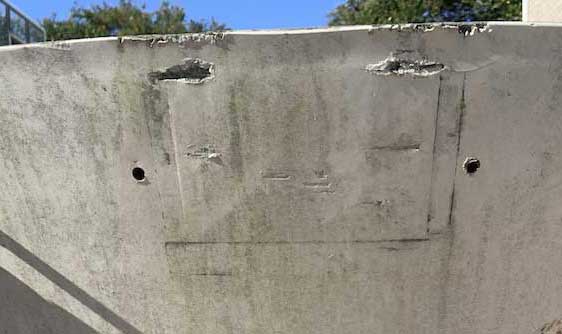

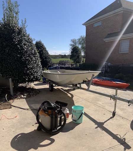

Do you see any damage that jumps out in the several illustrations below?
Fig. 1. My driveway
Fig. 2. My driveway and cars
Fig. 3. Dirt around drains
Fig. 4. Hull Damage
Fig. 5. Hull Damage
Fig. 6. Hull damage
Fig. 7. Hull Damage

Fig. 11. Hull Damage
Fig. 12. Hull Damage

Marlinmate wrote:Do you see any damage that jumps out in the several illustrations below?
Fig. 1. Your driveway looks like it is in good condition.
Fig. 2. That big GM SUV should have no problem towing the 13-footer.
Fig. 3. Some dirt around the drains; it should come off with some soap and water.
Fig. 4. Looks like a crack and there has been some leaking of brown goo from the hull. That needs to be fixed.
Fig 5, Fig. 6, and Fig. 7. Some repaired damage by prior owner. Fig. 7 looks rough and should be redone.
Fig. 8. Good to see a youngster working on the boat.
Fig. 9. Dirty transom with some superficial damage. See the FAQ for advice on standard engine mounting hole location and how to handle the lower engine mounting holes for a shallow spashwell.
Fig. 10. The federal Hull Identification Tag, attached with rivets. Get the number off the tag and decode according to the FAQ. That there is a tag means the boat is at least a 1972 or newer model.
Fig. 11 and Fig. 12. More shoddy repairs.
The hull needs a thorough scrubbing. First items to investigate are any damages below the waterline. Also check the engine splash well drains for proper sealing. See the FAQ for advice on replacement of drain tubes.
If there is not excessive gel coat stress cracking and crazing, the gel coat may be worth keeping. It can be restored to a nice shine with some work. If the gel coat is too far gone, you may have to paint the hull. Don't paint without first looking into the gel coat refurbishing. Gel coat can be brought back if it is not full of too many stress cracks or badly dried out and cracking everywhere.
