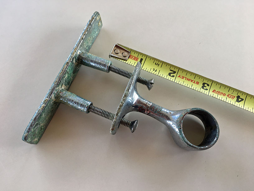

On my 1966 13-foot Boston Whaler Sport, the side rails went through what I call standoffs or stanchions, and the end of the tubing was drilled and secured with a horizontal screw into the hull. The standoffs were attached through the hull to backing plates with oval head machine screws, as pictured below.
Fig. 2. Side rail stanchion support from 13-Foot Whaler

Tom has it. His picture is what I have, less the machine screws.
How long are the screws?
The screws appear to be 3/16-inch diameter, based on trying other screws from my stash that fit into the backing plates.

The item pictured in Figure 2 is a railing stanchion support bracket.
Machine screws are not specified by their thread diameter in inches. The thread diameter is described by a gauge number, usually 2, 3, 4, 5, 6, 8, 10, or 12.

TOM--thanks for the very clear illustration (in Figure 2) of the method used by Boston Whaler to fasten the stanchion support bracket to the hull. I did not realize that the base of the support was through-bolted through the hull sides.

bobross wrote:How long are the screws?
In illustration Figure 2 (above) there is a ruler in view that is oriented parallel with the machine screws. I would expect that by careful observation of Figure 2 one could make a darn good estimate of the length of the machine screws shown in that illustration.

As to the screw length [shown in Figure 2], [the length] could be 1.5-inches (shown) or more, depending on how far the screws are turned into the backing plates.
[How far into the backing plates are the screws in Figure 2 threaded?]

bobross wrote:[How far into the backing plates are the screws in Figure 2 threaded?]
Since you have a 1977 SPORT 13, and I presume your interest in the length of the screws means your boat uses the same method of fastening the stanchion support to the hull sides, I recommend you measure the thickness of the hull of your boat at the location the backing plate will be installed, and then deduce the length of the screws.
Also, machine screws longer than 1-inch are generally not commonly available in small increments of length, so you may need to buy a machine screw that is slightly longer and cut it to length.
Also, a machine screw of 1.5-inch length will cost less than $1. I recommend you buy one and try it to discover if it works. Hardware like machine screws can usually be returned and a credit received, should purchase of a longer machine screw be needed.

My 1968 13-footer has [railing stanchion support brackets] with the through-bolt and backing plate arrangement shown in [Figure 2]. Mine are in the same condition.
