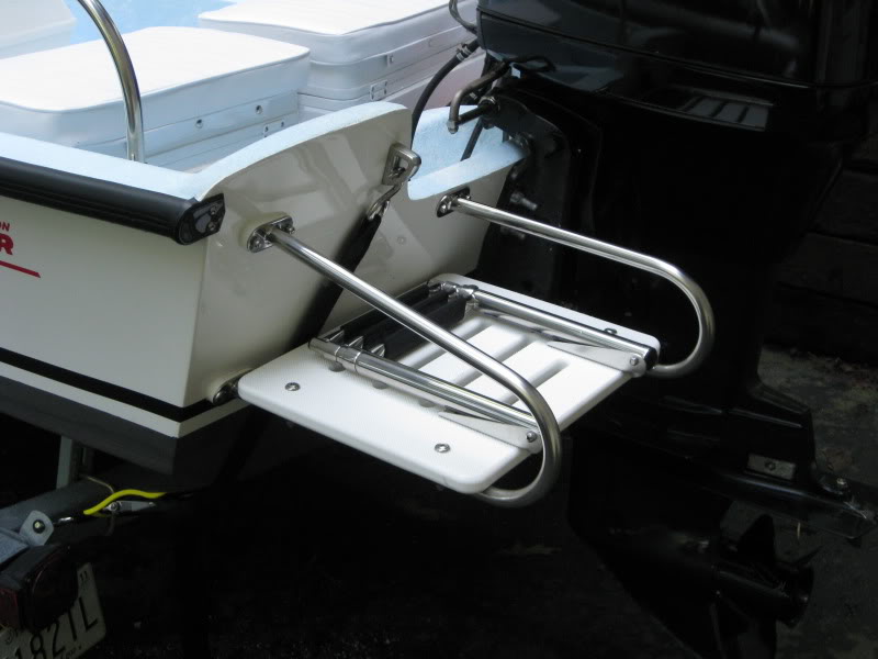

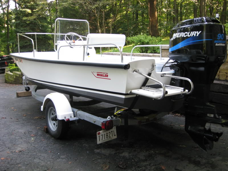

Ray Martin had the following photos available in 2009 when I was considering his product for my 1970 16-foot Whaler:
Martin Marine Design Swim Platform Photo 1
Martin Marine Design Swim Platform Photo 2
I ending up buying it and have been more than happy with that decision.

Tom,
Does it affect in any way the ride of the boat? Does it cause much spray while underway? I am assuming that there is no interference from turning the outboard, how about tying the boat to the trailer/
Thanks for your help,
Bob

Postby Tom Hemphill » Thu Mar 24, 2016 7:37 pm
Bob,
You asked...
rlboeri wrote:Does it affect in any way the ride of the boat? Does it cause much spray while underway? I am assuming that there is no interference from turning the outboard, how about tying the boat to the trailer?
The photos aren't of my boat, but my installation is identical (except on the starboard side). It does not affect the ride of the boat. There can be some spray when transitioning to on-plane, not otherwise. (That was one of my major concerns, and my concern was groundless.) The motor does not touch the platform. I use a gunwale strap trailering, not transom straps, so I can't speak to that question.

If I had a 17 Montauk, I'd be very tempted to install the Martin Marine platform and ladder set-up pictured in this thread. I think it's very slick. I had a similar set-up on our Revenge 25 W-T in teak. Worked out very well.
