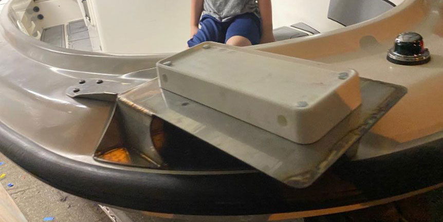

Fig. 1. I removed the starboard bow cleat. A friend fabricated a 316 stainless steel bracket , which attaches to the embedded phenolic reinforcement material using the same four bolt pattern as the cleat fasteners used. The mount also attaches to the closest bow rail base three-screw mounting points.
Note I had to remove the OEM bow railing, and I am now in the process of fabricating a new bow railing.

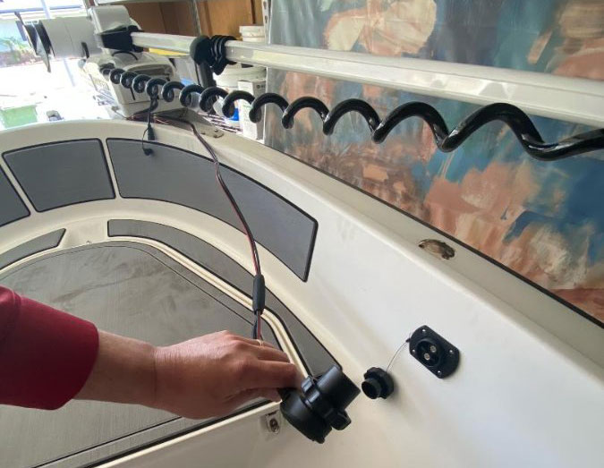

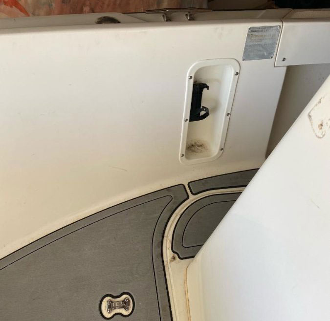

Fig. 2. For the wiring I ran AWG-6 wire under the console into the space behind the fire extinguisher mount. I then used a 54-inch-long flexible 3/4-inch drill bit designed to run wire in homes to drill as far toward the bow as possible to where the trolling motor is mounted.
Fig. 3. I used the Minn Kota plug and cut the proper size hole to meet the drill bit and was able to pull the wire and solder it together. I used AWG-6 wire because of the length of the conductors.
