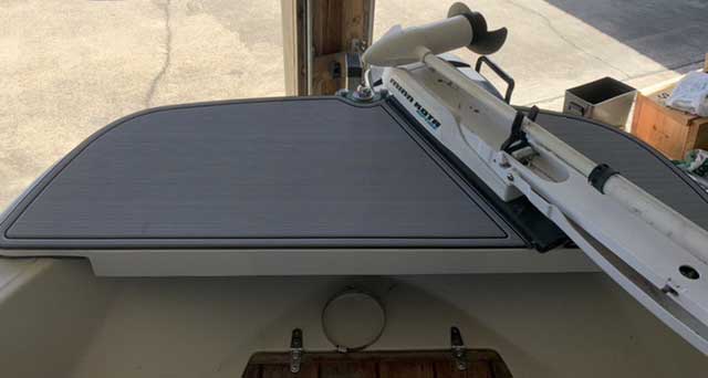

I built a casting deck for my 1985 Montauk 17. The casting deck is made from a composite board product from COOSA COMPOSITES, fiberglass, a deck surface product from SEADEK on top , and 3/8-inch-thick neoprene rubber on bottom to prevent any sliding around. No holes were drilled in the boat and [the casting deck] can be removed and reinstalled by one person in minutes. The casting deck doesn’t move, doesn't bounce, and doesn't slip in rough water
Fig. 1. I used T-nuts to secure a trolling motor bracket and to secure the deck to the boat. This allows everything to be flush.

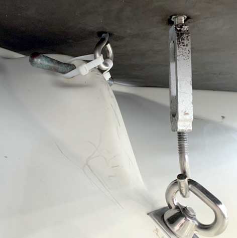

Fig. 2. A turnbuckle secures the deck to the bow lifting eye. I used an eyebolt to secure the deck with big zip ties to the Norman pin.

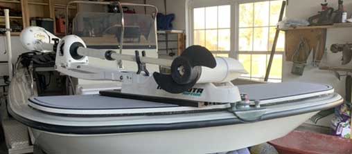

Fig. 3. A casting deck

Please elaborate on how the T-nuts are used to secure the bow casting deck to the hull.

Is the bow casting deck secure enough for the trolling motor thrust in all directions?
I infer that when going forward the turnbuckle link to the bow lift eye is providing the resistance to the thrust causing any motion to the bow casting deck.
What holds the bow casting deck in place if the trolling motor is making reverse thrust?
In Figure 3 the top surface of the bow casting deck appears to have some grooves in the SEADEK material. How did you create the unusual shapes and grooves in the SEADEK material?

T-Nuts are used for a through hole application to allow threaded screws to be used and no wrench to hold a nut while installing. For the trolling motor application the T-Nuts were installed underneath. It allows for the screws to pull down the bracket.
For the deck the T-nuts were installed on the topside. All holes were drilled in the Coosa board, fit checked, then T-nuts installed. The turnbuckle top bolt was cut to length to be all thread, so not to protrude above the deck. Same for the eyebolt.
The SEADEK was expensive but not required. Just a simple non skid would work. You would never see t-nuts with just the proper glass sand and paint.

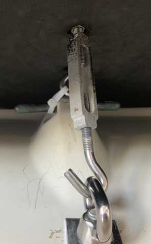

jimh wrote:I infer that when going forward the turnbuckle link to the bow lift eye is providing the resistance to the thrust causing any motion to the bow casting deck.
Figure 4 (below )shows an eyebolt strapped to the Norman Pin with large nylon cable ties. Nylon cable ties were just used for proof of concept, and I will see how long they last. If they deteriorate or fail I will use stainless steel [worm-gear] hose clamps

RFreed wrote:T-Nuts are used for a through hole application to allow threaded screws to be used and no wrench to hold a nut while installing...
Thanks for clarification of how you used T-Nuts to fasten the bow casting deck to the hull. In your initial description the method of using T-Nuts was not clear, and I couldn't imagine how they were embedded into the hull to fasten the deck to the hull.

jimh wrote:I am still curious about which of the many COOSA COMPOSITE products you used. Also the SEADEK products could use further details, particularly how those nice channels were created in the SEADEK material. And don't forget to give the source of the thick neoprene rubber you employed to increase friction between the boat deck and the new bow casting deck.
The COOSA board I used was a 10-lbs density.
The SEADEK was installed by a local company, Jet Boat Pilot. They scanned the deck and used a CNC machine to mill the SEADEK. They used two colors for a total thickness of 6-mils.

Thanks for the replies to my three questions. I was particularly interested in the SEADEK product, so your explanation of the scanning of the deck and the precision milling of the groove and the use of multiple layers of different color material was most helpful in understanding how the final appearance was obtained. It certainly looks very nice, and I expect it reflects the cost involved to create it.
