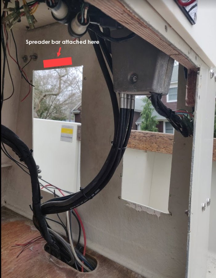

I am thinking of moving the batteries to the [SUPER CONSOLE on an OUTRAGE 22 boat] console. Give input.
BACK STORY: A piece of teak broke on my console in 2020.. Rather than just fixing it, I decided to re-do the entire console with all new teak, wiring, hardware, and switches. I also relocated things. Basically only thing staying is the base console, the hydraulic steering, and engine rigging. Some pictures: https://photos.app.goo.gl/Kk7h6DcucgE4QwLUA
I plan to repurpose the fire extinguisher hatch as a electrical switch compartment. I was thinking of moving the two fires extinguishers to the posts that support the helm seating, or them mounting horizontally under the gunwales. If you have made that re-positioning of the fire extinguishers, please reply.

One of the pictures in your gallery shows that the access hole in the deck through which engine rigging and other cables pass DOES NOT have the usual surrounding raised plastic shield or water dam to keep water from entering the rigging tunnel.
See: http://continuouswave.com/forum/download/file.php?id=6804
That is all being rebuilt with KING StarBoard.
